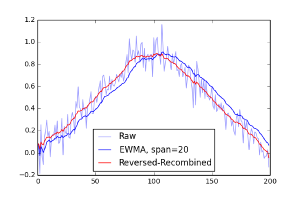

                    Did you try arduino smoothing ? ...
                    Click image for larger version Name:	image.png Views:	0 Size:	124.6 KB ID:	419037
                    What smoothing is that, an IIR low-pass filter?

                          That's indeed an IIR low-pass. It can be done using only bit shift operations and it's given me very good results.
                          If the noise is equal to or larger than 0.5 LSB then you get an increase in resolution too.
