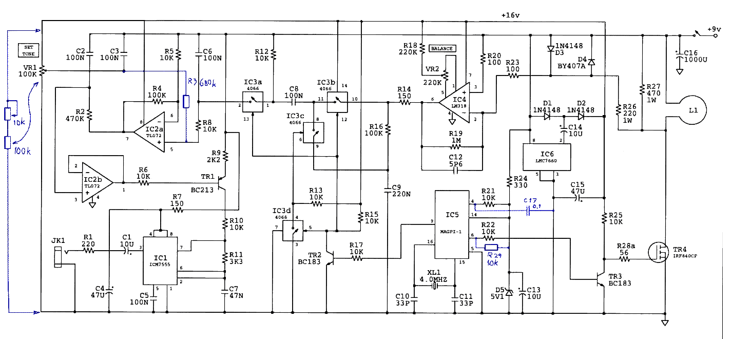

              Need circuit
              Hi all,
              i am looking for a scheet, pcb, schematic and the hex file from the stuart PI.
              Can anywhere help?
              greetings from germany
              Carsten
              [email protected]
                See http://www.thunting.com/cgi-bin/geot...e=projects.dat.
                  Thanks Carl!
                    MAGPI-1
                    Can anyone help where to find MAGPI-1?
                    Which one is good enough for the application and how to program it?
                    Or does anyone have it with the last hex code installed already, and send one to me?
                    Thanks in advance.

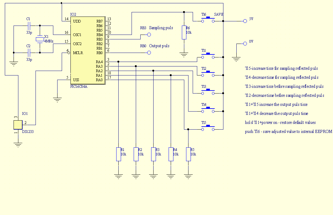

                      code for PIC 16F84A(PIC16C84) from Jaro(Slovakia)

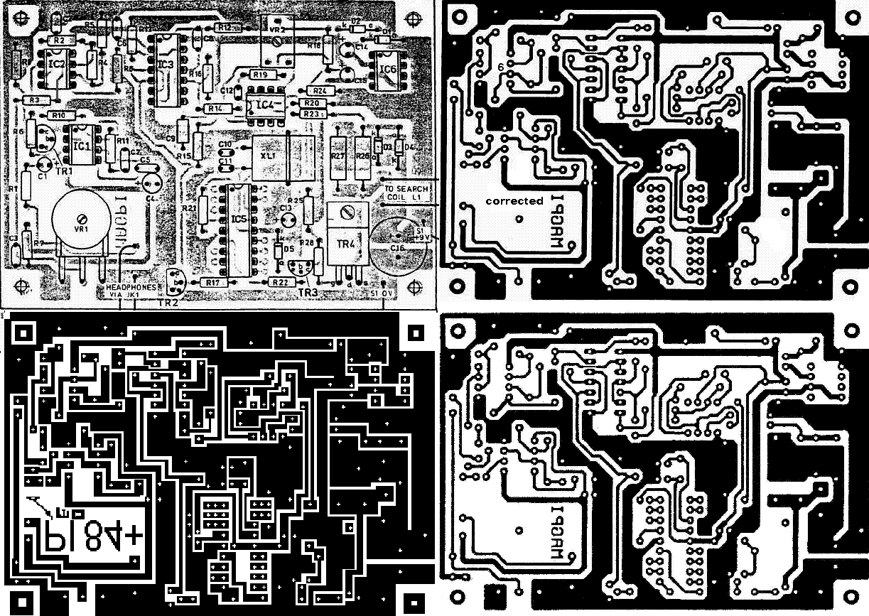

                              pcb layout picture
                              thank you for pcb layout.I just started to this project in turkey.İ am a university student.can i use above picture directly for printing pcb.For example should i give this picture pcb manufacturer directly or should i design own pcb layout in pcb program(pia etc..)
                              thank u.
                                I have made a PCB too, i didn´t know this one was here.
                                I have posted it on the forum, just make a search at "stuart"pcb´s.
                                I made this detector,but have problems with the pic that doesn´t send the pulse all the time, sometimes it just quit oscillating.
                                I have tried several codes,but only one is working.
