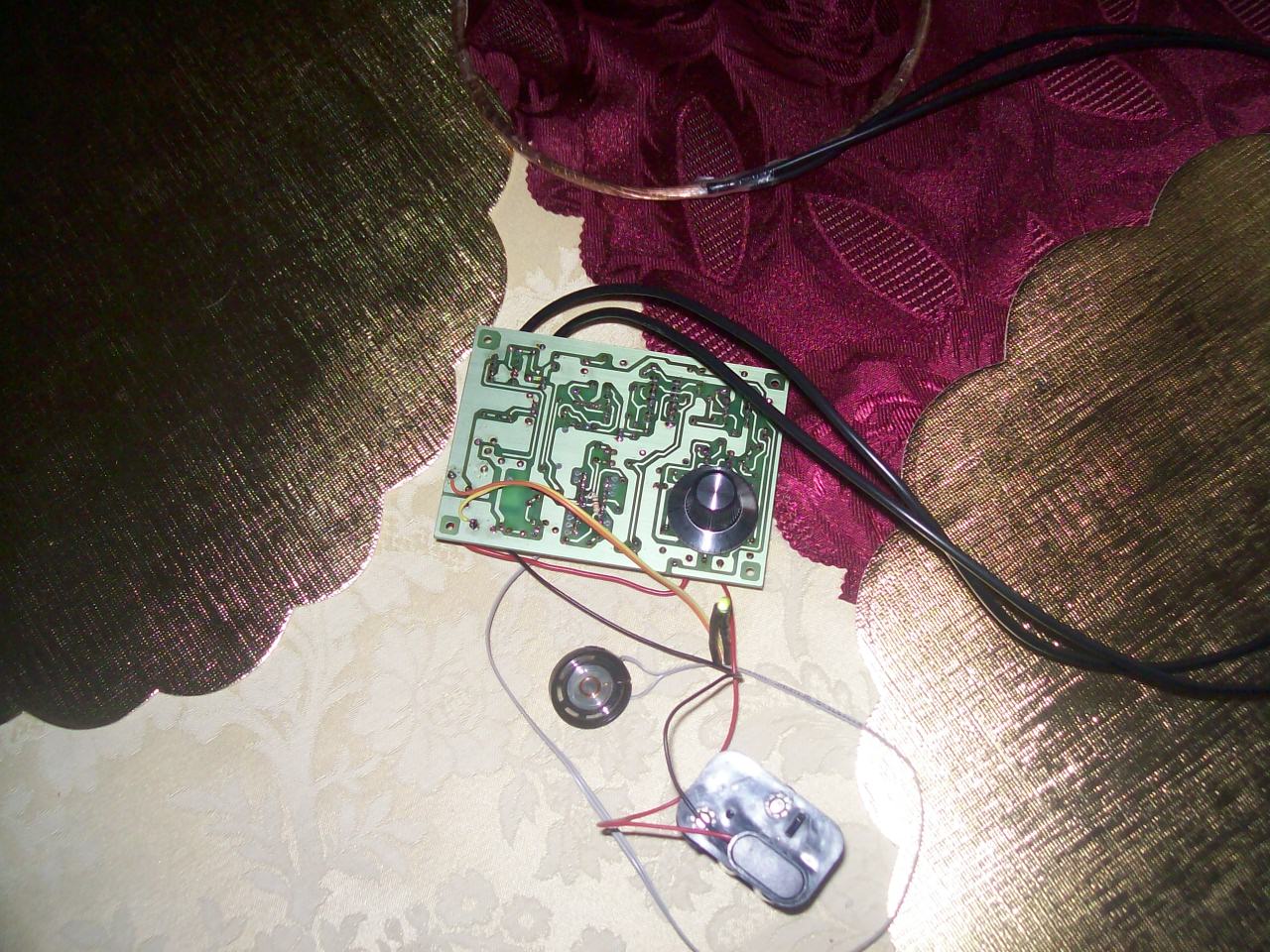

                Hi ,have built one of these before,an use a Pic micro 16F84A.It works well for a simple design.
                The Pic Micro was coded from Magenta Electronics Uk. Think they still do a service for a Micro coded with the correct Files for this project for around 5 British Pounds +Airmail to O/Seas. Please check with them?
                The French Pauls Files for the Stuart PI that are on the Net. wont work with this unit,Ive tried coding up several extra 16F84a Pic ,they fail to code properly an the Instruction sets are in French an seem prone to error.an there is No support provided from the french developer an web.
                Maybe others here may have done it successfully,but havent posted any clear result?else keeping for their own purpose!
                anyway here is my unit when built an tested,but not cased.
                the performance was acceptable,air test silver ring over 20cm easy,metal button almost similar.most small silver content coins over 10cm-15cm very easy.
                It ignores most Lead items,bullets etc,an lot of copper an brass items.an lot of foil like gum wrappers,cig.packet foils.
                But still steel bottlecaps,an pull tabs come thru,an small screws but not wire!
                Still a nice little project.Ive notice amongst the several variation of board design an components count an layout several errors.maybe deliberate or just poor Proofing of the boards an parts layout?
                If you can go by the last Magenta Electronics Kit design pcb,you wont have any dramas.If you can find this Last Corrected design,by them.
                I had it somewhere myself,got to find it?its was different to the common Net. designs.
                  Hi,just found the pcb copper side,actual from the Last revision of this board.If it Loads??upload Limits for windows bitmaps an jpegs?
                  Hope it helps someone.

                          The french assembly file, I have reassembled for the 16f84A, so far It was successfully programmed to the pic. I have not built the project, so do not know if the hex works.

                            Hi John,you have a copy of the new assembly an a Dump to try?Could load this to a new 16f84a I have an try on this unit of mine here,in favour of the Magenta Micro?Pm any info you want to share in exchange?if you feel its not public!

                              Hello Rov,I recompiled the pi84 asm with the 16f84a.inc with mplab.
                              This is the resulting Hex.
                              :100000005F28900B0128080005309300063092000D
                              :10001000920B0828930B062808000420910B0D284A
                              :1000200008002F0889002E088800831608158B13F6
                              :1000300055308900AA308900881488181D280811B5
                              :10004000831208002F0889008316081483120808F9
                              :10005000AE000800051A35280518970A8518970379
                              :100060000519960A851996034B280518950A8518CF
                              :1000700095034B281508AE000130AF00112016087B
                              :10008000AE000230AF0011201708AE000330AF0001
                              :1000900011204B20080004308C000000FF3091003C
                              :1000A0000D208C0B4D2808003E309500093096003D
                              :1000B000AE0011309700AE002830980087288316D4
                              :1000C000103086001F3085008312FF308600051A2D
                              :1000D00054280130AF0022202E0895000230AF00D6
                              :1000E00022202E0896000330AF0022202E08970011
                              :1000F0002830980087281508900006100120061463
                              :1001000008001708900086110120861508007B2042
                              :100110001608900001208120180891000D20051874
                              :100120002A2085182A2005192A2085192A20061A2E
                              :040130003A208728C2
                              :00000001FF
                              I programmed the chip with ICPROG ver 1.05A.hope it helps ..john
