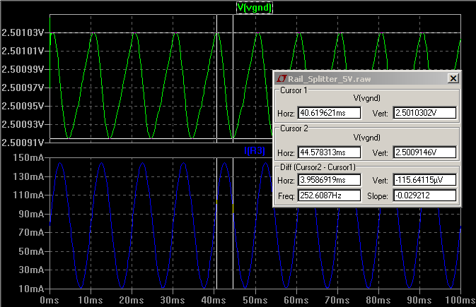

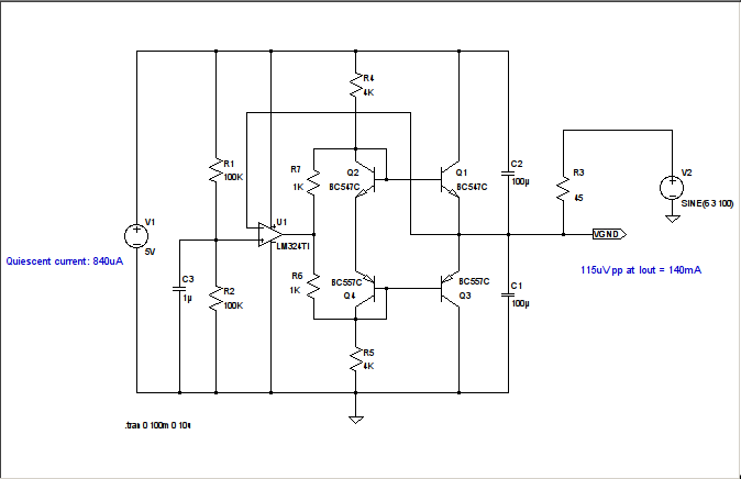

      • #78
        Originally posted by Old cart View Post
        Have you built this?
        No, it was just a quick and dirty simulation for the fun of it.
        In any case it's so simple it can be built on a breadboard in a few minutes with off-the-shelf parts.
        The following is a low voltage version for splitting a 5V source:

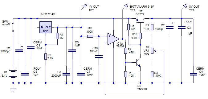

        • #79
          Another alternative is to just do a supply like was in the TDX3 project. This apparently works quite well in that detector. Note the battery in this case is about 12 volts. The battery alarm can be eliminated. You could also use 4 and 8 volt fixed regulators. There may have to be some modifications to the coil drive voltage as it is way above the highest amp rail voltage. this may be mitigated by the input clamping diodes.
Name:	TD3X power 8v 4v.jpg
          I do like the idea of a rail splitter though because it eliminates the need to have to think about non standard supply voltages. With the rail splitter there may be issues with the big discharge taking out the splitter itself. Does anyone have experience with this ?

              • #82
                Originally posted by Thomas View Post
                One of the things I like about the Teleno splitter is the tweakability, and no likely future unobtainium involved. But a 2426 could be thrown in, in place of the OPamp.
                Replacing the op amp by rail splitter TLE2426 removes the gain in the feedback loop which is necessary for regulation. As a result the ripple will be orders of magnitude worse.
                • #83
                  [ATTACH]34520[/ATTACH]
                  [ATTACH]34521[/ATTACH]
                  Have you tried making V2 a 100 Hz square wave?

                    • #85
                      Don't you guy's want to design a syncronized low noise positive DC to DC converter? Not a rail splitter? Based on the schematic in post 7. The preamp going to see a large input offset. Your signal is going to be to be centered at about 10v which is above your positive 4v rail. Most PI's use a DC to DC converter to solve this problem.
                      • #86
                        Altra, that is yet another possibility. Do you have suggestions for such a design? I have seen many designs used in metal detectors that are synchronized but none that I know of are particularly low noise. The only such designs that I found that are low noise are high frequency non sync'd.
                        • #87
                          Altra, we could solve the offset problem by AC coupling the input after the blocking diodes (don't know what impacts that might have) or use ground ( really +4 relative to the - side of the battery). I think I have this right. For some reason these supplies for PI really confuse me. I really like real plus and minus supplies as are traditionally done in electronics.
                          Any input on how to do this correctly are greatly appreciated.
                          • #88
                            You can look at the original surf pulse or GS4 / 5 schematics. Or without a DC to Dc converter see Dooley's TD3X project. The main thing
                            is your coil ground needs to be connected about halfway between your analog supply.
                            • #89
                              One of the thoughts that I have had for some time is to use higher voltage supplies for op amps to increase the dynamic range. For example if you used +/-10 volts then the 1st preamp would not saturate if it had a gain of 10 and used the traditional diode protected inputs. Without saturation the amplifier would recover quickly. We could do this with a charge pump like the LTC3260. This device has integrated low drop out linear regulars for low noise and operates at high frequencies for efficiency. The frequency is adjusted by a single resistor. I think we could then tap into the device clock, divide the frequency by 100 and use it to drive the transmitter and audio for a fully synchronized system. The adjustable frequency could be used to reduce the effects of external noise and still remain synchronized.
                              Any thoughts on whether this will work?
                              • #90
                                Without the dc to dc converter doesn't this then constrain you max coil voltage of about 1/2 battery voltage? Also the rail splitter has to absorb the big current pulses from the coil.
