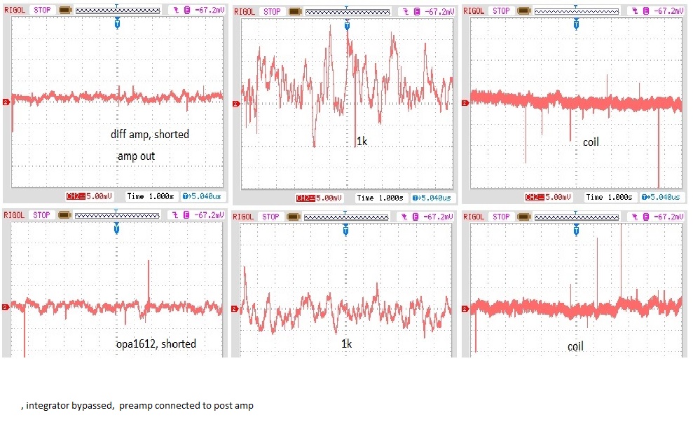

      Hi Chet
      Including a scope shot from another thread and a new one I made awhile back. Test_2, preamp connected to post amp(no integrator) OPA1612 1k resistor connected to +input or shorted, -input less than 200 ohms to common. Both tests the circuit was running with the Tx coil not connected. They show what I'm thinking. I think the diff amp is noisier than the opa1612 with 1k to ground on each input because of higher bias current. Integrator sampling increased noise. Working on a new circuit to try. Thinking of labeling the threshold pot in uv at the coil(should show noise level referenced to coil volts). Was surprised the coil noise wasn't higher, some high frequency noise but didn't increase low frequency amplitude, maybe it would with the integrator connected. The large spikes happen when the fet is turned on, need better PS isolation? IB coil, two 8 inch Rx coils side by side(one inverted for opposite phase) surrounded by a race track Tx coil.
      Don't think target time constant effects target band width, time for coil to pass target. Interested in how Teleno's amp is working with a mono coil.

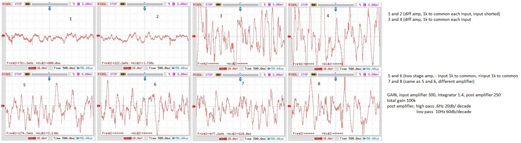

            I'm still missing why you give a noise level without referencing it to the input or include a gain.
            It's very simple, you asked about the resolution of and ADC that samples the output, therefore it's the noise at output what you must look at. The gain is inmaterial reagarding the resolution of the ADC.

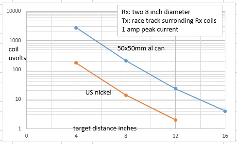

              I'm just trying to learn. Including a scope picture from reply#52 and a chart from reply #62. I think they define target shape and amplitude for sweeping a 300uH 8 inch diameter coil with 1 amp peak current over a US nickel. About 1 uv change at the coil with the target at 15 inches from the coil. I know the peak noise referenced to the coil has to be less than 1 uv(how much less?) You mentioned filtering reduced noise and reduced required bits. I still think the target defines resolution and noise level. It doesn't matter how many bits I have if the peak noise level referenced to the coil is 5 uv. If the noise level is zero I still need enough bits to define a 1 uv change with the defined target recording shape. Bits hardware + averaging?

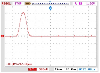

              • Hi Green
                The charts are a great help. And your chart of the coil sweeping over a nickel explains the 10 Hz response. Your two receiver coil arrangement appears to do a good job of eliminating common mode EMI.
                Does the frequency of the target eddy current slope inside of a 10 usec target sample gate need to be considered in later processing?

                    I will answer this backward. If there is zero noise then yes you would need a resolution on 1 uV or better to be able to see the small signal. Interestingly you are better off having some noise, particularly if you do signal averaging. This is because the noise sums with the signal and raises it above the minimum detectable limit. For example if you had a 1 uv with 1 uV p-p noise the combined signal would be varying from 0 to 2uV which would ensure an a to d with 2uv resolution would detect the signal, even if only occasionally. If you averaged the signal 2 times and the noise is not synchronized with the signal the noise would "melt away" and you would left with a signal of 1 uV and noise of about 0.6 uv. So by using averaging you can see a signal that is equal to and even below the noise. But it is the noise that allows you to digitize the signal in the first place. Classic averaging can only be used on signals that repeat. It would not be very useful on a low frequency signal like a coil passing over a target. Why? Becuase to average 8 times would require 8 identical passes over the target.
                    However there is a form of averaging called boxcar integration. Google it. It does not require a repetitive signal but does require closely spaced samples in time. It could be used to good effect in a metal detector to pull the signal from the noise. It not only increases the effective resolution, it has a secondary benefit of acting like a low pass filter.
                    How do you measure and define noise? You can measure it anywhere you want, it is arbitrary. As long as you define where and under what conditions you are good to go. I mentioned the signal and noise levels at the input to the a-d because that is all the converter sees. It neither knows, or cars, what is going on at the coil. Further if there are signal processing stages like gain, filtering, they will modify how much noise and signal is present. Gain stages general do not affect the signal to noise ratio, as long as they are quiet. Filtering can easily improve s/n as long as the signal and noise frequencies are different.
