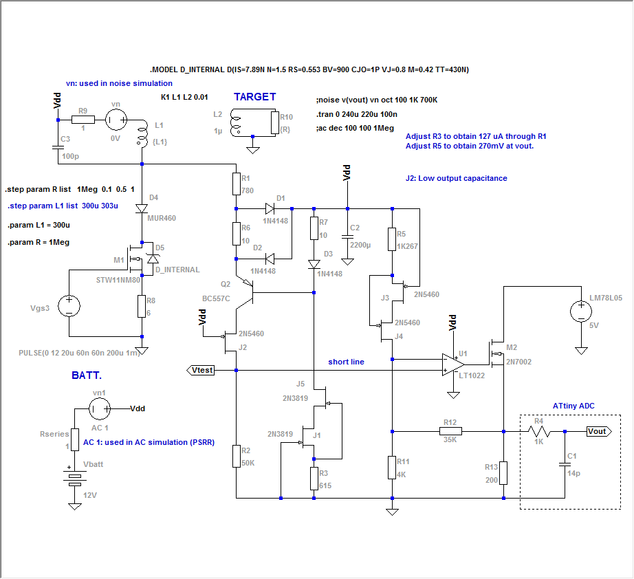

    I think current sourced/sinks J1/R13 ahd J2/R14 should be replaced by shunt bandgap references (LM337/LM317) to achieve maximum ripple rejection. Other ideas?
    The answer is no, the LM337/LM317 are not fast enough and slow the samoling down by 4usec.
    The current sources/sinks have to be fast, so RF JFETs are the only option.
    • Originally posted by Teleno View Post
      Did you answer your own question?

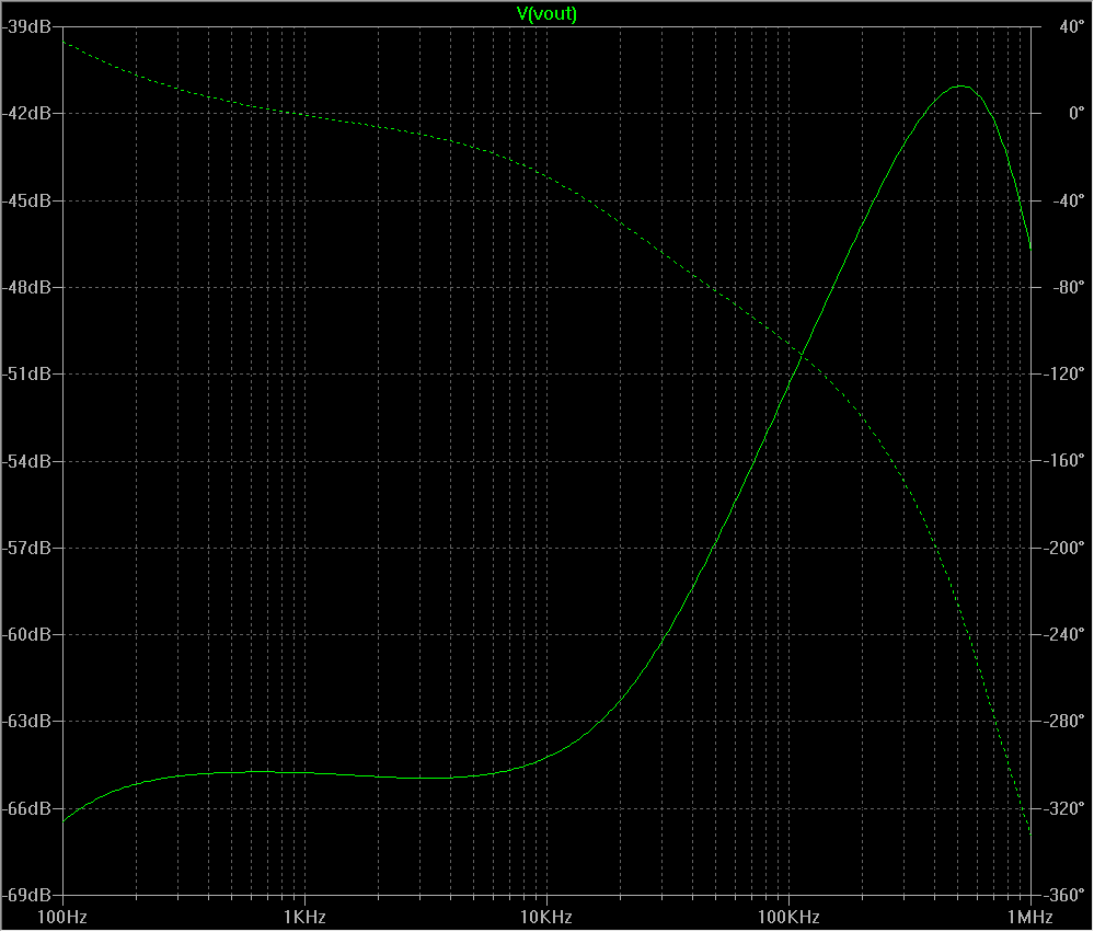

            • This version uses improved current sources for better PSRR at the two biasing nodes (Q2/D3 and R11/R12).
              The output can swing between 270mV and 5V.
              Gain: 480
              PSRR: -64 dB
              Sampling delay: 6 usec.
              Input referred noise level: 2.5 uV
              Output noise level: 1 mV
              Power Supply Rejection Ratio:
              • Looks nice with a reasonable number of parts for a discrete frontend. When you prototype this one I recommend building it on plain copper board. How fast is your 'scope, analog/digital?
                The only caveat I see on a quick glance is that there's no reference from the coil's cold end (VDD) after the first amp stage. Usually translating a signal from a reference to another is done by an instrumentation amplifier kind of circuit that takes a signal and a reference, and translates it to another signal with a separate reference.
                This is just a gut feeling but I imagine your PSRR stems mostly from having amplifiers referenced via current source and resistor combinations to both ends of the battery without a common signal ground.
                  The cold end is referenced via R1 and R6 to the "virtual ground" of Q2's emitter. This is a common base configuration with gain aaprox. R2/R1.
                  Certainly there's no common signal ground, but the PSRR is necessary whenever a fixed reference is required expecially if that reference is going to be amplified. Although C2 attenuates the supply swings coused by the Tx pulses, the slow recovery means the cap is still charging while the signal is being sampled. This supply ramp needs to be eliminated fro the output.
                  • Sorry, didn't state myself clearly; by cold end I mean the end where voltage swings are pretty small compared to the hot end that swings from battery voltage to flyback peak.
                    Be careful when touching the ramp, since the wanted signal is riding atop that ramp Most differential frontends use the coil cold end directly as a reference, which rids the signal of any capacitor charge ramp issues - until the reference changes, anyway. These reference changes are always a chance for some surprise pains, thus it's a good idea to reference one's A/D conversion to the same supply as the coil driver is. Microcontroller single ended ADCs can be nasty about it and their supply rejection generally goes down the drain when coupling their reference anywhere except the mcu's ground.
                      That's why I use the ramp as the reference, to separate the signal from the ramp.
                      The base of Q2 is referenced to the ramp, J2 with its gate attached directly to the ramp provides a steady collector voltage (rerefenced to the ramp) for Q2. Actually the 1st stage suppresses the ramp by -80 dB (at Vtest) and outputs a signal referenced to GND via a high output impedance cascode Q2/J2.
                      The second amplifier stage is referenced to GND. The MCU and its ADC are also referenced to GND. The offset bias for the OpAmp is isolated from the ramp by the current source J3/J4 which provides -80 dB suppression.
                      I believe everything has been though out and the amplifier is ready for breadboarding. Is anyone up to designing the PCB?
                      • Well, I was not much around here lately, so I couldn't interfere before. I fail to see any DC referencing mechanism. Are you going to set the DC bias by means of adjusting the source resistances for the given FETs, or am I missing the point?
                        It is not critical since EF sample is applied further on, so DC reference may float. But some general range must be set.
                        Same goes with PSRR obsession. Since you use ADC further on, and you use the very same power supply in a whole design, wouldn't it be more efficient to simply use voltage divider from the PSU as a voltage reference for ADC? High frequency components will only act as a kind of dithering anyway.
                          If you look at the top-right corner of the schematic you can see the instructions (in blue) to set the DC working points. They're set by adjusting the source resistances of the JFETS.
                          1. Adjust R3 to obtain 6V at point "Vtest".
                          2. Then adjust R5 to obtain the desired baseline at "Vout", something between 200 mV - 500 mV is fine.
                          U2 can be any fast JFET OpAmp. Rail-to-rail variants are not necessary because the inputs will vary around the mid-point of the power supply (6v) and MOSFET M2 provides the rail-to-rail output by subtracting its own threshold from the OpAmp's output.
