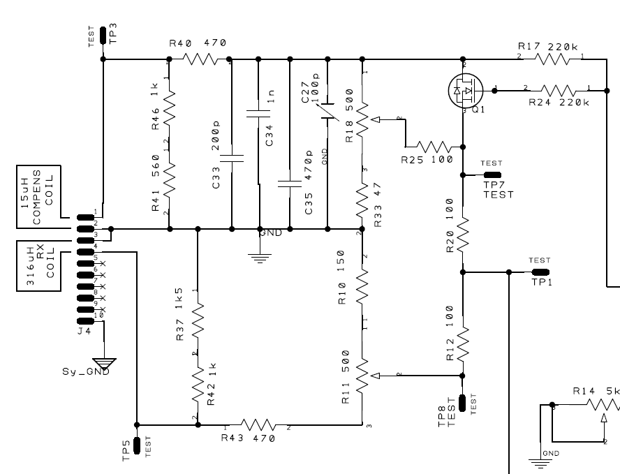

    The problem with induction balanced (IB) coils, is that a mechanical balance is easily achieved, however, any slightest movement during casting the coil or warping or even due to warming up in the sun upsets the balance to some degree.
    The electronic balance adjustment re-adjusts this post manufacturing imbalance.
    This is a circuit that matches or nulls any 2 coils.
    For example: Take a TX coil and a compensation coil. Different inductance, different size, even different location. The circuit matches the 2 signals, current, phase, amplitude, so that adding coil signal a to coil signal b of opposite phase, results in 0.
    Like: Take the signal from the RX coil, add it to the signal from a few turns of wire around the TX cable and we have a NULL.
    Any target upsets the NULL and generates a target signal.
    This circuit has been prototyped and field tried. It works. However, it can be improved a lot to reduce the noise and to simplify it.
      To correct post producing imbalance of DD coils can be done way more simple, than applying such a little excessive circuit.

                  That is an impressive circuit. Looks like a compensated voltage divider. The question I have is this. In a PI do we have to carefully balance out the TX signal or is it just fine to simply reduce the TX residual signal to the point where the first stage does not saturate?
                  In a more advanced detector I can see the value in a processor based auto calibrate feature that would compensate for nulls and maybe even adjust for different coil LCR.
                  In a simple design though maybe just getting the TX residual down to less than say 8 volts peak to peak divide by first stage gain ( 10 in this example) or 0.8 volts p-p would keep the first stage out of saturation and go along way towards allowing earlier sampling.
                      You are right, saturation is one of the critical problems. If you can not avoid saturation, use a fast opamp, something like AD8055, that comes out of saturation fast. However, since it's noise figure is not all that good, use a low noise opamp for the first stage and keep that stage unsaturated.
                      Years ago I posted a pseudo log pre-amp, with a transistor in the feedback loop. It did not saturate. I tested it with a gain of up to 3000, saturation free. Amazing sensitivity.
