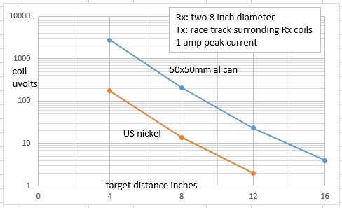

      I like coil vertical. Ran the TC for a 50x50mm al can, 10.7usec (will add to chart when I do some more targets), charted amplitude vs target distance for a US nickel and a 50x50mm al can. Integrator out volts*1million/300, preamp gain=300, integrator gain=1, sample delay 7usec, target sample 6usec.

        http://www.geotech1.com/forums/showt...935#post208935 (time constant chart)
        Thanks for the link and info.
        Interesting to see the influence of the skin effect on the can sample. The alu is a much better conductor than the nickel, but the TC ends up being nearly the same.

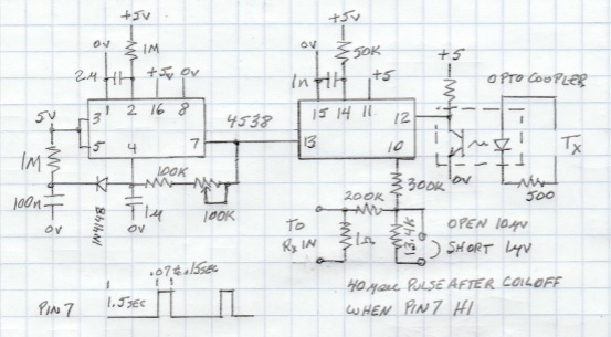

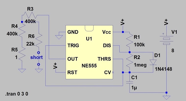

                Make a test signal to replace coil. Advantages: known signal amplitude, no EMI from coil pickup. Use a external 9 volt battery, connect preamp in across (R5) 1 ohm resistor, short for 1 micro volt signal, open for 10 micro volt signal. Depending on circuit might have to disconnect fet switch. Monitor post amp out with a scope for peak to peak volts. Connecting coil back up should give an indication of increase in noise from EMI, avalanche, etc. I'll give it a try, thinking about .15 seconds on and 1 to 2 seconds off.
                  I don't think that will work. With that small of a signal noise from the 555 will bleed into the input. To measure the preamp noise you could disable the transmitter and remove the coil then short with a resistor equal to the coil resistance. Of course you should also measure system noise with a coil attached and the transmitter running. This could be done with a small coil of the same inductance or a figure 8 coil. I suppose if one is dedicated you could make a small coil with matching LCR characteristics and then mount it inside a shielded enclosure ( faraday cage).
                  • #69
                    It didn't work. The target and EF samples are the same so they cancel, no signal. Have to try something different.
                    • #70
                      Yep, pulse rate is slow and unsychronized. Maybe better to just use a resistor. If it is preamp noise you are trying to measure you have to measure the noise after the preamp, not the integrator as it will reduce the noise itself.

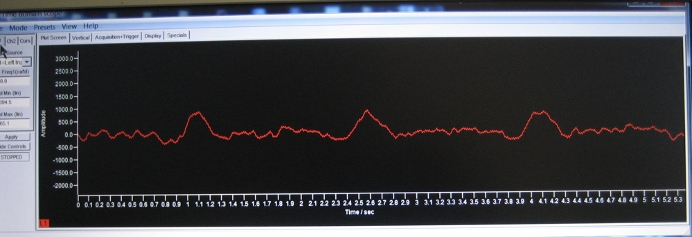

                            Target signal & noise
                            found a a picture from many years ago. This was made with the target swinging on a pendulum. It shows 3 passes of the target.
                            The target signal is about 2 times the amplitude of the noise.
                            In the noise we can easily see a specific frequency, but if we look closely we see many more frequencies.
