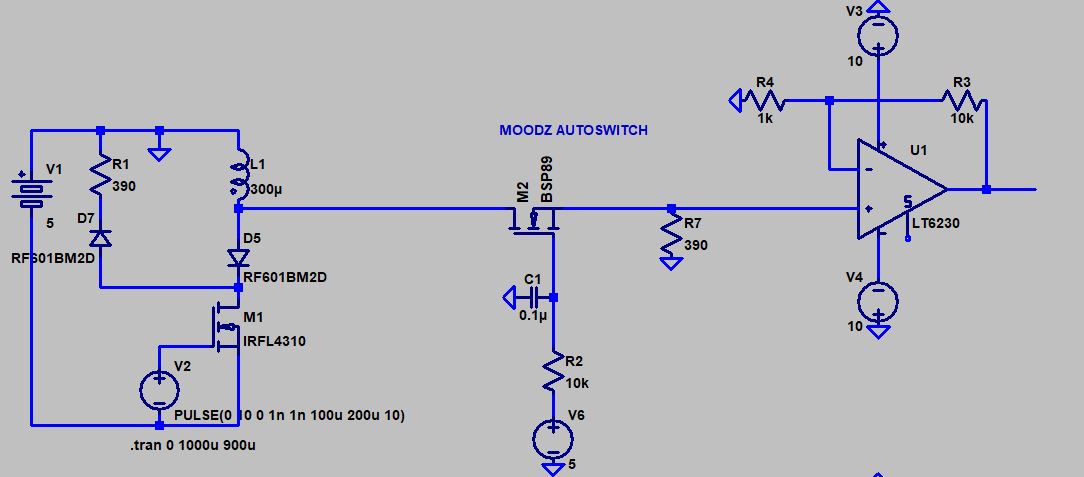

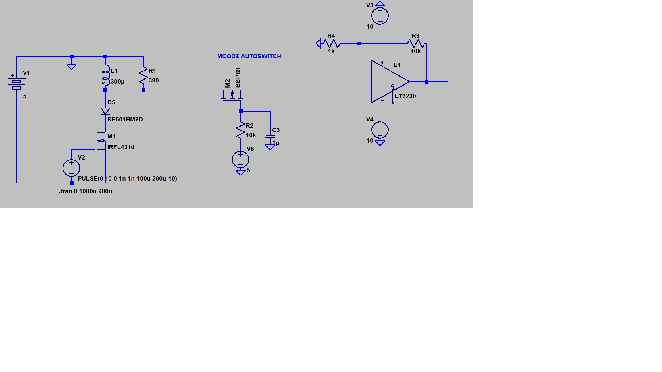

    I use the autoswitch mosfet in my simpler PI designs and it easily exceeds the performance of a diode switch. I can share the design below ...
    The resistor R2 and C3 form a simple filter to prevent noise from the gate bias V6 power supply leaking into the amplifier. For very simple PI circuits you only need the bias.
    Try to avoid opamps with internal protection diodes across the inputs. ( like NE5534 ).
    Obviously select the correct voltage rated MOSFET with low capacitance. Since current is minimal ..... speed, voltage and capacitance are more critical ...
    The high impedance at the source terminal of the fet pinches off the mosfet channel preventing high voltage at the drain reaching the amplifier input. The bias can be set so the mosfet is normally on ( no flyback ) but off during flyback. No control circuitry is required. If there is a chance that the body diode of the mosfet may go into conduction then you will need to add protection. However for most cases the circuit works as is ... used commercially ;-).

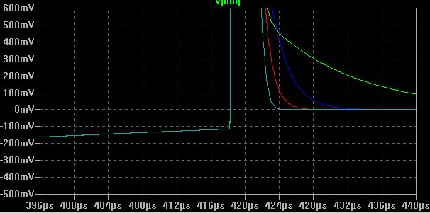

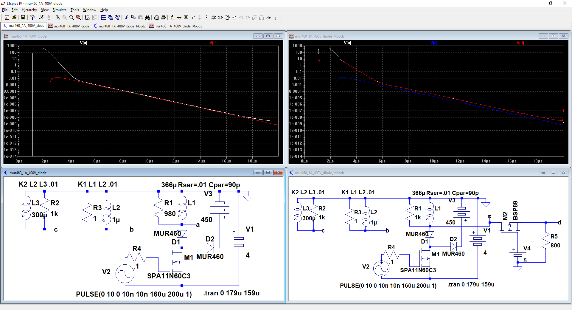

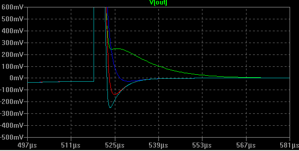

            I've replaced the diode switch with this and the signal got badly degraded.
            Diode switch:
            Mosfet autoswitch:
            I suspect the Cdg of the mosfet for the oscillations, so to test the hypothesis I placed a cap between the diode switch and ground and it caused a similar distortion. For the time being I'll stick to the diode trick.
              I tried the circuit. Looked good. A little slower. Didn't expect M2 to turn off.
                  Dumb statement, R5 current turns M2 off. BSP89 rated for 240V, what would a be good replacement for >450V?
                    STN1HNK60. .... Used this for the blocking MOSFET with good results. There's an 800 volt version too. K80
                      If we just revise the circuit to generate the "bias" off the output off the opamp then we end up with a workable solution that is simpler. ( works too LOL ;-) )
                      [ATTACH]45194[/ATTACH]
                      Dammit Moodz, you are a GENIUS!! I would never have thought of that )shows how much I know)!
                      Teleno, I see you used a CURRENT SOURCE to bias the diodes. I missed that one too (getting old and senile) but that is a workable solution too.

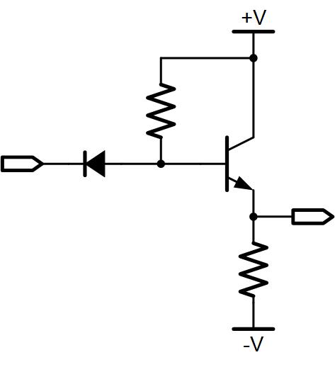

                              If critical elements needed to make the invention work have been omitted from the patent then that can be grounds for invalidating the patent via inequitable conduct. I don't see the problem though, the circuit is very simple and easy to bias correctly. Back in my old life of designing bipolar ADCs for Analog Devices we used a very similar circuit for the sample-and-hold. And, as Paul showed, practically the same exact circuit has been used in other applications. I suspect it would be a simple matter to invalidate the patent if anyone thought it was worth the cost of doing so. But it is also simple to maneuver around the patent by changing the second diode to an NPN. This also has the advantage of isolating the two bias currents.
