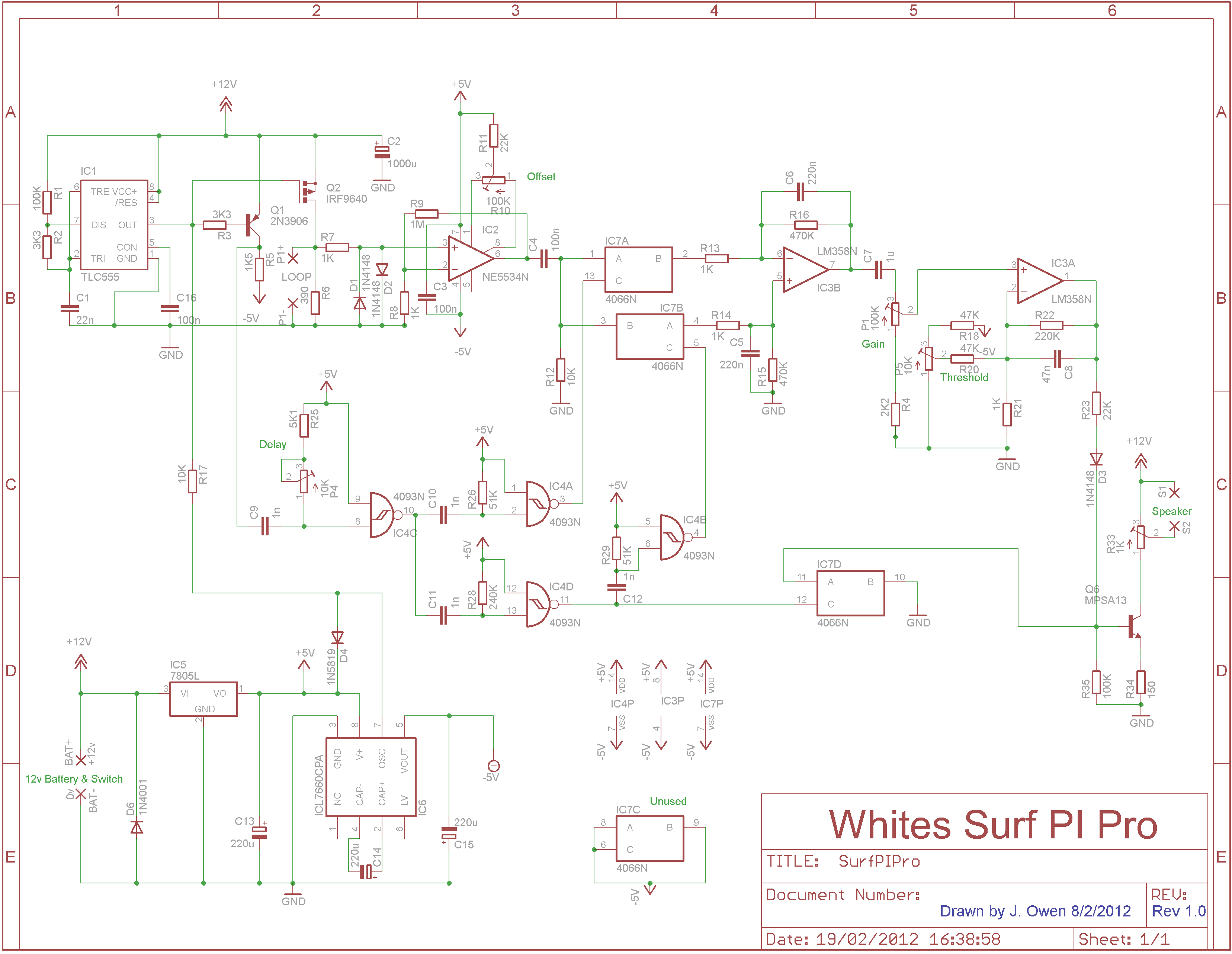

                    Hach, at first I thought you bought a White's Surfmaster PI Pro on eBay, but I see it's a PCB you then built. When things go right, this is an easy circuit to build. When things go wrong, an oscope is just about necessary to figure it out.
                    My questions were based on the possibility that the transmitter is either not working, or just barely working. A big piece of iron can produce a response whereas a coin or ring won't. If the transmitter is working, the damping resistor should be warm. Probably the FET, too.
                    If the transmitter "feels" like it's working, then the next likely culprit is the RX timing. That's where an oscope is essential.

                    R5 according to the schematic is RX timing when I Touch it with multimeter pin the coil start detect silver ring at 20cm so now I know where is the problem. Thanks alot Carl.
                    But what is the next Procedure? must I chang the R5 1k5?
                    Or what?

                        The Ebay seller help me1- R2 must configure correctly 2- recommend to use Litz wire for fast coil 13cm 26turn3- Joint between coax and coil must be soldered 4- coax must be low capacitance I have to confirm "surfmasterpro" Board working Perfect and Not trash layout pcbThanks guys for trying help me.Note for some Speech is silver, silence is golden.
                            R2 sets the frequency and TX width. If it's grossly wrong, it might cause the problems you see. But usually, R2 can tolerate a fair amount of error.
                            This design is not extremely high performance. Litz wire is probably a waste of money. Use magnet wire, or insulated stranded wire. 24awg or larger.
                            Yes.
                            As best you can, but again this is not a high performance design so any decent coax should work fine.

                                Originally posted by Hach View Post
                                My coil 13cm with 100turns wire size 0.6 with insulation
                                Try something like 26 turns. I think 100 turns would cause the first sample to be pegged to one of the power supply rails, this would explain the iron only response with only the second (late) sample working
                                I agree.
                                65mm Radius of 100 turns is about 2.8 mH. This detector needs about 300uH coil (Note: m = milli or 10e-3 & u = micro or 10e-6)
                                There is a good coil calculator at the top of the COIL sub-forum.
