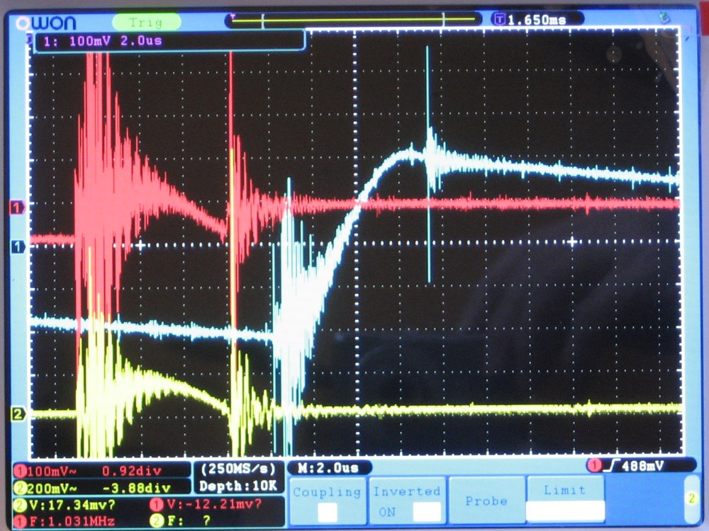

      The scope shows red trace 1 volt/div. Is the gate changing 3.2 volts or 32 volts? Does the - supply have the same negative over shoot as the gate signal?
        I don't remember just what I did at the time of the picture, so I have to reconstruct what I see on the picture. I know that I always use the probe on the 1:10 setting. I also know that the pulse of 3.2V must be from the MCU, that runs at 3.3V. This pulse is fed into a mosfet driver running at 12V.
        I guess I wanted to show how the oscillation migrated to the MCU PSU battery ground.

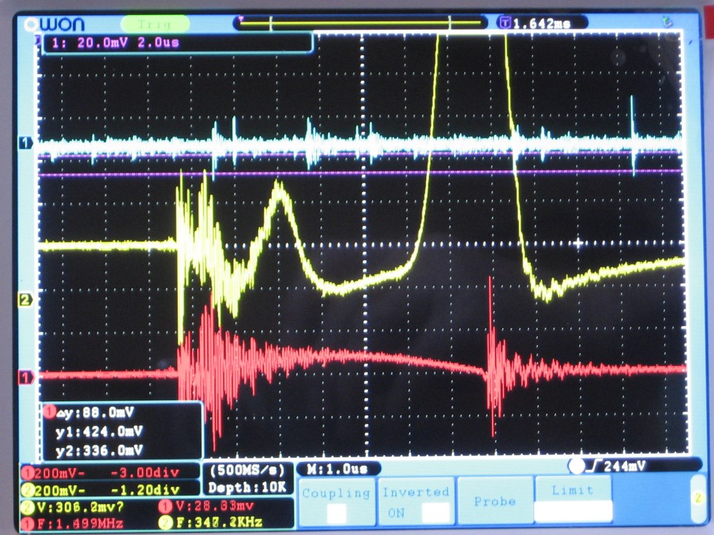

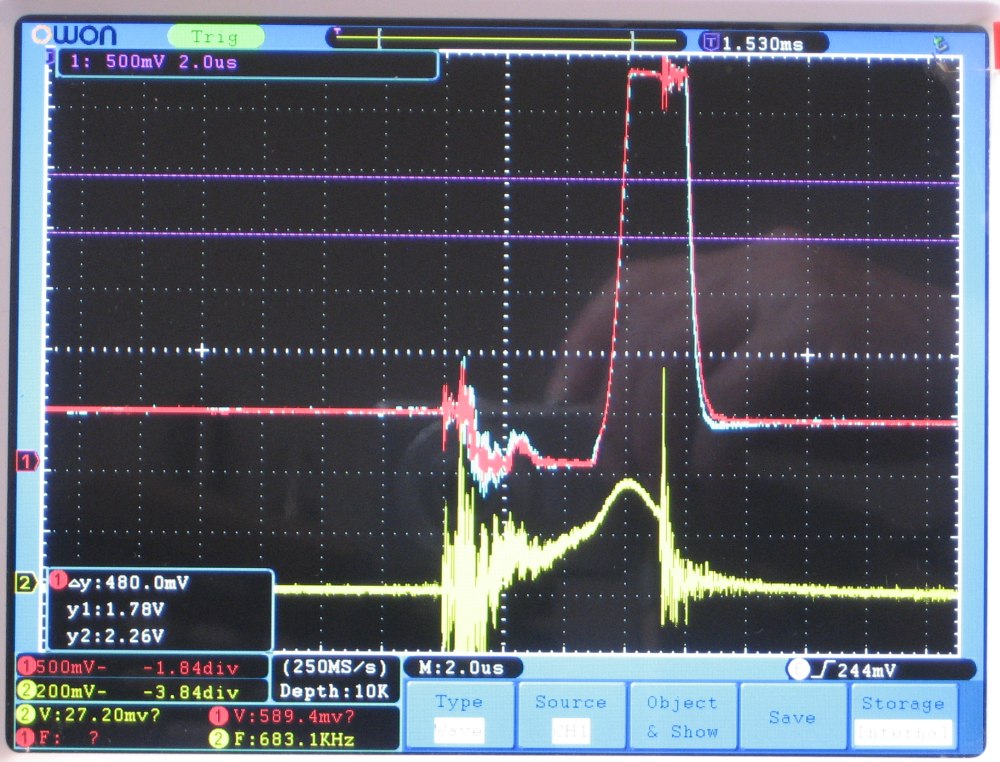

            Attached are 2 pictures showing noise.
            The "Noise" picture shows blue trace, at 20mV/div, shows the minimum noise with no power to the circuit, measured on the battery minus input.
            The red trace shows the feed-through of the noise on the same battery minus input at 200mV/div, with the circuit running.
            The yellow trace shows the effect of the noise on the output of the pre-amp.
            The IN_OUT& noise picture
            The red trace shows the OUTPUT of the pre-amp with a very short TC target after some 1MHz filtering.
            The blue trace shows the OUTPUT of the pre-amp without target.
            The yellow trace shows the noise at the RX INPUT.

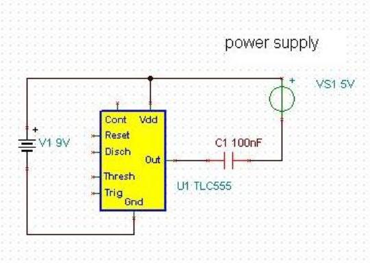

              Hi Tinkerer, Good example. I'm wondering if we can come up with a simple test circuit to drive the power supply, so we can compare results. Example circuit, 555 generating a 10khz square wave.

                  The attached picture shows the TX current step, blue, then the current step on the Capacitor bank,red, then the noise on the battery input lead, yellow. This is using the battery directly, no PSU.
                  The current pulse is 6Amps, measured across a 70mOhm resistor.
                  We see a voltage step of about 90mV on the capacitor, red, then no more voltage drop on the lead, after the filter, yellow, but still the switching noise.
