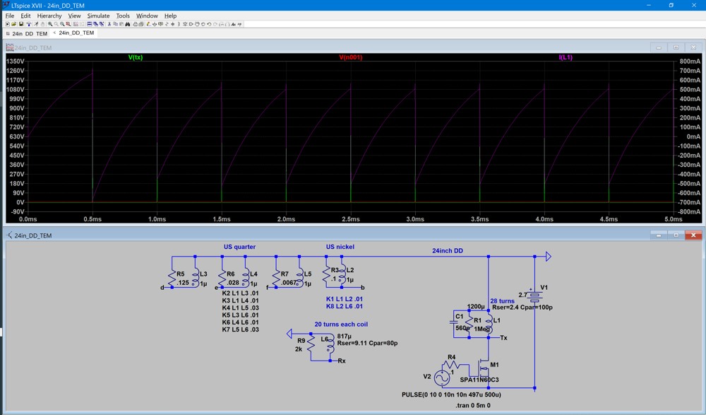

                  https://www.geotech1.com/forums/atta...9&d=1596044550
                  Right side circuit(TEM)isn't correct. Spice simulation doesn't avalanche MOSFET so coil decay is faster than should be.
                    Attached is the simulation with a few changes to make it fit the Mosfet, without avalanching.
                    With the desired design parameters, we could design it specifically.

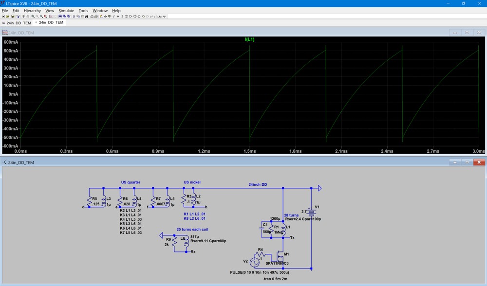

                      TEM TX CURRENT
                      This is what the TX current looks like. A deceptively simple saw-tooth wave.
                      In fact it is very complex. We will look at the complex details in days to come.

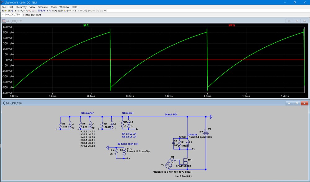

                        Do you think it's possible to get a bipolar TEM with a single coil? Since current is flowing through the whole TX cycle maybe that's not possible? What do you think?
                        • #42
                          How much bi-polar do you want it to be?
                          I added a Zero Amp line to the picture. Positive on top, negative below.
                          Not quite symmetric? Play with the parameters to make it symmetric.
                          However, You still need an RX coil and a way to reduce the TX pulse on the RX coil. There are several methods to do that. DD, concentric with bucking coil, passive compensating coil, Active controlled compensation coil, etc. You can also find several patents, some old and some more recent of how to do that.

                            Even if made symmetric it's still not bipolar. I'm just looking a way to eliminate EF cancellation.
                            • #44
                              HA HA, Maybe I should have said "arguably bi-polar"? If I look at one half cycle, I see a triangular wave from zero Amps to +500mA.
                              The second halve period goes from zero Amps to minus 500mA. Just like an AC wave goes. Is AC bi-polar?
