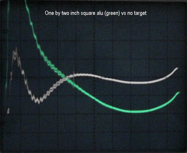

          TWO TAU METHOD
          Originally posted by Mechanic View Post
          Hi Tinkerer,
          Could you also post some pics that is showing what the tx coil is doing at the same time.
          Mick

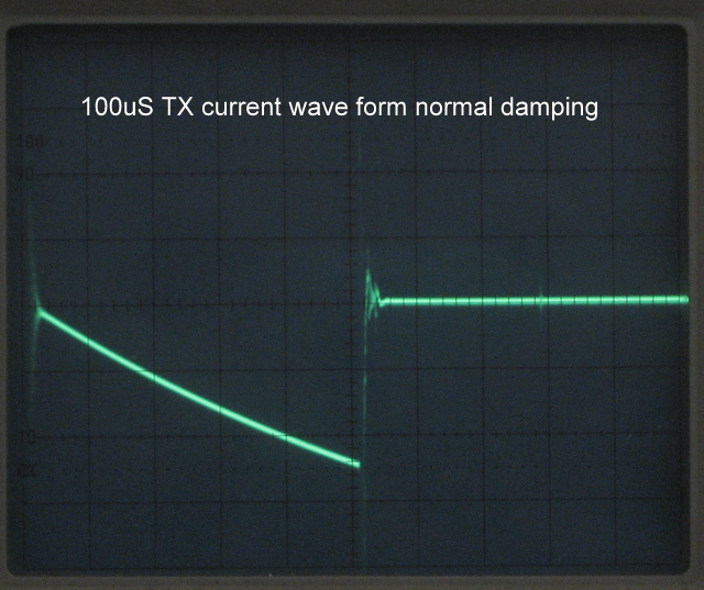

          Hi Mick,

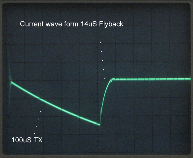

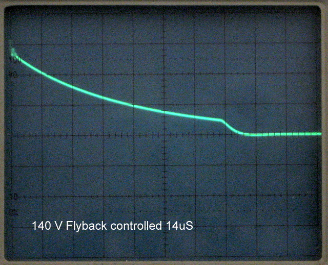

          attached are pictures of the controlled Flyback of the "TWO TAU METHOD" as well as pictures where the PIVOT is easy to see, made with the "TWO TAU METHOD"
          I am sorry to say that the pictures in post #1 are not made during Flyback, but during TX. Small mistake, but wide ranging results. So the cat is out of the bag.
          You see, the response during TX and the response during the Flyback, are the same. It is just that the response during the Flyback is many times higher.
          How many times?
          Take the energy of the TX, spread over say 100uS and then discharge the part that is stored in the coil and discharge it in 8uS and you have about 10 times more signal amplitude.
          The interesting part is that the signal itself behaves the same way., just concentrated into a shorter time.
          As mentioned elsewhere, there are many factors influencing the signal. Once we know them all, we can separate these responses and look at them individually.

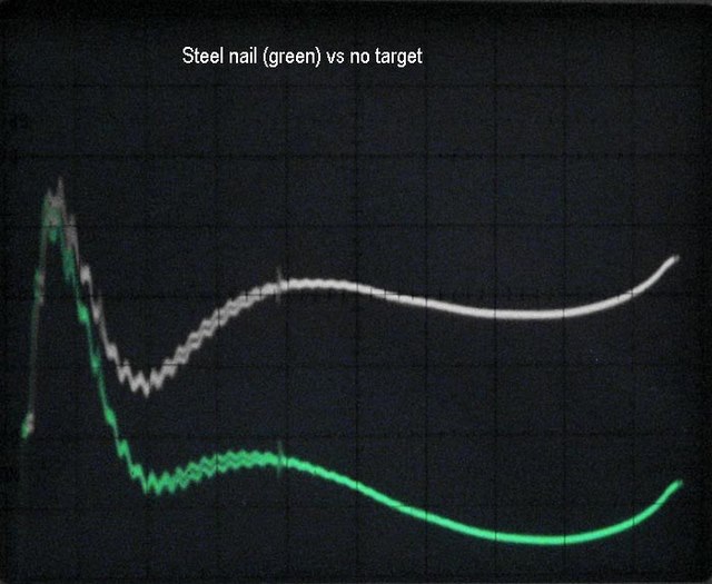

          I am not quite as far yet, but I know how to separate the ground response, the FE response and the non magnetic target response.
          To separate the responses, it is important to understand the interaction of the TC of the coil, the TC of the target and the duration in TC of the TX pulse.
          Now, with the "TWO TAU METHOD" we have the results of TWO TX pulses within one cycle. the responses are of the same kind but different amplitude as explained above.
          Tinkerer
            TWO TAU METHOD PICTURES
            The first set of pictures shows the voltage and current ramps of the TX and the Flyback.
            The second set shows target response.

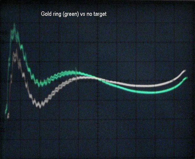

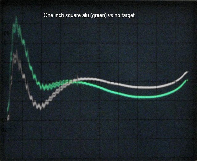

            The pictures showing the NO TARGET signal, superposed with a target signal, show the PIVOT well.
            The alu square targets are cut out of a thin houshold alu foil. the one inch square alu foil target has a TC of about 10uS when measured in the traditional PI way.
            The 2inch by 1 inch alu foil target has a TC of about 20uS when measured the traditional PI way.
            The gold ring is high carat gold, very thin and small.
            There are pictures of all these targets shown in other threads.

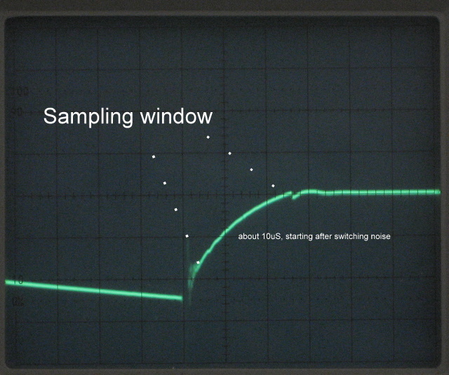

            The PIVOT is the point where the target signal crosses over the NO TARGET signal.
            Since the whole signal window has a time of only about 10uS, the TC of the target has to be translated to a relationship between TX ramp and the traditional target TC. The ramp is about 10 times shorter, so the target TC is about 10 times shorter too.
            The sampling window shows the signal from the switch off. The first spike is the switch off noise. Right after the noise the targets can be sampled.
            These pictures show a very noisy signal because of some loose wire in the coil, as well as the loose connections on the breadboard, where the wires were just stuck into the solderless breadboard.
            The fact that in spite of the primitive setup, impressive results can be shown, proves that the method has great potential of refinement.
            These pictures are quite old. Much improvement has been done since.
