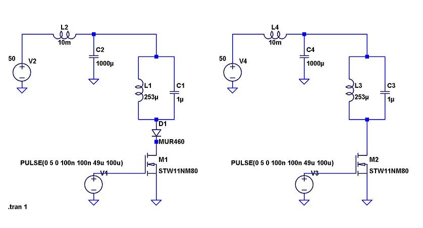

                        This is not the most efficient realisation of a target stimulation or power saving ... it is missing one component ( maybe deliberately ??? )
                        The circuit with the diode provides double the magnetic power and double the efficiency .. do the sims yourself or build real circuit. ( watch out ... circulating currents are so high in the coil that the capacitor gets hot )
                        The pulse repetition should be at the resonant frequency of the LC tank.
                        The duty cycle of the pulse will control peak current.

                          [ATTACH]17773[/ATTACH]
                          Oh yes, this one should even be better.
                          Good one! I'll run the sims..
                          Aziz
                            No! It's not better. A simple push-pull configuration on a LC tank achieves better results.
                            And I'm missing one important feature:
                            wide bandwidth response
                            Aziz
                              Many variables to the basic circuit are possible.
                              For example, try an IGBT instead of the Mosfet and see how different the wave form turns out. (Caution)
                              As for the diode. It increases the resistance and therefore reduces the efficiency.
                              The diode also isolates the drain capacitance of the Mosfet. What is the influence of the drain capacitance? Is this capacitance in series? and therefore reduces the tank capacitance?
                              What is the capacitance of the diode itself? The resistance? the voltage drop? the speed?
                              A lot of things to check.
                              Tinkerer
