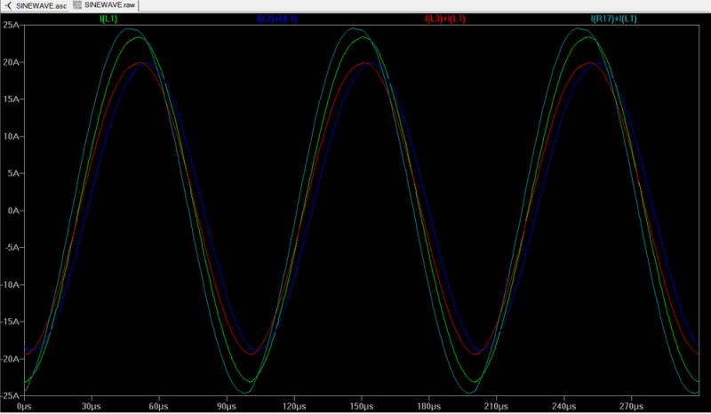

Here is the same simulation, but the target response is summed to the TX current (green trace) wave form.
Note the change in signal amplitude as well as the phase shift.
To test the effect of turn-on settling, I ran a 100us pulse width with and without R=15 ohms in series with the coil. Without the R the VCC was 10V and with the R it was cranked to 38V to give the same peak current. Ergo, in both cases I had a 100us pulse width and about 2A peak current, the only difference was the slope of the current: flat top vs saw tooth.
I got about what I expected, a 10-15% increase in preamp Vout deflection with the flat-top current, both with low and high conductance targets. This sounds good, until you realize that a 15% voltage increase is about a 2% depth increase. Ergo, in a std PI depth is not greatly affected by the di/dt just before turn-off.
- Carl

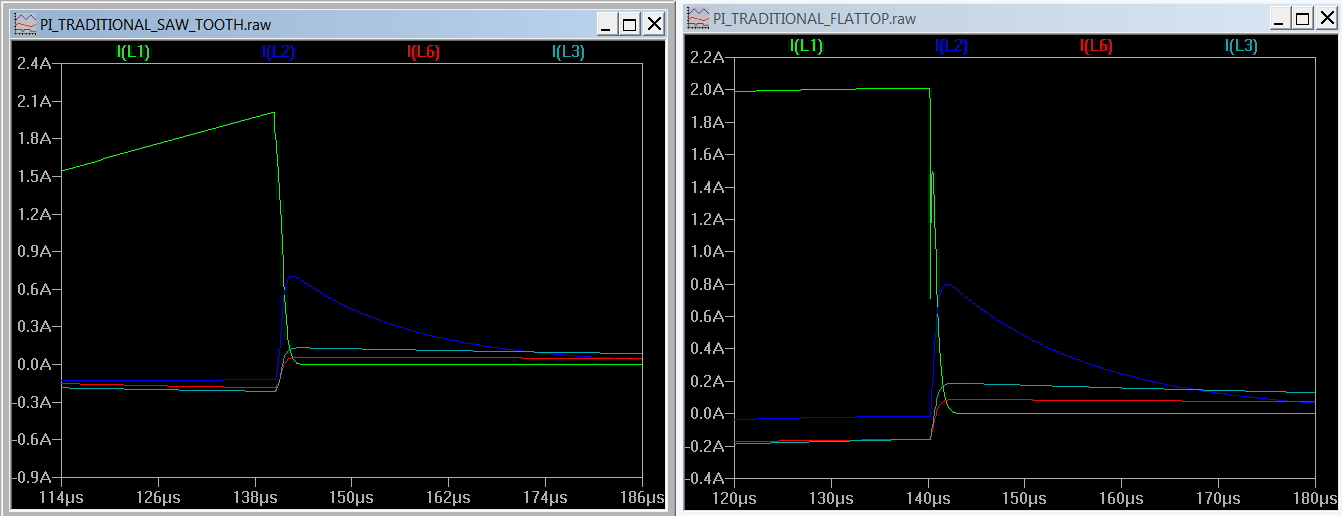

So I re-did the simulation more precisely to Carl's numbers.
100us TX for both, 300uH for both 15 Ohm and 31V for flattop and 600 mOhm and 7V for sawtooth. Same damping at 500 Ohm. 2A coil current.
I attached the zipped LTSpice simulation files so you all can help me find the error.
3 different targets with TC's of 15us, 100us and 200us.
The 15us target comes out close with 13% more response for the flattop.
The 100us target has 41% more response.
The 200us target has 46% more response.
Error in the Simulation?
I wonder.
Where is the error?
Tinkerer

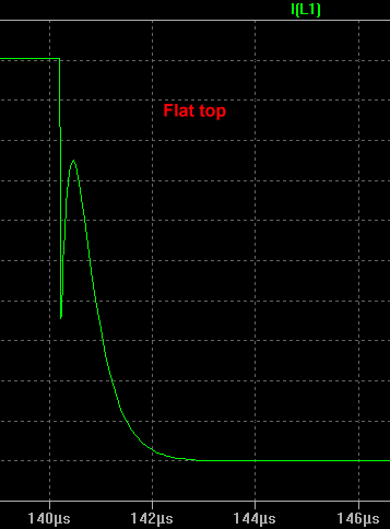

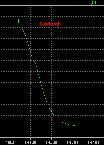

If you zoom in on the TX currents during discharge, you can see something went wrong in the sim -- there is an oscillation in the "flattop" case that is probably skewing your results. Didn't analyze any further as to why...

Thanks Simon,
the oscillation on the Flattop current wave form is due to the parasitic coil capacitance. This is a well known problem with traditional PI. This is the inter wire capacitance, the wire to shield capacitance and the cable capacitance. I have put it down as 200pf, but this is a very conservative figure. 500pf would not be exaggerated.
But why does it not appear on the saw-tooth? This seems to be something with the wire resistance that is not equal between the two sims, but I need to follow up on that.
Tinkerer
Edit on the above.
I just run it again, and it has now the same oscillation in both sims. The oscillation disappears when the Mosfet gate resistor is changed from 10R to 100R, or, in other words slowing down the switching a little bit.

It appears to be connected with the flyback voltage. Try plotting the coil voltage and coil current in different plot panes. You'll see that the kink in the current waveform follows the peak of the flyback. It might be a problem with the mosfet model, and that could be confirmed by replacing it with an ideal switch. Also, the mosfet model does not include the breakdown voltage. This can easily be fudged into the simulation by putting a large voltage zener diode in parallel with the mosfet.

How did that change your target response comparison?

OK, the fact of having R100 on the saw-tooth and R10 on the flattop, was a slip-up. Should be the same for comparison.
However, after correcting, the difference in signal response is insignificant.
To resume, for a short TC target, like TC=15us the result is similar to Carl's.
For longer TC's, the difference increases. This coincides with the opinion of many PI design aficionados and the theory of Eric Foster.
I am not happy with this result. Tests that I did in the past, were more in line with Carl's results.
So what is the cause of the difference?
