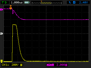

      Looks like Miller effect. Fast voltage changes on the drain capactively couple through to the gate turning it back on. Definitelty a real life effect I was getting it on my POS MD. I implemented the same solution.

        Agree, below is a real oscope plot (using my nifty new Rigol) of my test circuit, upper trace is the coil current. Glitch disappears when 100 ohms is added to the gate, which slows down the slew rate.
        - Carl
                - Carl
                The same thing happens in the simulation. Increasing the gate resistor to 100 ohms almost removes the glitch.
                        - Carl
                        The oscillation is due to the parasitic capacitance of the coil. ie. inter wire capacitance, coil to shield capacitance and cable capacitance.
                        I used 200pf parallel capacitance to the 300uH inductance to simulate this.
                        If you change the simulation for 500pf parallel capacitance, the glitch increases. If you change it to 20pf it disappears.

                          The linear ramp. Yes, the ramp is not linear and that is the most probable cause. I will make a different sim with a flatter ramp to see if this will show a difference.
                          The only thing changed on my sim, is the gate resistor to make the 2 sims equal.
                          Qiaozih's simulation is very different.

                                It seems you've found the cause of the glitches.
                                I modified the simulation (with the ideal switches) by removing the 200pF parallel cap across the coil(s). The glitches have vanished. However, they were still there (slightly) when reduced to 20pF.
