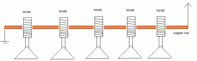

                            • It just hit me
                              Using a thick metal ring, copper or aluminum, and a ferrite-current pliers-like-transformer, just like in the above example, you could forget about the capacity problem in PI coils forever. Such contraption would act as a coil of the ring diameter, but with number of turns equivalent to the number of turns on a ferrite thingy. In case of aluminum it could be self supported as well, and as a bonus you'll be able to forget about shielding alltogether.
                              Did I earn a lollipop or what?
                              A step forward... I could have a pair of separated search rings (with no IB overlapping) and supply them with in phase for Tx and counter phase for Rx balance. Using aluminum rings it could make a very lightweight construction, with 100% metal used for both Tx and Rx, and in perfect balance as well.
                              As Aziz said before, patent hogs beware! This idea is NOT for commercial use.
