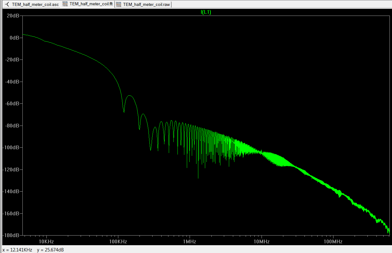

                        • Attached is the FFT of the switch OFF transient. This is the target stimulation, sampled after switch off.
                          What does it tell us?
                          Tinkerer

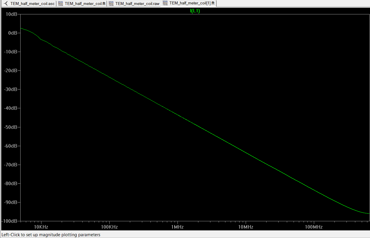

                          • Below is the FFT of the full cycle TX
                            Tinkerer

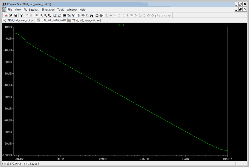

                            • And here is the FFT of the TX ON time.
                              All these are simulations. The real TX pulses have quite a bit of Mosfet switching noise, specially when high Amps are switched.
                              Tinkerer

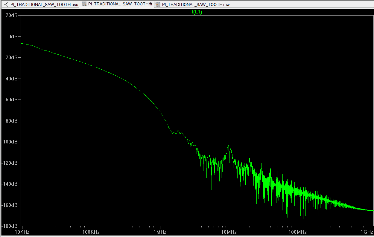

                              • And here is the PI TRADITIONAL Full TX cycle FFT
