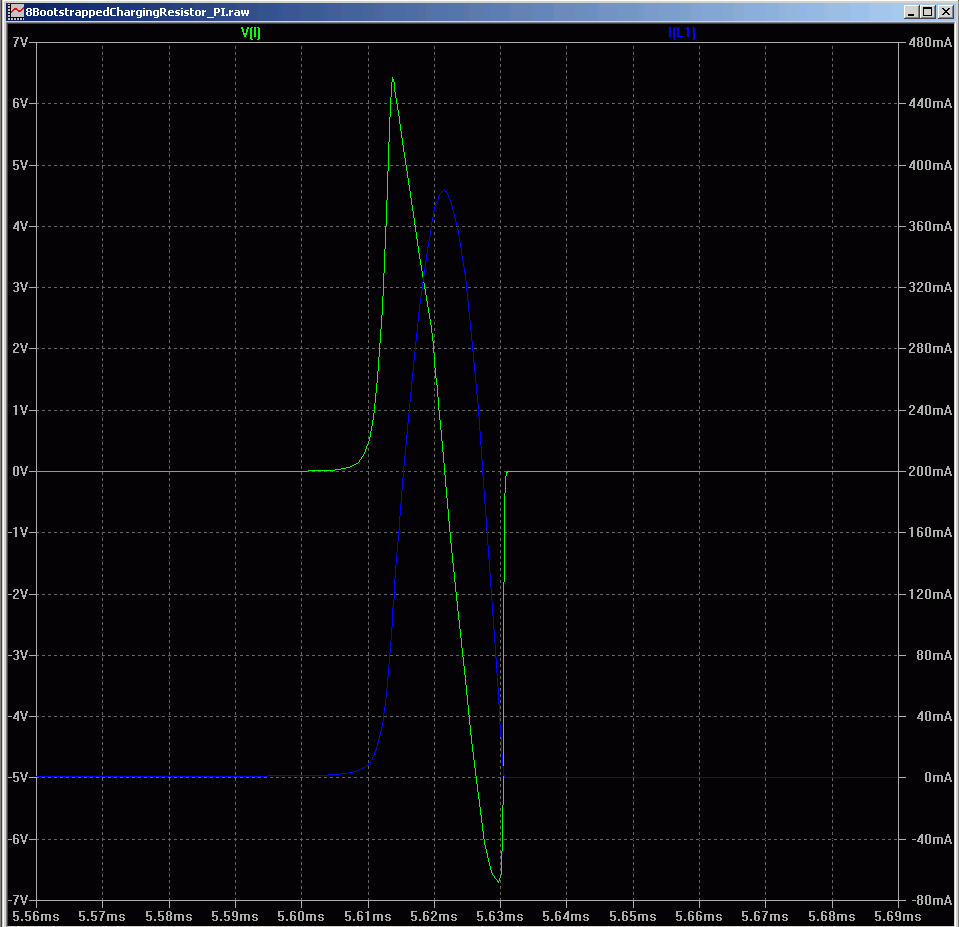

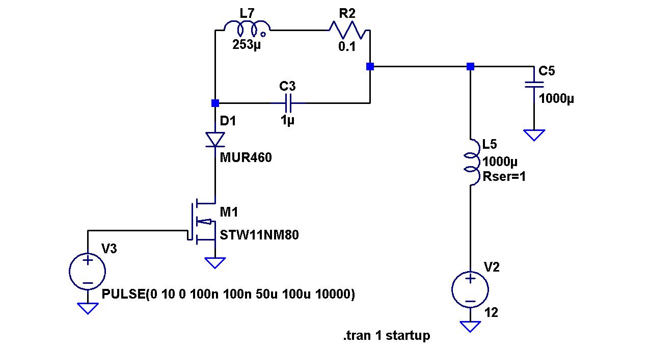

                      The diagram above is a design that I played with to see the effects of a single coil arrangement, and it is not exactly a ripoff of any existing rig, just my musings. Anyway, pulse duration is just under 20us, cosine shape, and the principle is completely scalable. So, it could have been 100V, and my pulse would again be just under 20us, but with 4A at peak. Funny thing is that Power supply does not suffer any shocks, and power consumption is a few mA. Flyback is under 1us. I'd say it could rock.

                      To obtain a transient response you need a voltage pulse, and you need a low Z termination. Depending on initial conditions you will end up with or without residual DC component. In case of single coil arrangement you don't have a choice - you must end up with zero DC. To do that you need a single pulse, which in turn gives not one but two sharp voltage transitions. One is too many because it carries no useful information, in fact it interferes with detection. That is the actual price of single coil operation.

                        • Hi Davor,
                          show us your TX circuit and we show you, where it actually flaws.

                                I must rush now, and I don't want to post the actual schematic for the time being because of some stability issues - it is sub optimal in current design - works fine only with narrow tolerances - not at all to my liking. I'll play with it in a few hours. To make it worth a discussion here I'll create it using ideal parts e.g. voltage controlled voltage sources switches etc. I think you'll like it. Point is that with a coil as a king the rest of electronics is irrelevant - it must be made to behave.
