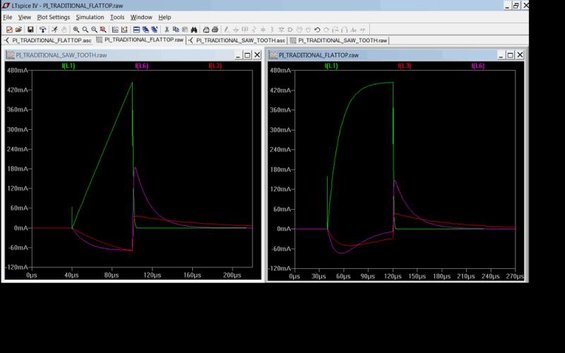

    It is true that the eddies from an unsettled turn-on will partially cancel the turn-off eddies, but I also doubt it is very significant. It would be interesting to test for this, by using a series resistor to flat-top the current on a wide TX pulse width, then removing the series R and reducing TX pulse width until the peak coil current at turn-off is the same as the flat-top current.
    I tried some simulations with a Flattop and a Sawtooth TX ramp. The results correspond to real circuit responses, but are not yet accurate enough to answer the question of the cancelling of the TX ON eddy currents.
    Attached are the simulations of a flattop TX and a Sawtooth TX of about the same coil current.
    The coil current is the green trace.
    As we can see, the target responses are quite different in amplitude.
    The influence on the long TC target is different to the short TC target.
    When we look at the target response, during the ON ramp, we can see how the eddy currents in the short TC target (pink trace) reaches a flattop at the end of the Sawtooth TX ramp. We have lots of eddy currents in the target.
    With the Flattop TX ramp we see how the short TC target (pink trace) quickly reaches the peak and then decays to near zero at the time of switch OFF. The eddy currents are practically gone.
    When we look at the signal amplitude after switch OFF, we see that the short TC target amplitude is significantly higher (184.36mA) with the Sawtooth TX ramp, than the Flattop TX ramp (147.50mA)
    Observing the red trace, of a longer TC target, we can see the differences during the ON ramp as well as the difference in amplitude after switch OFF.
    The effect on the different TC targets is different.
    This simulation shows a lot, but it does not yet answer the question of the influence of the cancelling of the ON eddy currents, because there are still too many other factors that are different between the 2 simulations, nevertheless, the simulation can give some understanding how every little difference in the setup, will produce a difference in the results.

        Tinkerer,
        With the short TC target this shows exactly the opposite of what I expect! The ramp TX causes the 'on' eddies to have a max negative value at turn-off, yet the flyback eddies are lower than the normal TX, where the 'on' eddies have largely died out. However, the long TC responses look more like I expect.
        - Carl

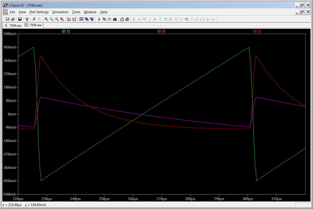

            Below is another simulation.
            With the same TX coil current I get twice the RX signal.
            I kept getting this surprising result with a real circuit and it did not fit the theory.
            Eventually I found a scientific article for a geological application that talked about the same effect. Unfortunately I have not been able to find the link to the article again to post it here,
            but anyway, the simulation gives the same result as the real component circuit.
            The simulation below has the same coil current, the same targets and the same trace colors.
            Tinkerer

                    • Originally posted by Tinkerer View Post
                      Hi Carl,
                      I am only learning how to do simulations. I am sure that much better simulations could be done.
                      So what I am doing, is to make a simulation that gives me results as close as possible to the results I have observed with real circuits.
                      As you said before, I do things backwards, normally one would make a simulation first and then build the circuit. However, I built many circuits to try to understand what is happening and now I do the simulations to see if the theory fits the results.
                      Tinkerer

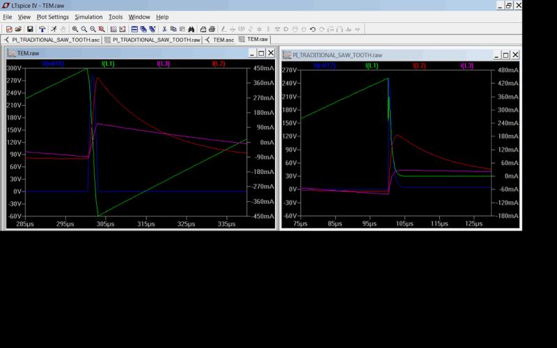

                          SB,
                          here is the simulation of the Sawtooth TX and the TEM TX side by side. Both simulations use about the same TX peak current, but the TEM simulation recycles the current and uses only a fraction of the power that the Sawtooth TX uses.
                          Also attached are the LTSpice files of each.
                          As you can see on the .asc files, the difference in the schematic is minimal, but the TEM gives twice the signal amplitude and uses a fraction of the power.
                          The blue trace is the Flyback voltage.
                          The green trace is the coil current.
                          The red and pink traces are 2 targets with different TC.
                          Tinkerer
                              Hmmm, looks to me like twice the TX current as well. Post #93 shows ~450mA single-ended, but #97 shows +/-450mA.
                              In any case, I am working on a circuit to measure this phenomenon. I'll post results next week.
                              - Carl
                                - Carl
                                It is twice the same current, charge and discharge of the same capacitor.
                                With LTSpice, TEM.asc, I use the inductor L7 to measure the current. I click Control L7 to get the average current, it is about 8mA. For the Sawtooth TX it is about 26mA.
                                The slope, or rate of change is slower, so one would expect a lesser magnetic moment, but the target response shows that the longer slope produces more eddy currents.
                                There are several differences in the circuits. TEM allows for a much higher pulse repetition rate and results in a heavier coil to get low power losses.
                                It also gives very good FE discrimination.
                                Tinkerer
