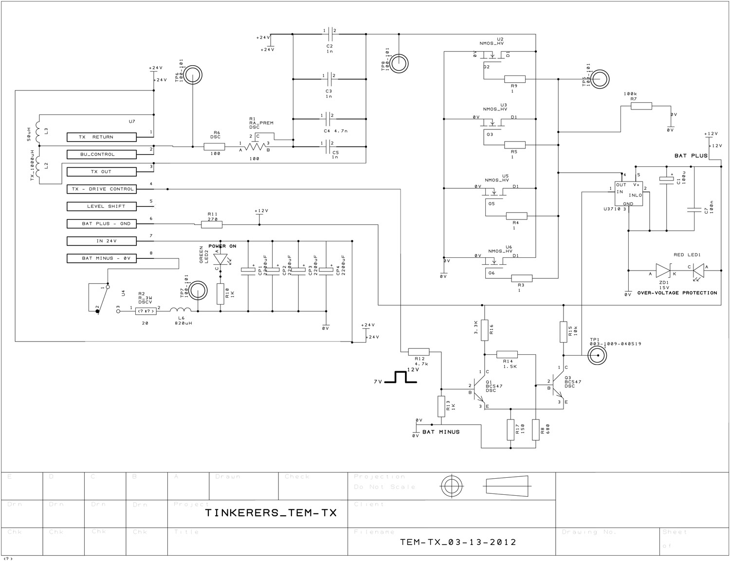

    Here is a very powerful TEM-TX.
    It is suitable for coils up to 2meters and will still give resolution for small targets like coins.
    Attached is the schematics in .jpg format as well as in .pdf format.
    Enjoy
    Tinkerer

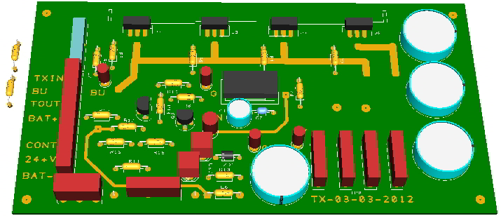

    TINKERERS_TEM-TX BOARD_3D
    Here is a 3D view of the TEM-TX PCB.
    Tinkerer

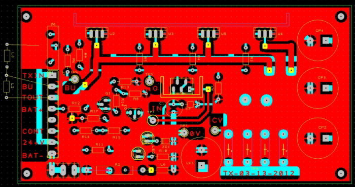

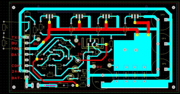

      TINKERERS_TEM-TX_PCB
      Here is the PCB, all layers, but without the copper poor.
      Then there is the PCB with top copper poor.
      Comments, critics and suggestions for improvement are most welcome.

        Hi Tinkerer,
        I think it would be good idea to get your tank capacitors as close to your connector as possible. Your asking that chunky-than-the-rest but still relativley narrow trace to carry a lot of current (How much did it end up being, out of interest ?). In fact there is probably a good case to be made for sticking them off the board completely in the actual coil head, increased efficiency, less radiated EMI.
        Midas
          Hi Tinkerer,
          I agree with Midas that the tank caps need to be located as close to the connector as possible. That is the 4 rectangular caps.
          The other thing I would do is cp1 -cp 4 should be mounted as close as possible next to each mosfet. Keep the trace between each cap and mosfet source the same length too. Then make the Tout trace a copper pour to roughly match the size of the copper pour behind the mosfets 24+v trace. It looks like you are using a trough hole gate resistor, the leads are easily left longer to cross the copper pour. You may want to mount them on the bottom of the board. Doing all of this will minimize the high current loop area on the board and the board will radiate a lot less emi. Also avoid 90 degree bends on high current traces.
          Cheers Mick

              Thanks for the excellent suggestions. Below are some numbers about the TEM-TX. I am working on a more complete description, where I will try to answer all of your questions.
              TEM-TX description.
              The TX pulse can be varied between 50 to 300us or about 20,000 to 3,500 PPS
              TX voltage from 12V to 30V
              Maximum Flyback is about 780V. This does not limit the power, but it limits the resonant frequency.
              The size of the Flyback capacitor is chosen so as to maintain the peak Flyback voltage within the limits of the Mosfet, so that the Mosfet does not avalanche.
              TX current 2A to 7.5A. The actual power consumption will be about 10% of the coil Amps.
              TX coil about 1000uH, example 100cm x 50cm with 22 turns would give a magnetic field strength of about 1.5 Gauss at the center of the coil and 0.2 Gauss at 1 meter depth.
              A 100cm round coil with 22 turns would give about 1 Gauss at the coil and 0.36 Gauss at 100cm depth.
              Bucking coil about 50uH in series with TX coil wound in opposite direction
              Total coil resistance, TX, Bu coil, cable and Mosfet, about 1 Ohm
              Coil diameter 30cm to 200cm round or square or rectangular.
              Tinkerer

                Thanks Mick and Midas, for the suggestions.
                The peak coil current at 7.5A at 780V, during Flyback, certainly needs to be addressed. Maybe the best thing to do would be to make about 4 large copper poors, each one with a ground plane on the other side.
                To enable the large variations in PPS and TX voltage, the Flyback capacitors need to be changeable. On the PCB above, I used large pads and ample space to accommodate a wide variety of capacitors, so I can try which kind is best.
                With the maximum coil current, it is probably best to use several capacitors in parallel, to divide the coil current. This also makes it possible to get the total capacitance as close as possible to the desired amount.
                The coil, cable and Mosfet output capacitance is part of the resonant tank.
                I have been thinking of using jumpers, maybe something like automotive fuses, like 40A, to switch some capacitors in or out. does anybody have a better suggestion?
                This is an experimental platform. For a specific, non variable implementation, the Flyback capacitors could indeed be on the coil.
