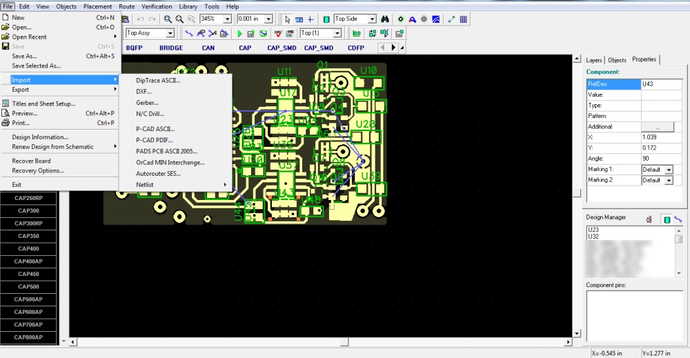

        Hi Tinkerer,
        Give it a try, it just seems to flow easy. I tried many tools before I found diptrace. I was in love within an hour! Easy to select the footprint you want, either manual or auto route, if you want to move a trace just click on it, same with a part, just click on it. I started out using the pcb program only, but over time I had to learn to use the pattern editor, then the schematic program and the library editor! Yes in that order too!
        The only downside is the pin limit. You can request a free key for 500 pin (2 layer?) The other way around it is there is a free 30 day trial, no restrictions whatsoever. System restore is your friend every 30 days....
        Also it can import a lot of different file types, including eagle libraries. See attached pic.
        Alright, now time to download your file.
        Cheers Mick

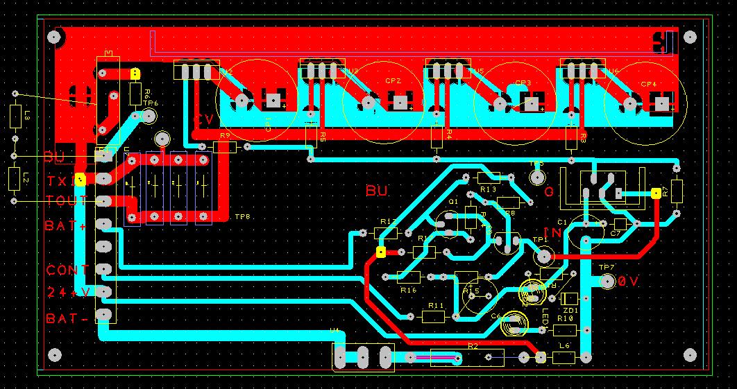

          Hi Tinkerer,
          Well after much hair pulling, I have finally got the layout to somewhat resemble what I said in my earlier post! It is a bit rough but you will get the picture. Someone who is a bit more fluent in DS might like to tidy it up a bit..... It would be nice to move the 4 resonant tank caps to the top Lh corner, but it will take me too long! Anyway with the layout as it is it has reduced the size of the current loop a lot. Also none of the high current is passing through any vias.
          I must find a way to import from DS into Diptrace........ would have only taken 1/2 hour to do what I have done in several hours..... Who's complaining? Not me!
          Cheers Mick
            Not really related to the goals here but I noticed your "overvoltage protection" circuit and it looks incomplete plus it will be the first thing to die if overvoltage does occur. There is no current limiting.
            OVP would be a good topic in a separate thread...
              Thanks for the tip. Please check the latest files, I added the resistor.

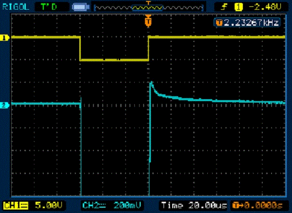

                            Thanks for making this project.
                            I used R12= 8.2K on the level shifter. Attached is a picture of output at TP1 (blue trace).
                            My question is if it is normal to have a ~200mV overshoot with a long decay back to zero?
                            I've noticed the same thing in other circuits since I got my scope, even on the FET output of my HH2 without coil attached.
                            I'm trying to find out what causes this... it doesn't seem inductance or capacitance would be large enough but maybe I'm wrong.

                              Is your channel 2 AC coupled? Try DC.
                              Tinkerer
                                Chan 2 is definitely set to DC. Probes properly calibrated. Hmm? I wish I had another scope on hand to compare. Maybe someone could post what their TP1 looks like?
                                A couple other question Tinkerer? Did you have ideas for the 4 FETS and their driver (U3710)? I was going to try 4 IRF740 FETS and a TC4421(inverting). I'll LTSpice this circuit first. For the 24V IN would be battery or boost? I'll post some pics as I progress.
