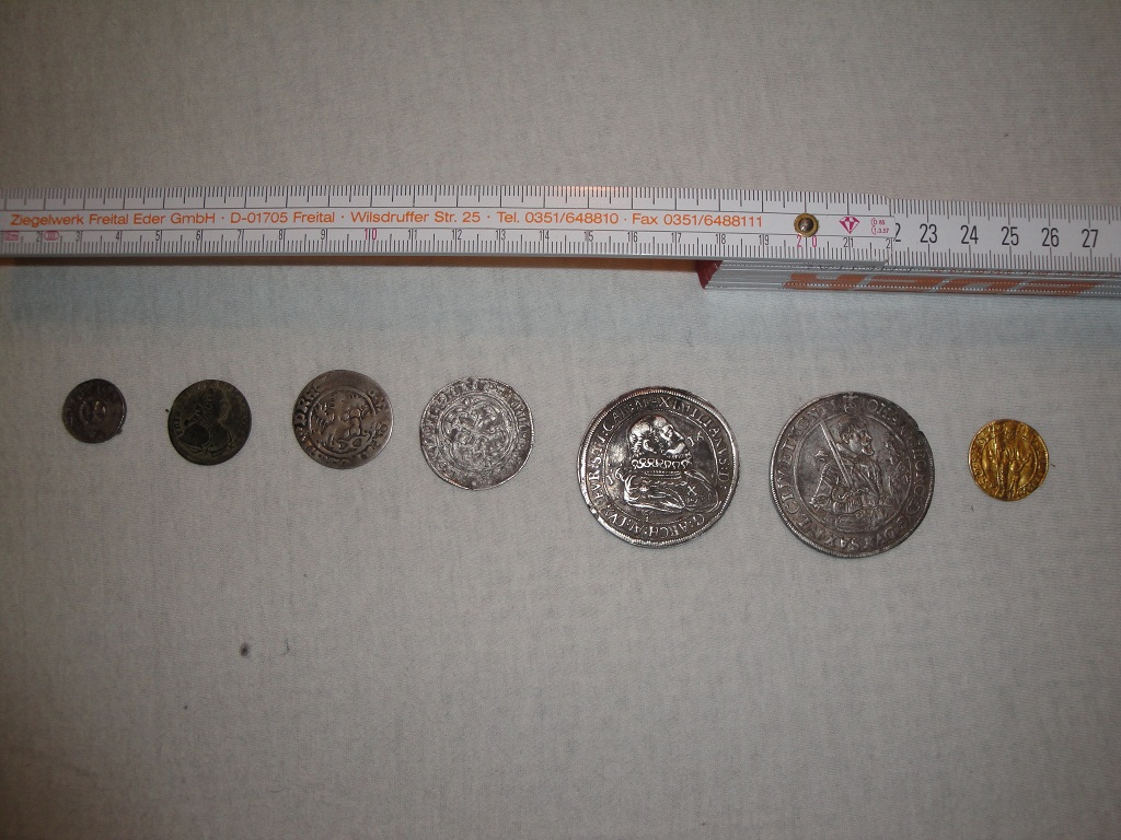

            • Hello Tinkerer,
              I have read all your post´s about the Tinkerer-Tem-IB-PI. Thank´s a lot for sharing your knowledge.
              I think the Tinkerers_SB is the right PI for my needs. But i need your help.
              My objects that I want to find (and have found) are Silver and Goldcoins. Goldcoins are very rare here(only one in 15 years), so the maingoal are Silvercoin´s. The problem is, the PI must found silver below the cultivation layer.(30-40 cm deep). The coin´s are between 17mm and 45 mm(see my Picture).
              The bigger Coin´s are 2 mm thick.
              I search on flat mowed or plowed fields most time. So i think a big coil is good. Are 40 cm round enough, or should it be bigger?
              Here we have not a lot mineralization, no hotrocks, but the ground is sandy and loamy. So i think a simple GB method is good enough.
              We have a lot of Iron (Part´s from Worldwarweapons, vehicles, tractors). So i think a possibility of discrimination between iron and other is a must have.
              Is the Tinkerers_SB Motion or Non-Motion sufficiently for my need´s?
              Thank´s a lot
              mschmahl
              • You got some very nice coins there. To find such coins at 50cm depth, a 40 to 50cm diameter coil will be good.
                For 50cm depth with the very thin, small coins the powerful TX of the Tinkerers_SB is good enough.
                The TC's of these coins are all over 10us - 15us, so you can use the TX timing that gives the best response for this kind of targets.
                I will help you with the PIC timing code.
                For the GB, we will have to do some experimenting.
                Please ask for any clarifications I will be glad to help.
                Good luck
                Tinkerer

                    • Originally posted by mschmahl View Post
                      Those are some excellent finds! You must have been over the moon when you found the gold coin! It must have been very exciting.
                      Out of interest, would you mind telling us what the coins are? I watch Time Team obsessively, so I'm really interested to learn about your finds!
                      Good luck with your detector build, too!
                      -Pete

                        Hello Pete,
                        the golden coin is a gulden from nederlande it is dated 1588. The smallest silvercoin is a Hochrandpfennig, probably from Magdeburg Germany, datet between 1004 and 1052. The biggest Coin is a Taler from saxony with Johann Georg, dated after 1600,and the other big Coin is Maximilanus from prussia, dated 1616. The middel Coin is a Silbergroschen dated betwenn 1400 and 1500.
