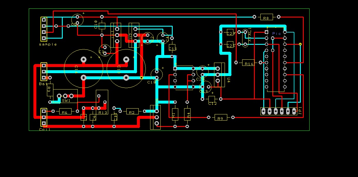

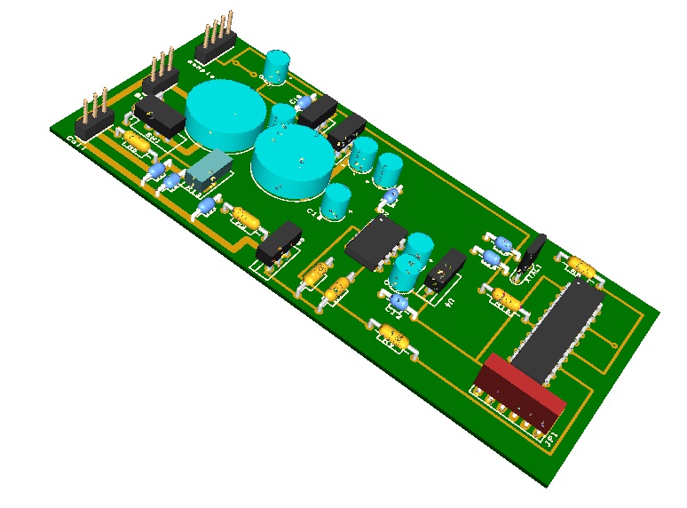

                  • Hi all,
                    here is my first effort to make a PCB for the Tinkerer_SB PSU&TX.
                    It is for 2x6V batterie and 50-cm roundcoil. The schematic is from http://www.geotech1.com/forums/showt...677#post155677 with some changes that tinkerer discussed with me. I send the PDF with this changes.
                    IT IS A TESTBOARD WITHOUT WARRANTY OF FUNCTION!!!
                    And it is my first time to make a pcb. I have not respected any rules of construction a low noise rig, or other rules for making a proper pcb. I think it can be improved a lot, so all comments to make it better are welcome.

                      • Originally posted by mschmahl View Post
                        Hi all,
                        mschmahl, that's a great effort for a first attempt! You've got the right ideas - nice thick power and ground traces, and keeping them as short as possible.
                        One trick to try : if you have a lot of short zig-zag tracks, you might be able to realign the components slightly so the tracks are more straight. You'd be surprised at how many times this makes routing the same components so much easier. When that happens, of course you must say it is by clever design!
                        Also, once you've routed all the tracks, have a look to see if some tracks can be swapped to the bottom layer, so most tracks are on one layer (I usually try to put as many tracks as possible on the bottom of the board, it's easier to trace connections without the track disappearing under a component! But in your case, the tracks are pretty clear). Sometimes this will give you some ideas to make the board single-sided, even though it starts out very double-sided!
                        In your case, possibly the tracks in the coil/battery connector area, as well as under the big capacitors, could be moved to the bottom of the board. It always pays to keep tracks around big components that can go "bang" on the bottom of the board, so it's easier to troubleshoot, and if anything goes "bang", your tracks won't be damaged so badly. And again, if they're on the bottom of the board they can be traced more easily. That's just a tip from long experience!
                        I'd be pretty happy with your board. It's a great start.
                        Cheers,
                        Pete
                        • Hi mschmahl, great looking board, well done.
                          What EDS program are you using....Designspark???
                          Sid
                          • Yes, it is DesignSpark! It is realy easy to learn and have a lot part´s. You can download missing part´s and it is all free.
