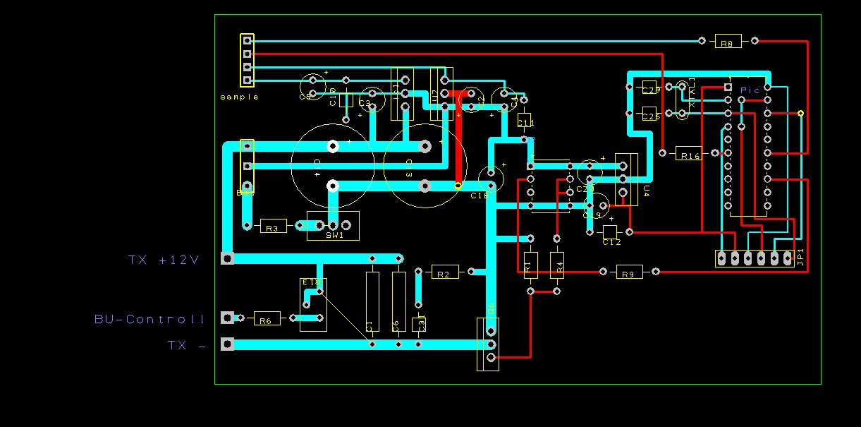

      Hi all,
      here is my first effort to make a PCB for the Tinkerer_SB PSU&TX.
      It is for 2x6V batterie and 50-cm roundcoil. The schematic is from http://www.geotech1.com/forums/showt...677#post155677 with some changes that tinkerer discussed with me. I send the PDF with this changes.
      IT IS A TESTBOARD WITHOUT WARRANTY OF FUNCTION!!!
      And it is my first time to make a pcb. I have not respected any rules of construction a low noise rig, or other rules for making a proper pcb. I think it can be improved a lot, so all comments to make it better are welcome.
      [ATTACH]23412[/ATTACH]
      [ATTACH]23414[/ATTACH]
      Hi mschmahl,
      congratulations for your excellent work on the board.
      Here are some things to consider:
      with everything working as it should, there can be an average current of about 3A in the coil and mosfet. This is the average, not the peak. therefore, a heath sink is recommended on the mosfet. Also check the TX traces on the board and the connectors, if they can handle 3A continuous average current.
      The average coil current must not be confounded with the TX power consumption from the battery, which is normally about 60mA to max 170ma. The small consumption is due to the power recycling in the resonant tank.
      The Flyback capacitors C1 and C6, must be high voltage capacitors. I have tried quite a few different kinds, but have not found any significant differences. Some of these are physically quite large, so enough space must be left.
      For your purpose, a Flyback time of about 10us is probably ideal. This will need about 10+10n. I say about, because the coil inductance will vary depending on the wire you use and how tight you wind it and the capacitors have some tolerance, maybe 5% or 10% or 20%. All this is OK because we leave some leeway in the timing.
      However, under the worst circumstances, the timing could be a little short. This would have the effect of increasing the power consumption quite a bit. The problem can be solved by adjusting the timing or by adjusting the capacitance.
      All the best and good luck with the testing.
      Tinkerer

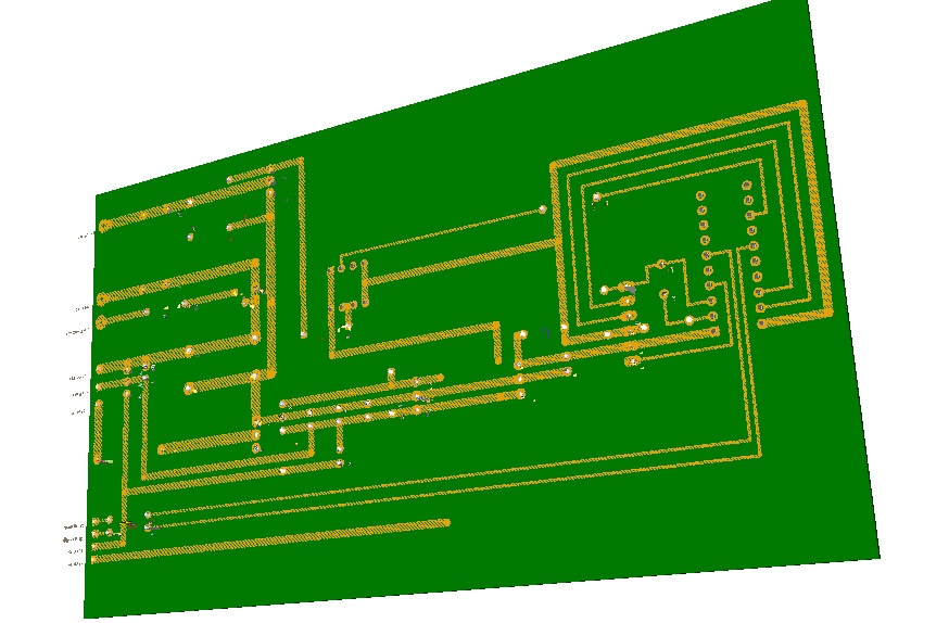

              • @all
                I have made some changes around C6, C1 and Coilconnection, but without heatsink for the mosfet (i don´t find one in libary). I think the best ist to solder the coil direct to board for handeling 3 A, therefore are the big pad´s. I have reconnect some part´s on the left, but i have to do it with the ride side.
                Greetings from saxony.
Name:	PSU&TX 21.02.13.jpg

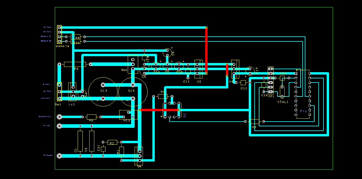

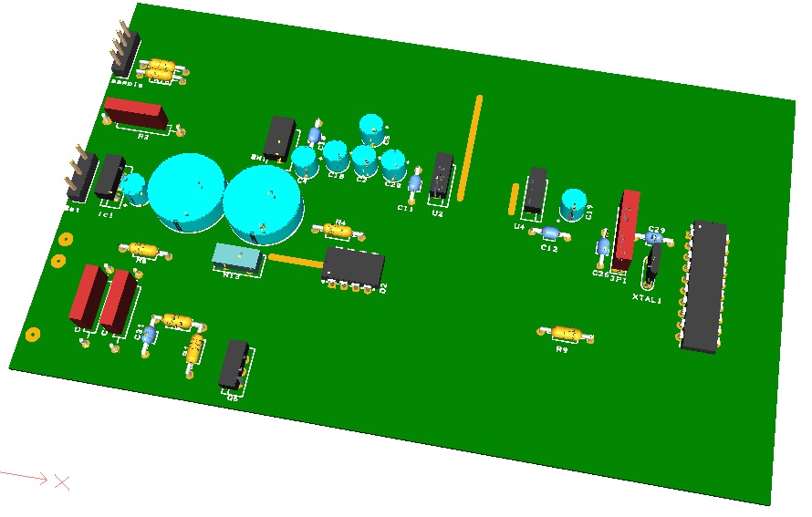

                • New PCB for PSU&TX.
                  Further changes are: - R3 must be a big one with 3W
                  - Pinswap for -5V and +5V; sample #1 and sample #2; batterie 0V, 6V, 12V and Coilconnection
                  - allmost all track´s are on the bottom side, only 3 track´s are on top side, so the PCB can be made single-sided
Name:	PSU&TX 24.02.13.jpg
                  One problem i see is on IC1, the LDO for + 5V supply. It is always on, because ground is 6V and in is 12V and there are no switches to turn off this IC. We could use an additional switch for batterie +6V.
                  Greeting´s from Saxony
Name:	PSU&TX 24.02.13 back.jpg
ID:	335181Click image for larger version
Name:	PSU&TX 24.02.13 front.jpg
                  • Hi mschmahl,
                    R 13 must be about 100 Ohm, 10 or 20 turns for fine adjustment.
                    R 6 is better about 47 Ohm, to limit the current that R13 sees. (R6+R13) should be between 47 Ohm and 150 Ohm.
                    All the best
                    Tinkerer

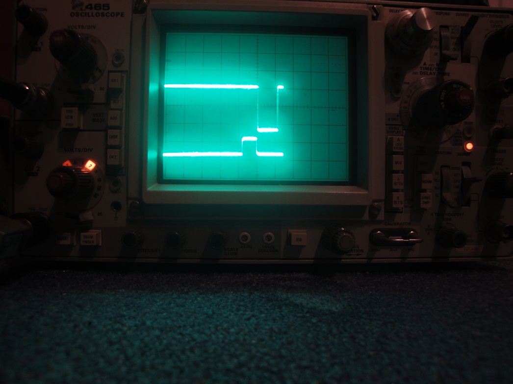

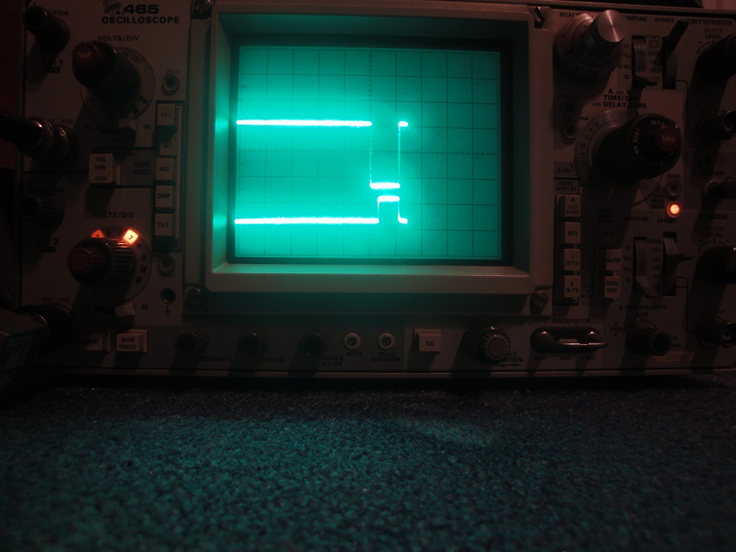

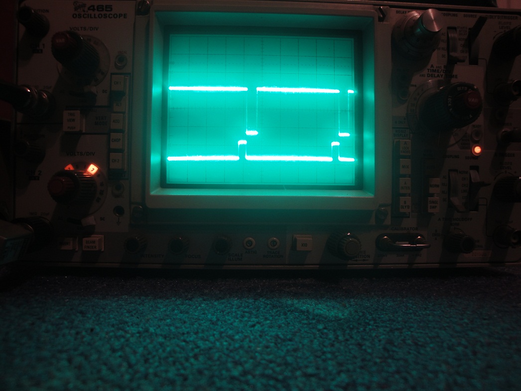

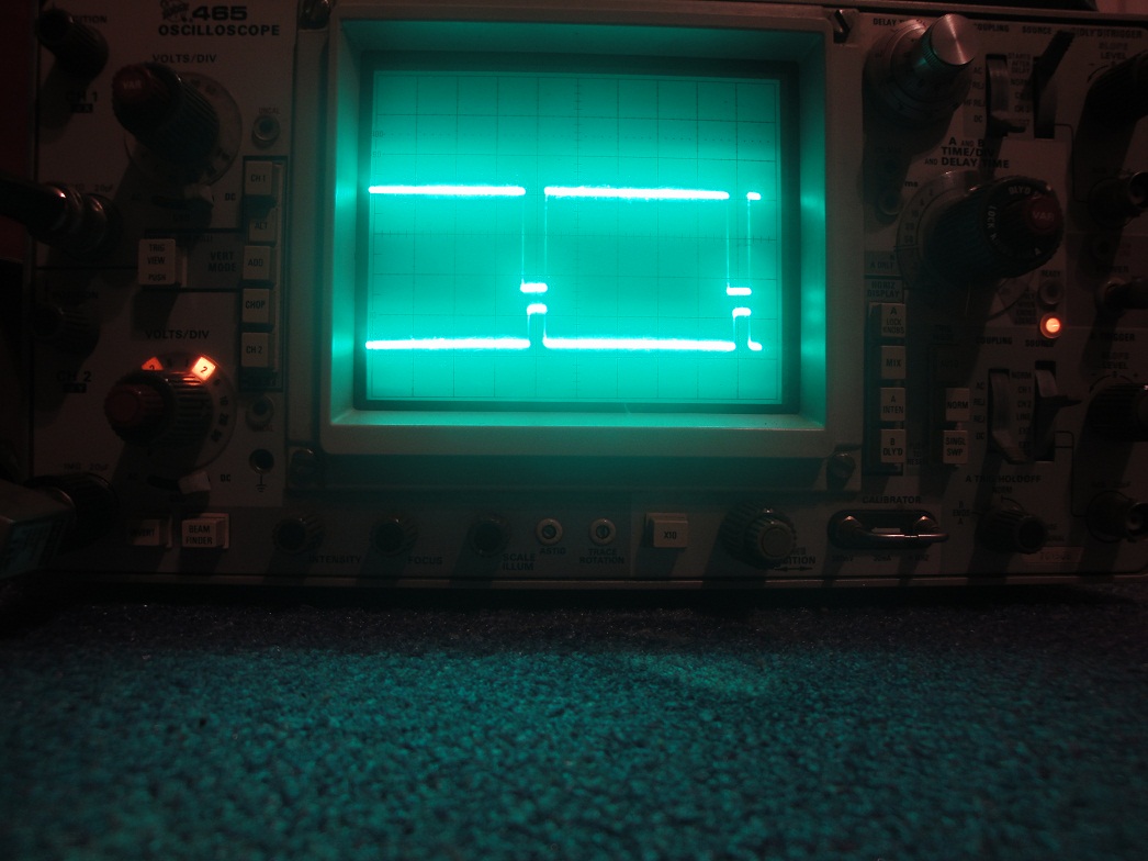

                            • Sorry for my little report, but i have almost no time for my hobby these day´s.
                              The two board´s are now complete and all is wired good. The voltages are fine on the socket´s. The PIC is working right. I have made some scope-pictures
                              for TX ON and OFF and Sample 1 and Sample 2. I have take the probes for TX on Pin 2 of TC4452 socket and on Sample-connection-point on RX-Board.
                              Next step is building the coil.
                              Tinkerer thank´s for your tireless help.
Name:	TX 2V&10us Sample1 5V.jpg
Name:	TX 2V&20us Sample1 5V.jpg
                              • The timing is correct, congratulations!
