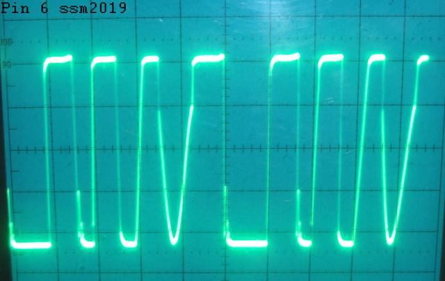

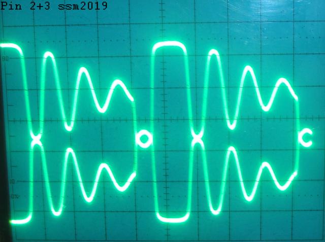

    can we go trough balance coil´s and settings for R27 and R28? The tinkerer_sb is on with permanent tone in headphones. It doesn´t show any reaction for metall. Here are some scope-shot´s.
Name:	pin 2+3 ssm2019.jpg
Name:	pin 6 ssm2019.jpg
    I have built in the sn74hc4066n. On Pin 1 and 11 i see the same how on pin 6 from 2019 and on pin 13 and 12 i see the sample from pic. If i touch pin 2 or pin 10 with the scope-probe then the tone is changing higher or lower and one of the led´s glow.

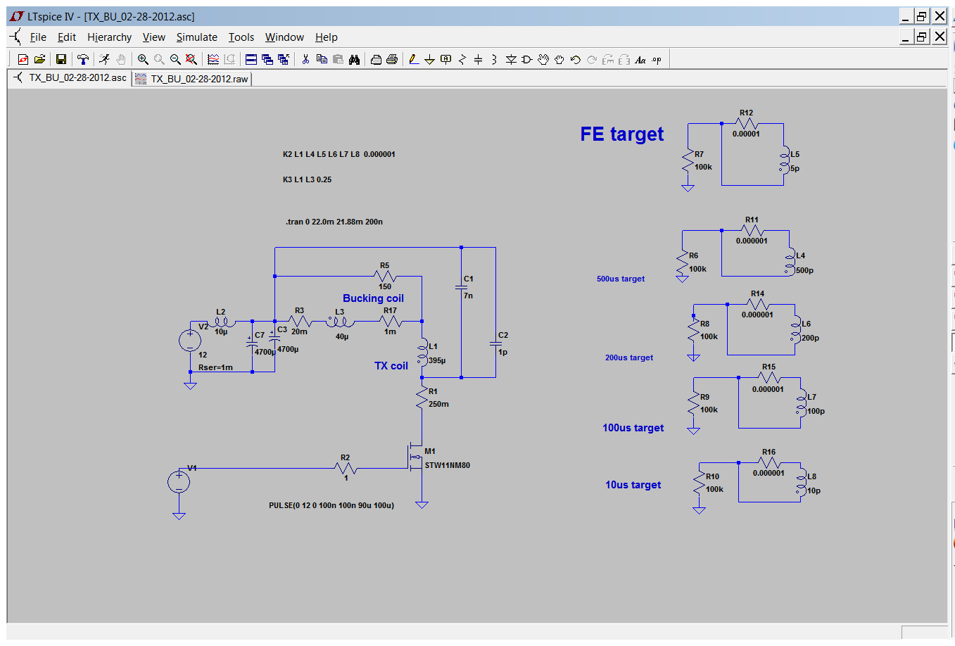

      • Below is the LTSpice simulation file for the TX and target responses. With this you can see the differences that any change in Flayback capacitance or inductance causes.
        You can also see what the different wave forms should look like.
        For the induction balance, the important part to look at, is K3 L1 L3 0.25 this means that the surface area covered by the BU coil must be 0.25 times the surface area covered by the TX coil. Use medium coil thickness for the calculations.
        Tinkerer

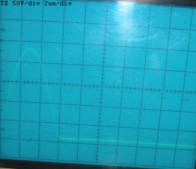

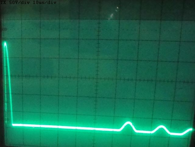

          • Hi tinkerer,
            i have a flyback now. The problem was the 6V supply for TC4452. Now i have 12V and all looks better.
            Here are the pictures.
Name:	tx 50v div 2us.jpg
Name:	tx 50v div 10us.jpg
            Thanks for your spice-simulation and your help.
            • The first picture of the Flyback is good. Symmetric and no truncation.
              On the second picture we see oscillations. Not good. Is this the STW18nm80 Mosfet?
              Could it be that the power supply does not deliver enough current?
              Normally the 2 large capacitors should supply all the current for the TX.
              PS. on irfan, you can also rotate the pictures by a few degrees, best before cropping, and re-sample for smaller size.

                  The first and the second picture are the same. Only the first with 2uS/div and the second with 10uS/div. It is done with the STW18nm80 but wired with cable clamp. I think too, that the current is to weak. What batteries did you use in your rig? Is there a possibility to check the current from this 2 capacitors? I have 2x 2200uF not 2x 4700uF how it is in the spice-simulation.
                  Thank´s a lot.

                    • The problem with the TX could be:
                      We reduce the inrush current into the capacitors C13, C14, with R2, therefore we delay the capacitors from reaching their full voltage.
                      Switching the TX pulses on immediately, with a source that has a relative high internal resistance, does then not let the voltage reach full level for some time.
                      An initial delay in the timer will probably fix that.
                      An alternative solution would be to add a second switch to switch on the PIC timer after the rest of the circuit is powered up.

                            I simulated the delay. About 100ms should be fine. Got to change the PIC code for that now.
                            The simulation is really quite useful. Many things are so much easier to observe on the simulation than on the scope. I first made the real circuit, then tried to make a simulation that reproduces the results of the real circuit. The problem above, occurred because of subsequent changes, to improve details. It clearly shows that any change, anywhere in a circuit, causes possibly many subtle changes somewhere else in the circuit.
                            The more people tinkering with the design, the sooner we will have uncovered all possible problems.
                            Tinkerer
