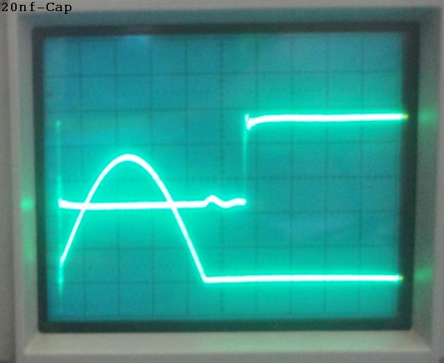

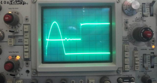

    I have soldered the 18nm80 in and short circuited Pin 2+3 by my clumsiness. Now it is dead. So i have use the 6n60 again.
    Here are some pictures. It is the TX-Controll-window (5V/div) and the flyback (50V/div) in 2us/div. They look´s better than the pictures from 18nm80. First picture is with 10nF Flyback-Cap. Second is with 20 nF. The flyback is reduced with the 20 nF cap for 75 V. I think, that is not so good.

    • There is less current and less flyback, because of the higher resistance of the 6n60. If you have no oscillations during the rest of the cycle, it is OK to uses it as is. You can test the rest of the circuit now and change the Mosfet at a later time.
