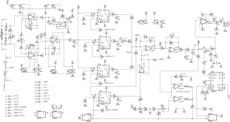

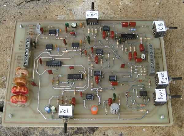

        Thank you for your kind words, Dave.
        Below is an older circuit and board. There are some good things in that circuit, but others could use some improvements. For example the Audio. The response is not dynamic enough.
        The use of the CD4046 could be much improved.
        Tinkerer

          Tinkerer is there a high resolution version of your schematic available anywhere please ?
          • #80
            I think at the post below, is the last version. EAGLE FILES.
            I do not recommend to build it. I posted it for discussing it's good and not so good parts.
            We might re-use some parts in the TINKERERS_TEM_IB-PI.
            For example the 2 tone audio (needs improvement) with the mute and dead band.
            http://www.geotech1.com/forums/showp...24&postcount=6
            Enjoy
            Tinkerer
