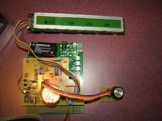

                          • UPIM up and running
                            The attached pic shows the LCD and Rotary Encoder hooked up and running.
                            The black 9v battery (top) is powering the evaluation board and screen and a 12v gel cell (just off screen to the left) is used to power other circuitry and the TX pulse.
                            bugwhiskers
