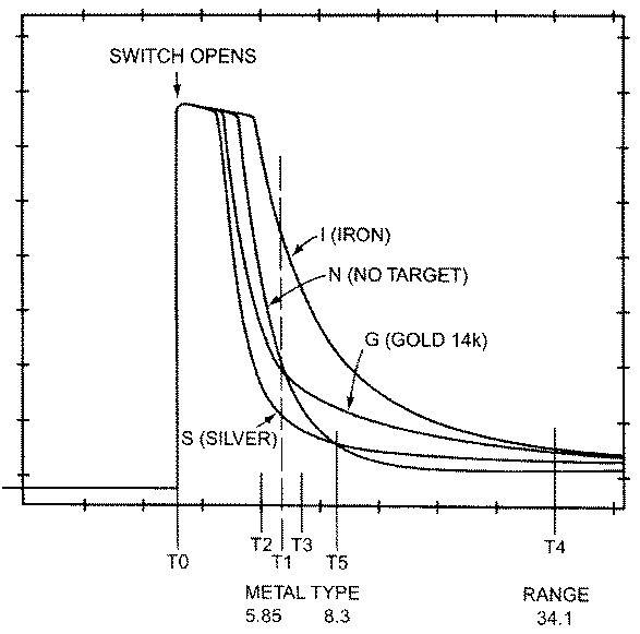

    Bugwhiskers,
    Thanks for the reply.
    Can I request you to post decay diagrams and timings for various targets, which I could utilise in understanding the discrimination process and setting sampling delays.
    Thanks once again.
    • Hi Atul Asthana,
      It's not possible to give you absolute locations in terms of microseconds out from TX off to take your samples due to the spread of coils, pre-amp types and feedback caps on the pre-amp.
      It's all a matter of adjusting the locations and widths of the two samples to get the maximum signal difference between targets of differing conductivity.
      The best place to put the first sample is where the decay is more horizontal than vertical, just past the knee of the curve.
      bugwhikers
      • UPIM Principle
        Hi Atul Asthana,
        Its principle is here:
        Regards!
        • Discrimination : Decay diagrams
          Thanks 1843.
          That has helped me understand the discrimination. I can see where all I need to sample.
          However,
          What do the numbers indicate? are they relative time delay values? [5.85, 8.3, 34.1]
          And what is the significance of the T[0....5]?
          • Hi Atul Asthana & 1843,
            Thanks for that pic, it makes it a lot easier for people to understand the underlying principle.
            You can clearly see that the better the conductor the flatter the curve.
            The "T's" relate to the timings of the samples but it will only apply to their coil/preamp configuration, just experiment to find the sweet spot.
            bugwhiskers
            • Originally posted by Atul Asthana View Post
              Thanks 1843.
              However,
              You need 2 sample, depends on your coil. If your coil is fast enough like the diagram you can use T5 and T4 (both in microsecond). The diagram timing is the best positions for proper DISC and keep in mind that the samples width should be 1 to 5us.
              If your DISC doesn't work OK with this timing, then it means that your opAmps gain is not set properly. You should try to get this timing and then set the samples gain.
              1843
              • Discrimination : Decay diagrams and settings
                Thanks, that helps.
                I guess, carrying out this comparison in software should be still better. I hope the ATMega8 design will be available in the near future.
