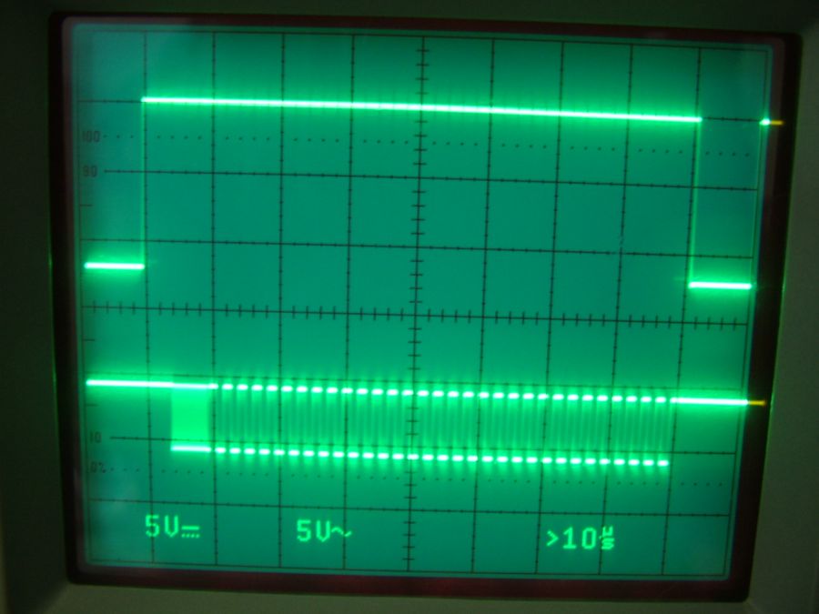

    The circuitry following the preamp gets 64 samples (via switched capacitors) of the early part of the decay waveform. The time between each sample can be as low as 100nS. At that speed it is possible to capture 64 samples of the first 6.4 uS of the decay waveform. The capacitors are then switched in turn to the AtoD of the micro and the digitized result is stored in RAM.
    One area of RAM holds an average of all the previous samples with user adjustable software lag and another area holds the most recent. The lag is necessary to prevent small changes being swamped by the averaging. Ground signal and preamp drift will become part of the average set of samples whereas any abrupt change will be seen as a target. Because the sampling is done very early in the decay it should be possible to discriminate.
    What is unique about this approach is the the samples are gathered very quickly and then later processed at leisure between the TX pulses. This technique obviates the need for a super fast micro and a super fast AtoD.
    The 10uS per division CRO shot shows, in the bottom trace and to the left, the 64 samples being taken (6.4 uS). The rest of the trace shows the time taken to digitize them and store to RAM.

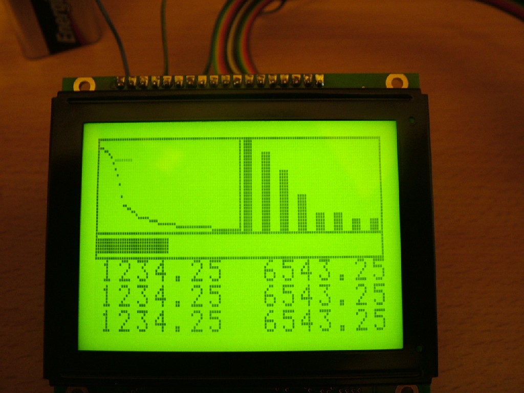

            Screen option
            The attached pic shows an example layout for the 64 S&H PI / UPIM.
            The LCD is 128*64 dots.
            The top left box shows the 64 samples (actually a couple less due to the box lines) The top right box is a zoom window of 8 of the samples of the left box.
            The bar graph in the middle is signal strength and the 6 digits are user adjustable variables.
            I am waiting on a couple of 240*128 dot screens to arrive, these will allow double the resolution and allow more room for other "things"
            bugwhiskers

              I like it.
              Raynm
                do you have any code available for us to look at yet? My assembly language skills are quite rusty so I might have to look at it for a few months to understand how and what you are doing in the controller.
                thanks
                RayNM
                  like it
                  Hi BW
                  Yep it be looking good thus far , Waiting in anticipation
                  Gef fm OZ
