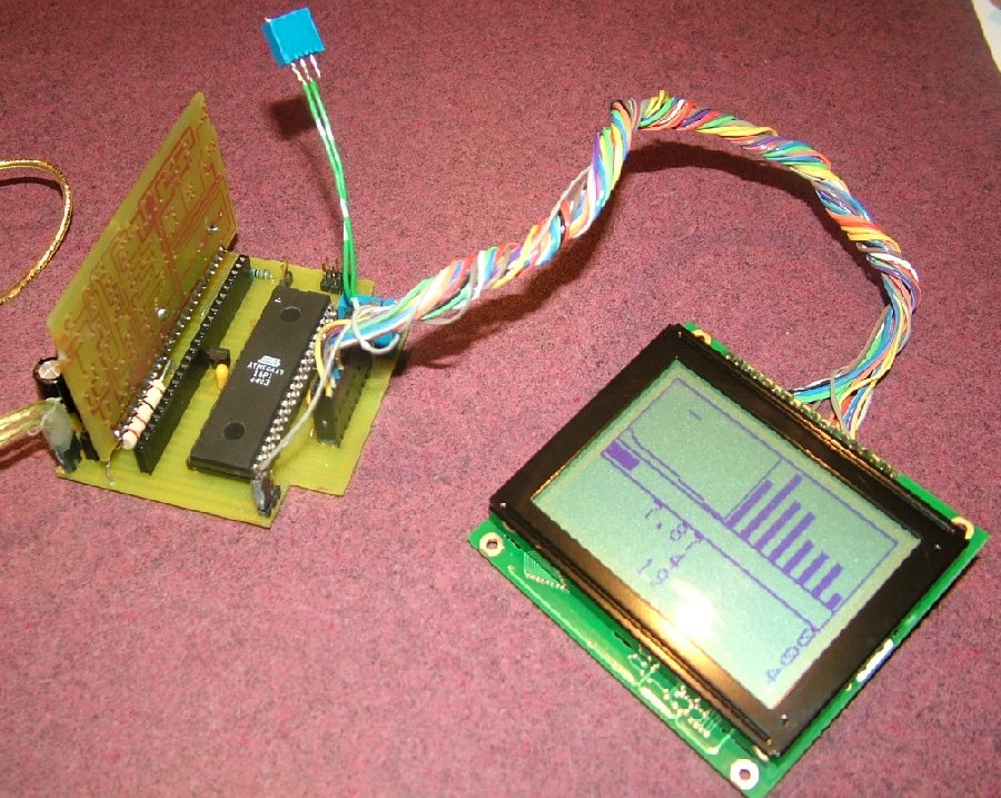

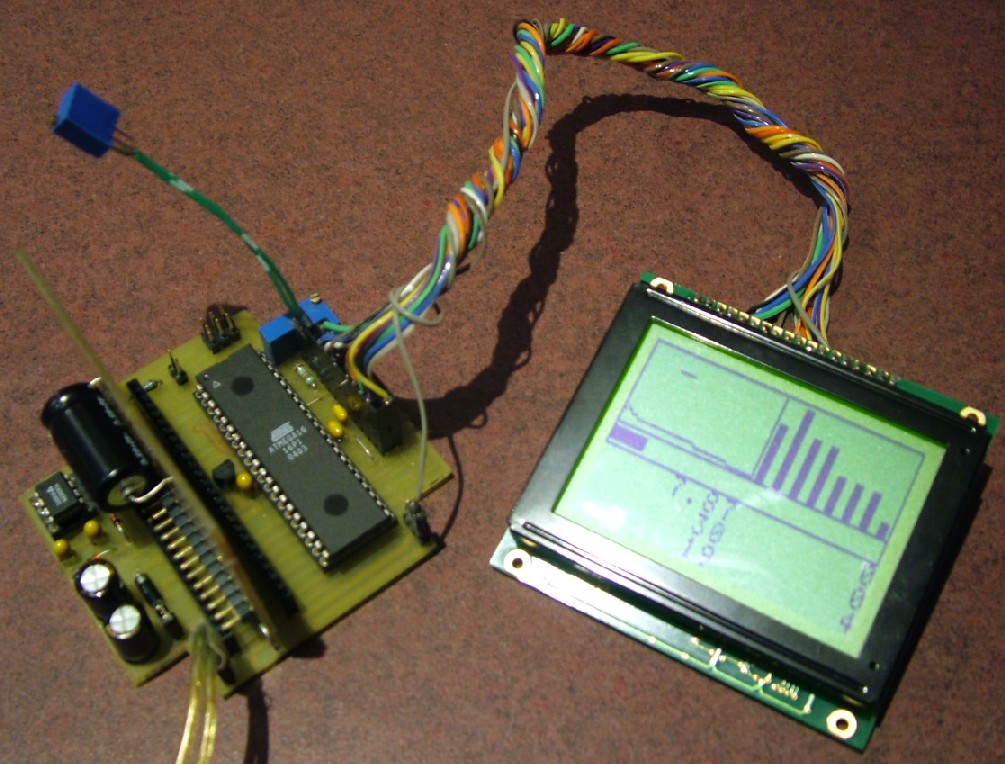

        UPIM Motherboard
        The attached files show pics of the UPIM Motherboard at work, Schematic and PCB.
        The schematic has the legend for the bus, what each bus line does.
        There are a few components mounted under the micro. The board is single sided with just a handfull of links and not too tight to make at home like I did using Kinsten pre-coated PCB material.
        If anyone wants the CAD files (Eagle light) I will post these also.
        In the pic you will see a PCB in socket #1, this is the coil/pre-amp board, it will be populated tomorrow and I will post the schematic and PCB file. It is based on Carl's Dual/Single coil with 2 stage pre-amp.
        Today I ordered 3 of the micros but they won't arrive until the end of April so the final programming can't happen till then.
        All the chips (10 * 16 pin PDIP's) required to take 64 samples won't fit on the PCB. I have laid out a SMD version but that is a while off being made. The compromise is to have a 24 sample version, using 3 of the 8 chips required to take 64 samples. The artwork is ready and I just have to make the PCB and populate it. All going well there will be a 24 sample PI up and running by the weekend, I for one can't wait to see how the samples in certain areas of the decay curve change with different metal types.

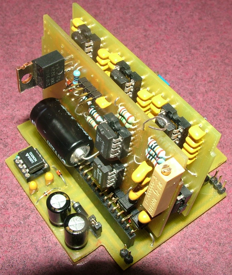

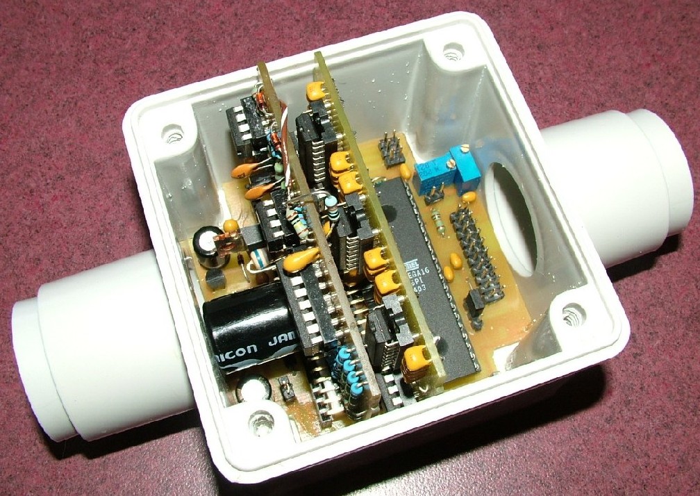

              UPIM Phote
              The attached pic show the UPIM with both boards in place.

                    I have worked out a way to get 64 samples and still use only DIP chips (not SMD). If you look at the previous photo you will see room above the CPU. I intend to make a board that "piggy backs" onto the sampler board and sits over the CPU. Six 74HC4051's and the associated caps just fit ! The front board will easily house the remaining two 74HC4051's, 74HC4053 & 74HC138. There will be room also for a dual OP amp to buffer the signals coming in and going out.

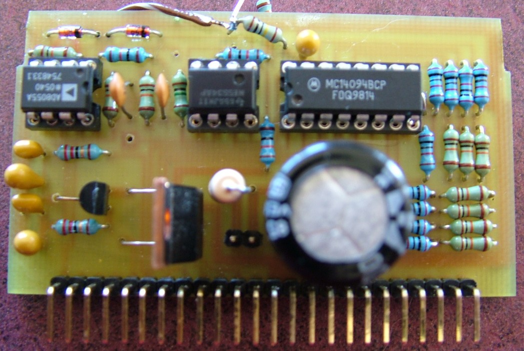

                        Coil-Preamp pic
                        The attached pic is of the revised coil-preamp board.

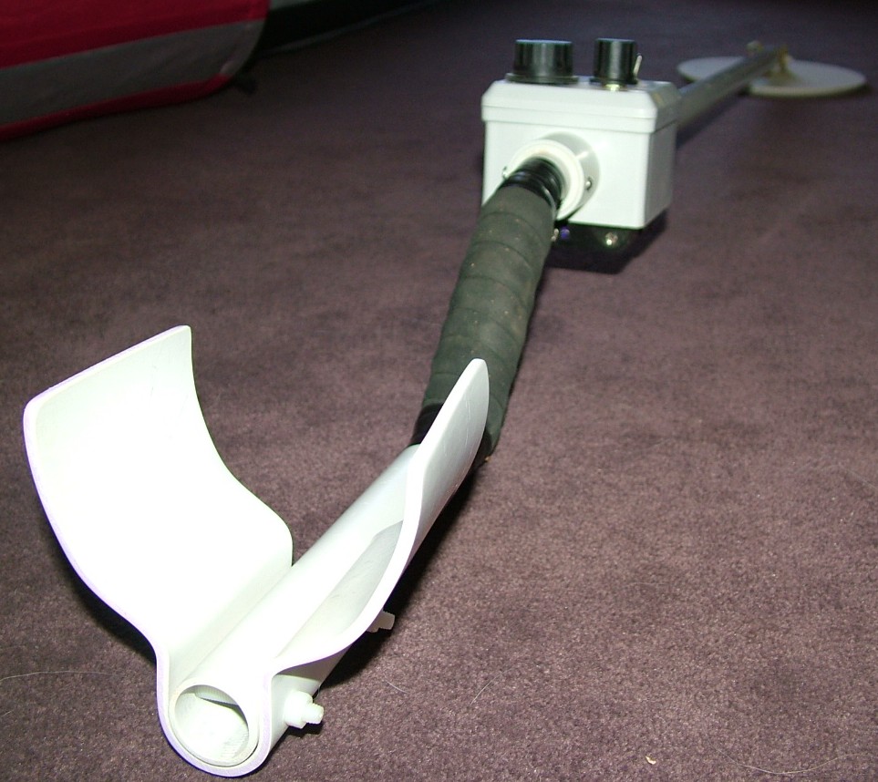

                          The attached pics are the reasoning behind the shape and size of the UPIM circuit boards. The plastic (polycarbonate methinx) are readily available, relatively cheap and light weight, they are also very tough and with the right sealing, rainproof too. The handle and fittings are also readily available and cheap.
                          The detector shown is an early design. The batteries can just be seen mounted on the underside of the box. The weight of the whole detector inc batteries and coil was just over 1kg, no steroid treatment required to allow a user to swing it all day.
                          bugwhiskers

                            coil preamp
                            Hi BW
                            Looking at your coil preamp schematic I noticed 2 op amps .. seem to be running in parallel the AD8055 and NE5534. Is this so , is some sought of dual sampling going on here and then maybe averaging it out at a later stage. ??
                            Just curious. The finish product is looking ok.
                            gef
                            • #59
                              Hi gef12,
                              Thanks for your interest in the project.
                              The first preamp, the NE5534 has a gain of 1000 and provides most of the amplification. The AD8055's claim to fame is it is very fast and can drive low impedance devices like a cap that needs fast charging/discharging. The combined capacitance of the 64 caps is 64 * 0.1 uF or 6.4uF worst case which is quite large and must be done in 6.4uS at the fastest sample rate. Essentially the 2nd preamp is just a buffer so as to not load the first stage. Now that the offset adjustment is going to the 2nd preamp I will be able to have some gain on it also. Because the AtoD converter must be fed a signal that ranges between GND and +5 volts the offset circuitry must ensure the signal doesn't go too far below GND.
                              Because this is a project that is still on the fly there will no doubt be some changes along the way.
                              Hoping this explains your question.
                              bugwhiskers
