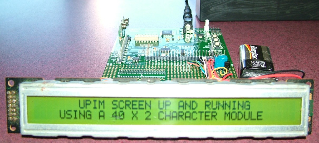

              • Hi BjBj,
                All R&D work is try it and see. A few things are certain, the AtoD must be inside the micro so that external transfer overhead doesn't slow things up. I am going for the maximum number of bits and then see what is left that is usable. Another certainty is the low cost and ready availability of these evaluation boards. The PGA and digital filtering is also a very big plus for the ADUC845, it will allow software programmable gain and possibly elimination of certain noise bands. Don't forget, the AtoD will be reading the voltage on a cap which is static and I can interlace the readings to allow for the best possible result.
                I do appreciate all input BjBj, afterall, this is not a commercial project and I expect to make nothing out of it except a detector that will do what I want.
                Knowing how the sampling works, perhaps you could provide an alternative method to achieve the same objective, I assure you my ego will be totally unaffected as I am under no illusion that I know everything.
                The attached pic is of the Evaluation board running a 40X2 LCD.
                Now I can start doing some sampling and see just how many of those 24 bits are realisable.
                bugwhiskers
                  Splendid!

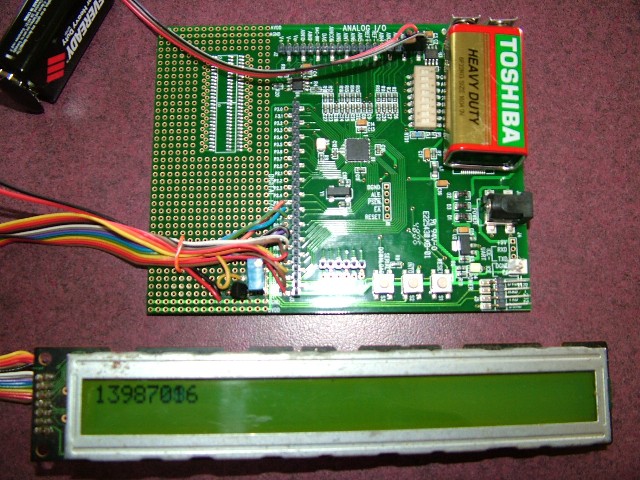

                    • The routine to get an AtoD reading onto the screen is working as can be seen in the photo.
                      Leading zero blanking is working and if the input number is zero the last zero is left intact.
                      Notice some jitter on the second last digit. The input is being fed from a 10 turn pot connected between AVDD and GND. After watching it for a while I concluded that there is a jitter of ~ 1000 without any digital filtering or S/W averaging.
                      The next step is to hook up the multiplexers, pre-amp and coil drive circuitry.
                      bugwhiskers
                      • Changing the input to the pot from AVDD to REF+ has reduced the noise to ~200. The test was done with the fastest conversion speed which also has the worst noise.

                            • Hi BjBj,
                              I did even worse than that, I put a wet finger on the adjustment pot leads and the 4 digit noise was evident. Remove the finger and the numbers return to exactly what they were, about 5 times in a row this was performed.
                              I can email you the video if you want.
                              I must admit I had trouble believing it also but a picture is worth a thousand words and a video even more.
                              bugwhiskers
                              • In what way should i intrepetet that?
                                Good or bad?
                                Bad if its 24 bits, good if its 16bits?
                                What pot are you using a +100ppm ,50ppm, 1ppm?
                                Your test are at home in somwhat controlled enviroment step
                                out into the your Aussie desert at 50deg c for aminute os so
                                and expose the ADC/Mux/Caps/resistors ,etc to the heat and
                                it will change.
                                Better yet put in a LM 35 or similar and continuely read it and calibrate
                                away the temp change to the sampled coil value!
                                Btw if you have still pictures from scope of the sample noise it would be nice!
