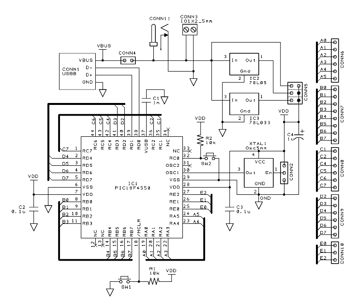

    In this thread, I'll post the information required to implement a USB interface using a PIC chip. For now, I'll keep it in the CDG section to give us an advantage, but will probably move it in the future to the public area.
    USB offers at least two big benefits: an easy way to change the PIC code, and a way to pull data out.
    Microchip sells several PICs with built-in USB hardware. I bought their 18F4550 demo board which you just plug into the PC, run the software, and *voila* it all works! That's the easy part. The hard part is figuring out how it all works, and how to make changes to do what you want it to do. They include source code for the firmware but, amazingly enough, not for the software.
    So it was 2 weeks of near-full-time work figuring it all out. I'll skip the gory details.
    The final chip I used is the 18F2455, which is a 28-pin SOIC version (4550 is a 44pin QFP). After pins for power, clock, MCLR, and USB, there are 20 GPIO pins left over. There is a 10-input 10b ADC and the usual array of comparators, timers, interrupts, and PWM.
    Programming the PIC is done in 2 stages. First, using a stardard PIC programmer you load the "bootloader" firmware which is fairly small (~1000 bytes). You are done with the PIC programmer, and you can solder down the part. Then, the main firmware is loaded in over the USB, and can be done so repeatedly. Also, your firmware can poll the USB for data input, or send out data, as it is running.
    That does it for the description. I will begin uploading the code details tomorrow.

                  This thread is getting long, and it seems like implementing USB is difficult, but it is not IF you don't deviate far from the example code Microchip provides. I am trying to include all of the major pieces of the puzzle that might, at some point, get modified, and describe what they do. When I first jumped into this, I didn't know, I quickly found out how easy it is to get the whole thing in a non-working state, and then discovered that there is no good explanation of what everything does.
                  I'm having a lot of fun with this at work. My first project was a 2GHz clock synthesizer, and I used the PIC for a USB-to-SPI translator to control the SPI port on a PLL chip. I have a Windows program where you type in the binary bits to send to the PLL, click a button, and they're sent via USB. My next project controls the SPI port on a VGA chip (gain control), but also controls individual config pins on a DAC. So right now, I have code written for generic SPI writing, and for generic bit setting. I need to add SPI reading and bit reading.
                  One potential use for this is to control digital pots. Some of those have simple up/down wiper control, some have 3-wire SPI control. We could use these to replace mechanical pots, use USB to figure out where to set them, then hard-program in firmware.
                  From the last post, the next topic to go over is USB-enabled firmware. For this, I highly recommend starting with Microchip's demo code and taking baby steps. Along with a Windows program, Microchip's code does the following:
                  • Controls 2 LEDs; they are turned on & off via the Windows software
                  • Reads a mechanical pot via the PIC's ADC and sends the value to Windows software
                  • Reads a temp sensor via the PIC's ADC and sends the value to Windows software. Data logging is done to maintain a short history.
                  So they show you how to send data to the PIC, and how to get data from the PIC. I've been working to take their code and create more generic functionality, functions like:
                  • void WriteBit(port, portnum, value)
                  • int ReadBit(port, portnum)
                  • void WriteSpi(CS, data)
                  So if you want to set A2 "high", just write
                  WriteBit("A", 2, 1);
                  All my code is at work, so I'll post more info on firmware & software next week.
                  My next step is to design a generic little USB board that is basically nothing but a PIC 18F2455, a crystal, and a USB jack. I will then pin out all the PIC I/Os, so they can be patched into any other circuit board. This will enable us to use USB control on any circuit, without having to design it in.
                  - Carl

                        I drew up a PIC USB circuit, decided to go back to the 18F4550 since it has more pins in a smaller package. I'll just need to get a socket to do the initial bootloader programming.
                        Anyway, my thought is to build up some boards with programmed PICs, and send one to each Design Group member. You guys interested?
                          PIC boards
