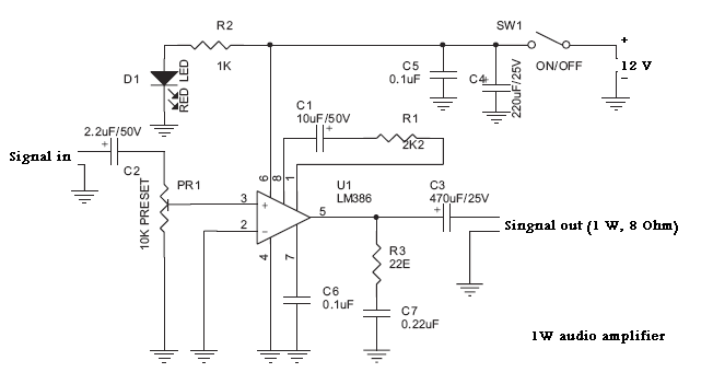

          Hi AZIZ,
          I select these circuits for TX and RX amp,
          now i am ready for make a laptop detector,
          please help me about this.
          what kind of coil is good for our project? what diameter and what turn of wire need for rx and tx coils?
          for Tx signal, we must use a signal generator software ok ?
          for Rx signal, we must use a oscilloscope software or similar ok ?
          i am waiting for your good ideas...
          Thanks...

            Hardware:
            Ok, your proposal should work anyway.
            Coil:
            Just use two equal dimension coils with impedance of 8 Ohms. If you like, then form a D type shape. Otherwise take the coils in circle shape. The balancing is quite easy for this type of coils. Small overlapping area of the coils should bring the coils in balanced position. The exact position should be seen on the software graphics output of the time-domain RX-signal. Diameter of the coils: any (let say 15-20 cm). Number of turns: any (let say 50-100 windings).

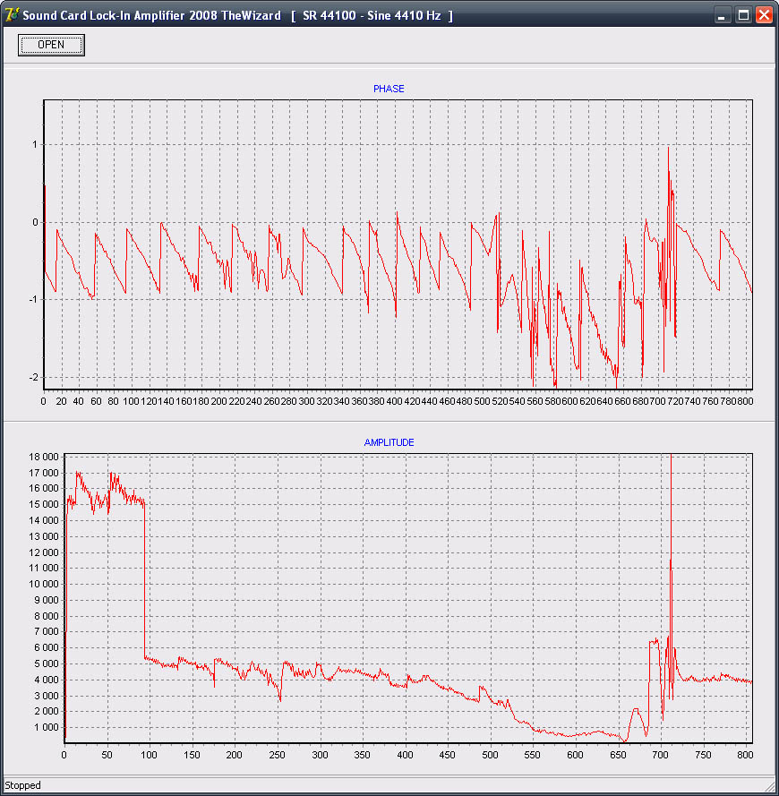

              ....Then performing a simple FFT and displaying the power and phase spectrum .....
              NOT need FFT....
              Soft is easy -
              Create SIN TX buffer for sound card
              Allocate RX buffer for sound card
              Play/Rec TX/RX
              Stop
              Zero crosing and find 90 deg samples to calculate Amplitude and Phase

                    I speak about standart balansed, one frequency MD,
                    not for multiple frequencies...
                    And FFT is not magic method for metal detecting
                      The first test....

                            For PI metal detector, sound-card can not work - For Pulse-Induction you need ADC witht sample-hold up 500k samples per sec, sound card is only 44100, 48000, 96000 - too slow for PI....
                            • #44
                              The sound card is used in a full-duplex mode. This means, while you sending a wave form through the transmit coil, you acquire in the same time the received signals from the receive coil. The acquired signals have a time delay (latency time). If you know the latency time (doing a synch), then you see the difference: transmitted signal causes some effects, which can be seen on the received signal. On induction balanced search coils, you will see a phase shift and amplitude change on targets.
                              The laptop is able to send any arbitrary wave form. It is possible, to search on multiple frequencies at the same time so doing a better discrimination.
                              Analysing on one frequency, the search coil can be used in resonant mode. This mode gives a better sensitivity and stability due to following facts:
                              1. on multiple radiants of the wave form the effects are summed.
                              2. resonant mode means, the coils are connected to a capacitor and they acting as a very sharp notch filter. Disturbing EMF is omitted and only the operating frequency is observed. On the resonant frequency, the coils have only the real part of the complex resistance: Z = R + j(wL - 1/wC). The imaginary part of the complex resistance Z gets zero on resonant frequency.
                              3. Eddy current effects can be detected much better.
                              Due to limited sampling rate of the sound card (48 or 96 kHz), only VLF/TR/Off-Resonance type detectors can be made. On the other hand, the ADC/DAC of the sound card is getting more attractive: 24-Bit and the high SNR (signal-to-noise-ratio).
