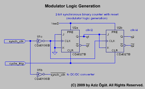

                  • Hello friends,
                    I will revise my channel modulator with precision timings and higher resolution. It will be a full stereo channel modulator (two channels per line). The binary counter will be dropped and replaced by a JK flip-flop. So it delivers precise synchronous logic levels (both q, /q). The JK flip-flops will be switched to a two bit synchronous binary counter with reset capability (synchronisation).
                    This will give the ultimate high resolution data conversion possibility. A fallback into a pure two channel PI could be also realized. In this case, I will have the highest possible resolution (each channel has its own ADC).
                    Aziz

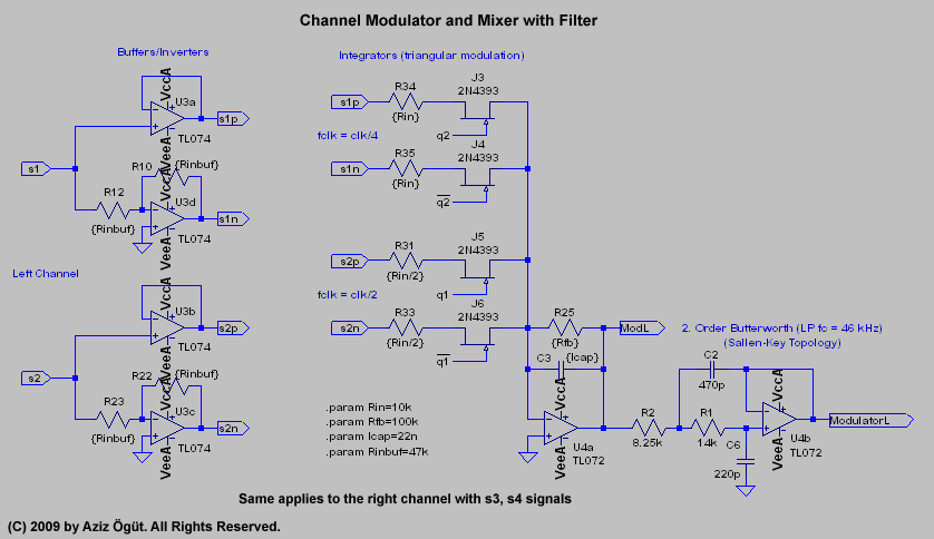

                    • Hello friends,
                      here is the improved stereo channel modulator. The modulator shown below is for the left channel. Same applies to the right channel with the corresponding signals s3 and s4.
                      The modulator logic is now improved and should give more precise timings. The modulator clock is buffered twice. The other one feeds the DC/DC converter. I will build this improved modulator next time.
                      Aziz

                        • Hi all,
                          I have replaced the Schmitt-trigger CD40106BP with MC14106BCP. So the 220 pF capacitor in the mono-flop (cycle trigger pulse) runs stable. If you want to use the CD40106, you have to increase the capacitor to 330 pF or 470 pF. The cycle trigger pulse with isn't important and can be increased slightly. The micro will be triggered on the raising edge (from -5V to 0V).
                          I have started with the improved stereo channel modulator and will be finished in few days. I had to built the clock generation part once more on a second board.
                          Aziz

                              • Hi all,
                                the new stereo channel modulator for total four channel signal acquisition is working now.
                                I took lots of TL072 (dual op-amp) instead of the TL074 (quad op-amp) for the case, that I want to use a pure two channel PI. Then I can remove some parts from the board (two TL072, four BF245) and can use the full ADC resolution. The modulated stereo signal will be overlayed with the control signalling from the micro later (laptop have to know mode changes and push button events).
                                Bad news: My on-board internal HD sound-card isn't working on the right channel. I didn't use this till now. Must be a mechanical problem (too much plug-in/plug-out stress I guess). Fortunatelly, I have another two external USB HD sound-cards and the development will not be delayed. I also tested a very cheap sound-card (48 kHz/16-Bit) and is really not convenient to break the limits. But is in principle working with reduced resolution.
                                I will do some more tests on the new channel modulator.
