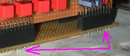

            Aziz, can you say how do you wire this (by flat cable?):
              Ok we are on waiting list.
              No, this is only for power supply and mechanical connections of the boards.

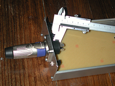

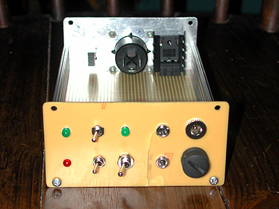

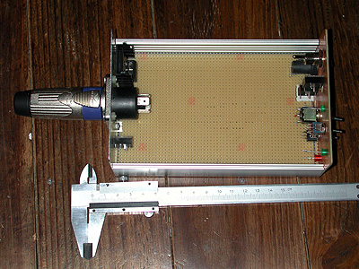

                I have finished some parts of the IB-PI detector. Unfortunately, the front plate is broken and is not looking very nice. Anyway, I have still the original Aluminium plates for the final version. Look at the monster coil plug. It's just a professional audio speaker plug. But I need it for very high coil currents (up to 50 A).
                I have seperated the RX input from the TX output. It is easier for two box configurations to seperate them.
                I can start soldering the circuit in the coming days now.
