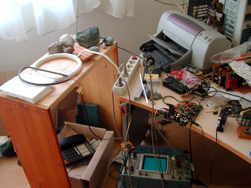

    I am close to finish the IB-PI project now. I have achieved my goal for this year and I have the answer to the initial question now. Yes, it's working. It's a damn good detector now. It's a killer detector with outstanding ground balance feature and will handle heavy ground mineralization too (in the software).

      I have no commercial intent yet. There is no plan to sell the software nor to give it for free. If I am going to sell anything, I have to patent some ideas before.
      BTW, there is no ready finalized software yet. I have done it with my experimantal software only (contains a lot of stuff for analysing, diagnostics, measurements, etc).

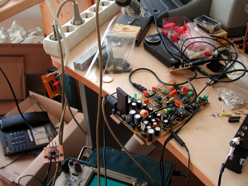

      I want let you merely know, that the simple hardware (see page 33, 34) is the base for a vapour detector. The software coding is not easy and quite difficult (not for me of course).
      You have to re-invent some of the novel concepts to make it as a vapour detector.
      BTW, I am still working with the introduced IB-PI HW from page 33/34. I will change the platform to the next revision soon (to the high power version).
      See below the realisation of the first cut IB-PI HW.

          I am going to fold the Al foil again ... have to finish it ...
            Great work. You can use Alu wire or strip too in this manner:
            and then glue it with resin which represent at the same time insulation.
              This coil is looking very nice (looks like from an induction heater).
              Yes, I'll do it in the same manner but more compact. The coil capacitance does not matter. It's welcomed.
              I have to go yet 20m + 30m = 50m (including isolation). Then I will be able to form a D-type coil for the DD IB-coil. Won't be glued for the first time experiments. This is only to satisfy my curiosity.

                    I am trying different wires for coils and comparing them.
                    Following "wires" to be investigated:
                    - self-made Litz wire (via magnet wire)
                    - ribbon cable (considered as Litz wire)
                    - cheap loudspeaker cable
                    - cheap 30 m Aluminium foil folded as an Al strip (approx. 10 mm width)
