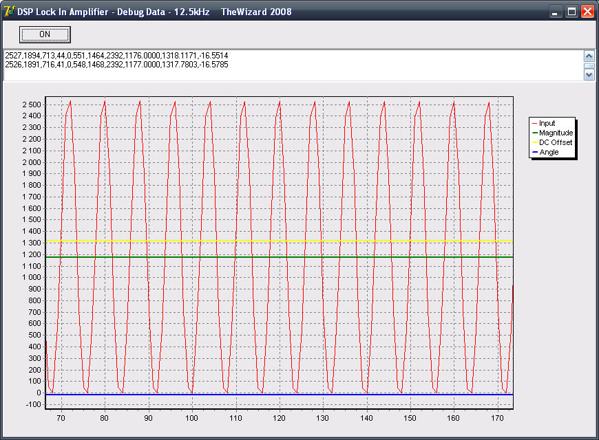

    Originally posted by TheWizard View Post
    This days I will investigate results... I need to write Win Exe for debug datas from DSP
    ADC is 12 bits 0..4095, sample rate 100k, Vref 3.3v
    DAC is R-2R, for 12.5kHz sine TX - 16 steps, 5 bits, filter is only one capacitor
    DC offset must be ~2048(I have not AMP driver to correct DC for 1/2 Vref), but in my calculations DC offet is without meaning... in picture Ofs is calculated DC offset (in ADC steps)
    window for 12.5 kHz sine is 8 samples per wave
    and this is not the best times and results, this is only FIRST test
    Next I will try to create PWM sine wave for coil and add some drivers and LP filters...
    Hi TheWizard,
    it's not easy to debug with DSP's. I know this. Have you enough LED's on your board for debugging purposes?
    Try to drive the coil with an LC-oscillator later. The R-2R DAC can then be used for other purposes. Do not forget, to add protection diodes to the ADC-input.
    Aziz

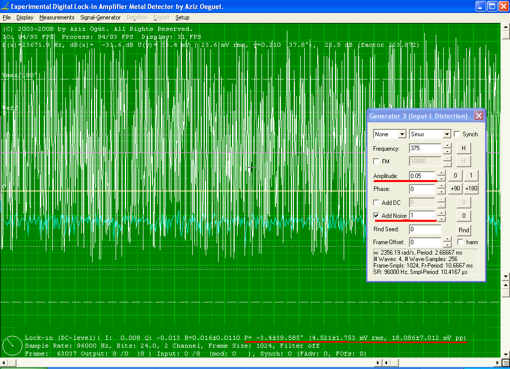

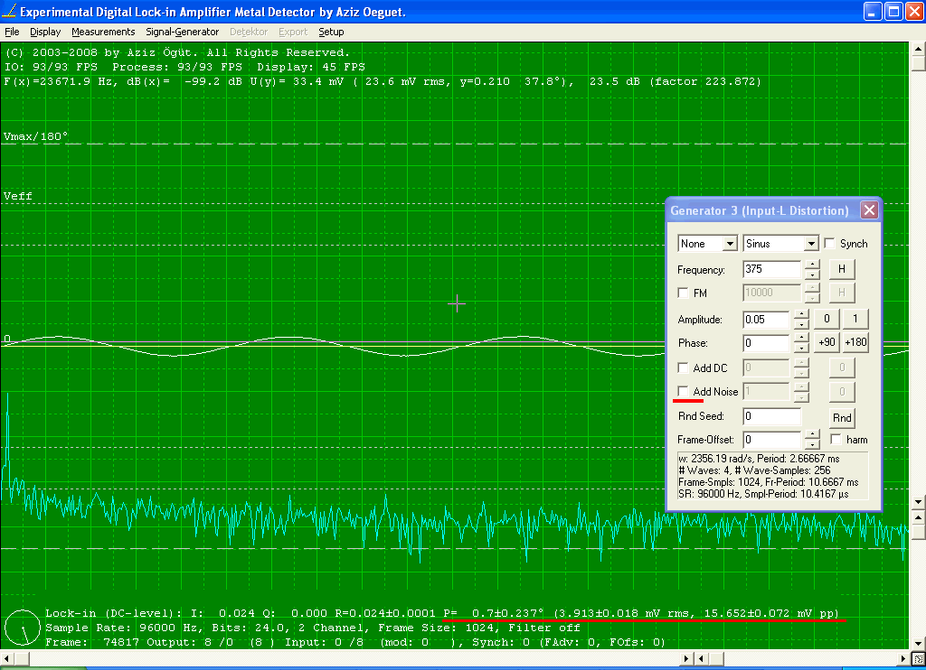

    • #92
      Look,
      where is the signal gone? Can you see the signal at 375 Hz?
      • #93
        Here is the signal!
        Noise (white noise) was 20 times more than the small signal.
        Noise is also applied at 375 Hz.
        • #94

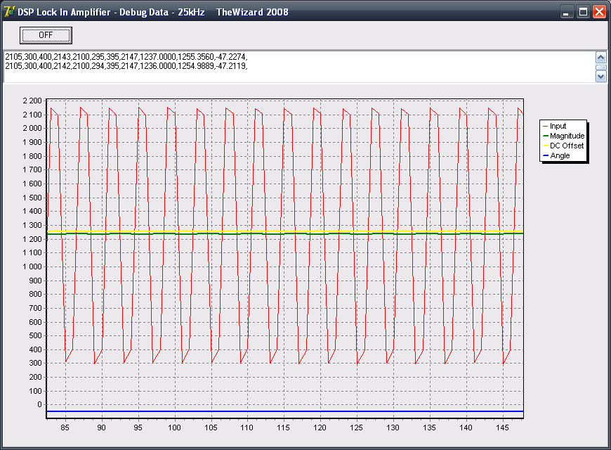

              • #97
                Here is Debug Data from my first DSP test at sine waves 12.5kHz and 25kHz

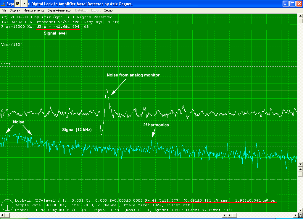

                  Now I have measured 0.7±0.1 µV r.m.s on the coil. The coil was driven with ultra-low-power directly from the sound-card output (level set almost to zero!). The RX coil was connected to a 1000x amplifier and the amplified output is fed to the sound-card line input (~100mV r.m.s full-range).
                  I found that my hardware is not working well. Due to coil not driven in resonant mode, strange oscillations happens on the RX-amplifier. I had to put the sound-card output into low level therefore.
                  The power spectrum seen on the FFT-spectrum was fully of noise. There was more noise than signal. (Bad) coil not shielded.
                  Due to bad amplifier, I couldn't balance the coil to a very low level. The measured signal was the rest of the balance (0.7 µV rms).
                  I have to search for a better hardware (very low noise, stable, etc.) now. Then the results will be very surprising.
                  Aziz
                  • #99
                    When I increase the frame size from 1024 (~10.6 ms) into 32768 or more samples and increasing the time constant of the lock-in LP, then I can even measure signals down to nV r.m.s range. It depends on the sound-card and amplifier accuracy.

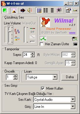

                    • Wilma software
                      Hello
                      I built a tgsl from ivconic.İt is not working good but I want to an experiment with my pc. I have a Wilma Software for decode some Tv voices that crypted or need decode.İt is a free software and always with Moretv downloads. You can download with a easy search ''Wilma'' .
                      I attached a radio to input cable to pc But if open radio I can hear from PC.
                      radio is not power on there is not seen any signal on screen.
                      But İf I put TGSL over radio and Open TGSL there is seen a One signal.
                      Like triangle shape. And İf I change TGSL tunning button one button is channging this triangle signals bottom width.Large to narrow OR reverse.
                      And more İf I move Coils TX and RX left to Rİgt Signal Place on screen moving left to rigt or rigt to left.
                      İf A metal over coil I can see Triangle signal changing it s shape.
                      I thing it is very interesting Maybe could use for zeroing for coil.
                      Or new things I attached Only picture of wilma to easy find.
                      • Hello
                        Ofcourse Tgsl working good but I thing I am making an error during build .
                        I tryed same thing with delta pulse but Nothing seen on screen.
                        signall seen with tgsl.
                        I attached More tv zip that including Wilma
                        Erol
