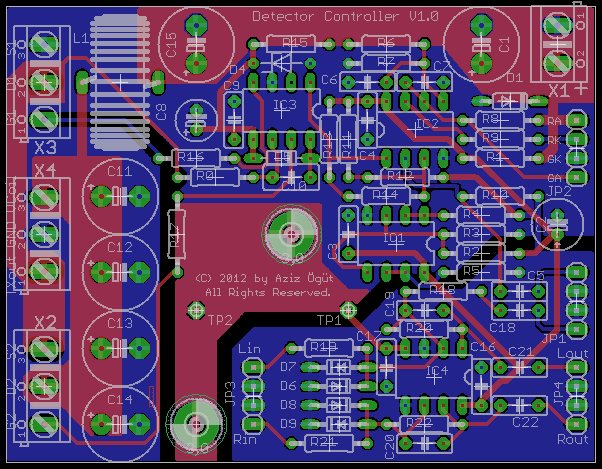

                        • PCB Layout (Preliminary Version)
                          Hi all,
                          this is the first version of the PCB layout. I'm not happy. Unfortunately, it does not fit four times into a 160 mm x 100 mm Euro size format. I thought, I could get four PCB's for the price of one EURO-format PCB manufacturing.
                          Well, I'll think of it further..
                          Aziz
                          • Hi Aziz,
                            Why not go for surface mount components where possible?
                            Are you going to make the boards yourself at home or send them off for manufacturing?
                            If I can make my own smt 3 layer boards at home I see no reason why you can't There is a lot less drilling using surface mount.
                            Nice job on the board btw....
                            Cheers Mick
                            Just re-read your post and you are sending them off. Go SMT!
                            • Originally posted by Mechanic View Post
                              Hi Aziz,
                              Cheers Mick
                              Hi Mick,
                              the reason, why I don't go for SMT board is simple: the price & availability.
                              I want to realise this project as cheap as possible and as easy as possible with through hole PCB. SMT devices aren't available everywhere too. SMT is very trivial and I have made several projects before (including professional PCB manufacturing). But I'm following strictly the K.I.S.S.-principle however.
                              The current PCB has two layers and is not intended to make it DIY. It is intended for professional manufacturing only. BTW, I can't do it by myself.
                              Well, if someone wants to make the SMT PCB, I will provide the Eagle files (zipped current preliminary stage). BTW, the current PCB layout is purely the output of the auto router! There is a Eagle script file to make it:
                              mytinybrd-autoroute.scr (run this script for the PCB board and press always yes button)
                              Code:
                              # Tiny Board Autoroute script
                              # Auto route supply signals first
                              rip;
                              rats;
                              rip;
                              auto vcoil;
                              auto vb;
                              auto clk;
                              auto vcc;
                              auto txout;
                              ripup gnd;
                              auto;
                              auto;
                              #Window Fit;
                              move
                              Not bad outcome. The PCB is optimized for my small and very cheap plastic case (1 EUR only!).
                              Cheers,
                              Aziz
