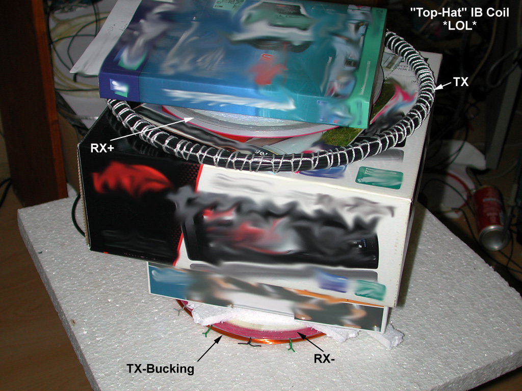

  • Can ya see it? The "Top-Hat" coil?
    But the beast is super quiet. I have to make it a little bit rigid.
    Cheers,
    Aziz

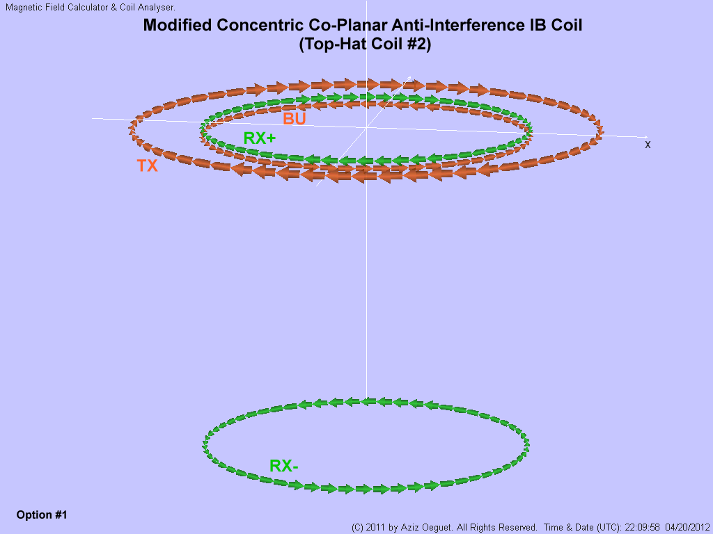

      • More Anti-Interference IB Coil Ideas
        Ya wanna have more anti-interference IB coil ideas (or inventions)?
        Stay tuned ...
        Aziz
        Ok, eat this:
        #1 (main course, yummy, yummy):
        Just exchange the coil position of RX+ and RX-/TX-Bucking coil bundle in the "top hat" coil design showed in post #1366 (http://www.geotech1.com/forums/showp...postcount=1366) and invert the winding orientation of the TX-Bucking coil so it opposes the TX coil winding orientation. This is a typical modified standard concentric co-planar IB coil with the anti RX coil placed above the coil embodiment. Fine balance with distance variation of anti RX coil.
        That's an "old hat" idea and not a "top hat". Hey, but it's looking like a "top hat" coil again.
        Anyway, it improves the standard concentric co-planar IB coil due to the fact, that the bucking coil turns count gets slightly lesser (not much, a tad). Full anti-interference feature due to identical RX+/RX- coils. This coil is easy to build and balance as well.
        Modifying an existing concentric co-planar IB-coil doesn't make sense as the bucking coil therein needs a tad less turns count. But you could put an extra turn (or two) of TX coil outside the coil embodiment edge and could try the modification.

        • This is what I mean with option #1. It's just a standard concentric co-planar coil with additional anti RX coil.
          Aziz

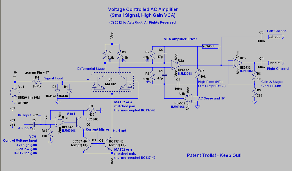

          • VCA
            Hi all,
            I'll try a different pre-amplifier front-end: the voltage controlled amplifier (VCA) .
            I do have a very low noise discrete VCA solution and want to try it. The controlling voltage is fed from the other sound card ouput line (instead of input compensation). Let's see how this works. Unfortunately, it doesn't fit into the PCB space. It requires more parts of course. This is just for my own curiosity.
            Cheers,
            Aziz

                  • Sharing Ideas Is Good!
                    Hi all,
                    this is the voltage controlled amplifier (VCA) I want to try out soon (see below). Notice, it is a small signal high gain VCA. A second amplifier stage is added and is sent to the right channel.
                    The controlling voltage is fed from the right line output channel of the sound card. Well, it is an AC controll voltage so I want to use the AC input. Note, positive control voltage disables the VCA (no collector current flowing) und is good for masking out unwanted signals.
                    Who wants to have the LTSpice-file to play with?
                    Cheers,
                    Aziz
                    PS: It is a low noise design. ;-)

                    • This is waaaay too complex for my taste.
                      BTW, since you played with a true discrete differential amp, here acting as VCA, it is a sacrilege wasting a perfectly good symmetrical input for ground connection.
                      There is a VCA solution with FET optocoupler that is supposed to work nice, and there are solutions with OTA. OK, your solution here is not unlike OTA, and is probably much better regarding noise. Then again - what noise? I'd go for OTA.

                        True, but...
                        the other solutions can't beat it in regards to noise, stability, accuracy, BW, AC capability... And you can use here simple matched transistor pairs too.
                        The VCA can achieve 1.2 nV/sqrt(Hz) input referred noise density in the configuration above.
                        I'm open for further suggestions. Any better solutions there?

                        • Take a peek: http://www.edn.com/article/520604-Us...entiometer.php
                          For VCA purposes it can be made even simpler.
                            Unuseable due to the critical demands for a low noise pre-amp stage. Too slow. Too noisy. Gain can't be below one (or zero).
                            The VCA I have presented is the best and cheapest solution (with matched BC337-40 transistor pairs) to the desired demands. And it is versatile.
                            Another solution?
                            Aziz

                              • How about this for an VCA: http://www.edn.com/contents/images/91699di.pdf
                                Scroll down to an "analog multiplier..." part and enjoy. It is not yet THE thing that you asked for but has a potential to become one. It can also be made with discrete components, and it is incredibly fast.
                                I think this can become a platform for applying various weighting functions against PI signals and see what comes out of it.
