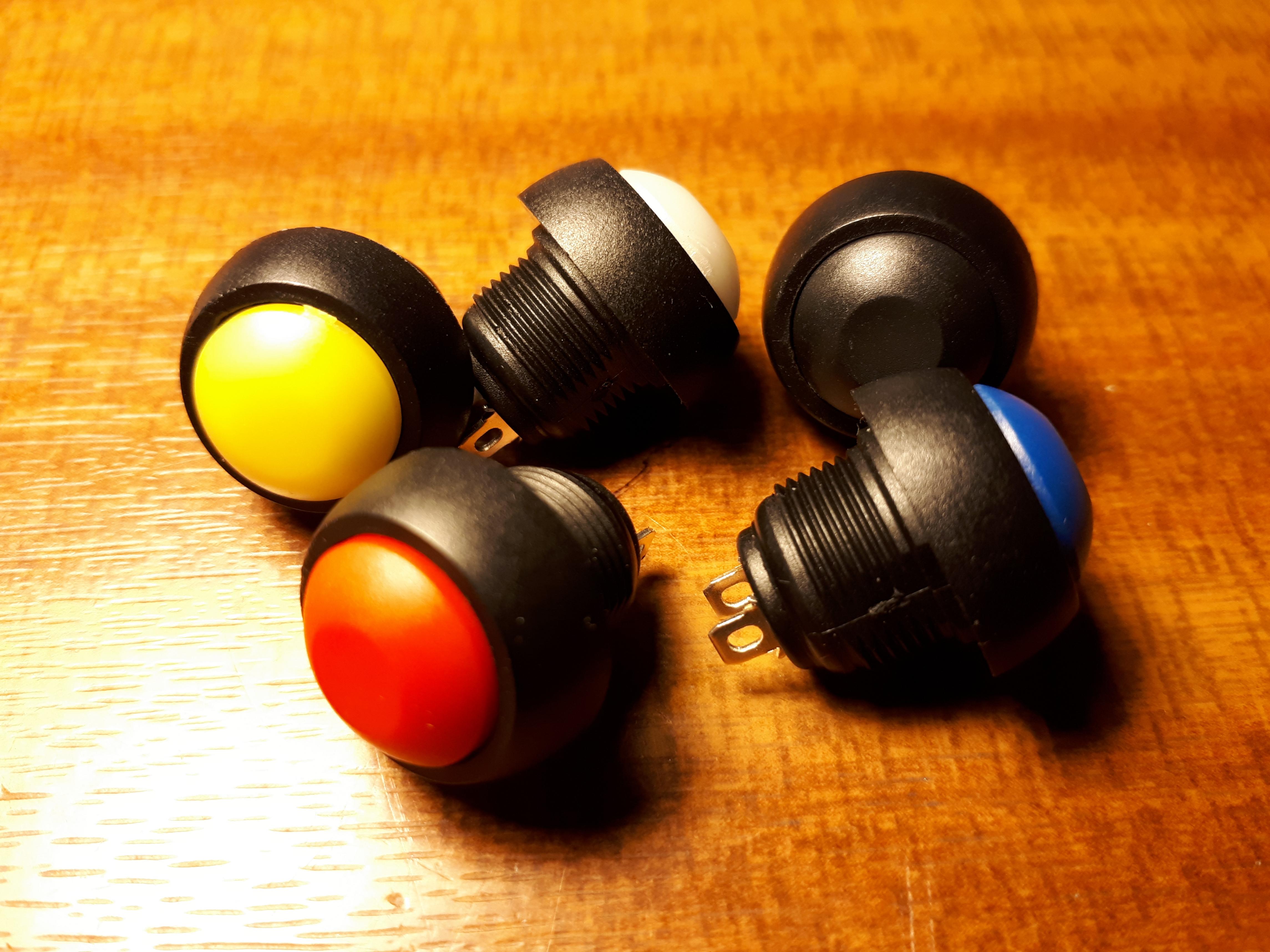

              @Qiaozhi,,Thanks for the answers on the questions. Another uestion I have is, For the 'Button' board (LCD and Buttons) is there a separate PCB board for it to download to make please? Thanks for uploading the Hexfile Regards, Marty.
              There is no specific board for the push buttons. I simply wired directly into the back of the buttons.
              The ones I used came from Amazon ->
              https://www.amazon.co.uk/gp/product/...?ie=UTF8&psc=1

                • @Phantom,,,Thanks for the reply. @Qiaozhi,,,Thanks for the info and link on the Buttons. It'll make it much easier for me to make an LCD Enclosure that way. I'm only missing the mosfets and the PCB now then I can begin building. Can't wait to begin this very interesting, very 'Busy' project!,,Regards, Marty.

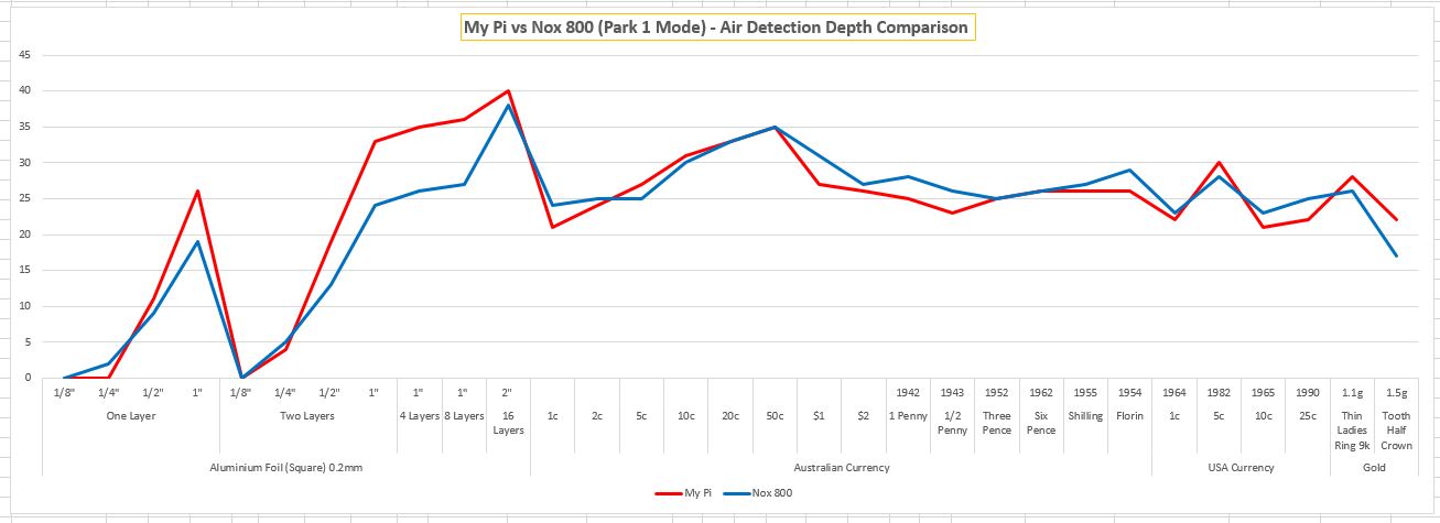

                        • Can you give us an idea of real world performance compared to the best PI detectors on this forum?
                          Rick

                            • Originally posted by rickb View Post
                              Rick
                              Depth comparison chart for my pi machine vs Equinox 800, as a starting point.
Name:	Depth Comparison.JPG
                              • Originally posted by Elliot View Post
                                [ATTACH]53510[/ATTACH]
                                Coil size, construction ?
