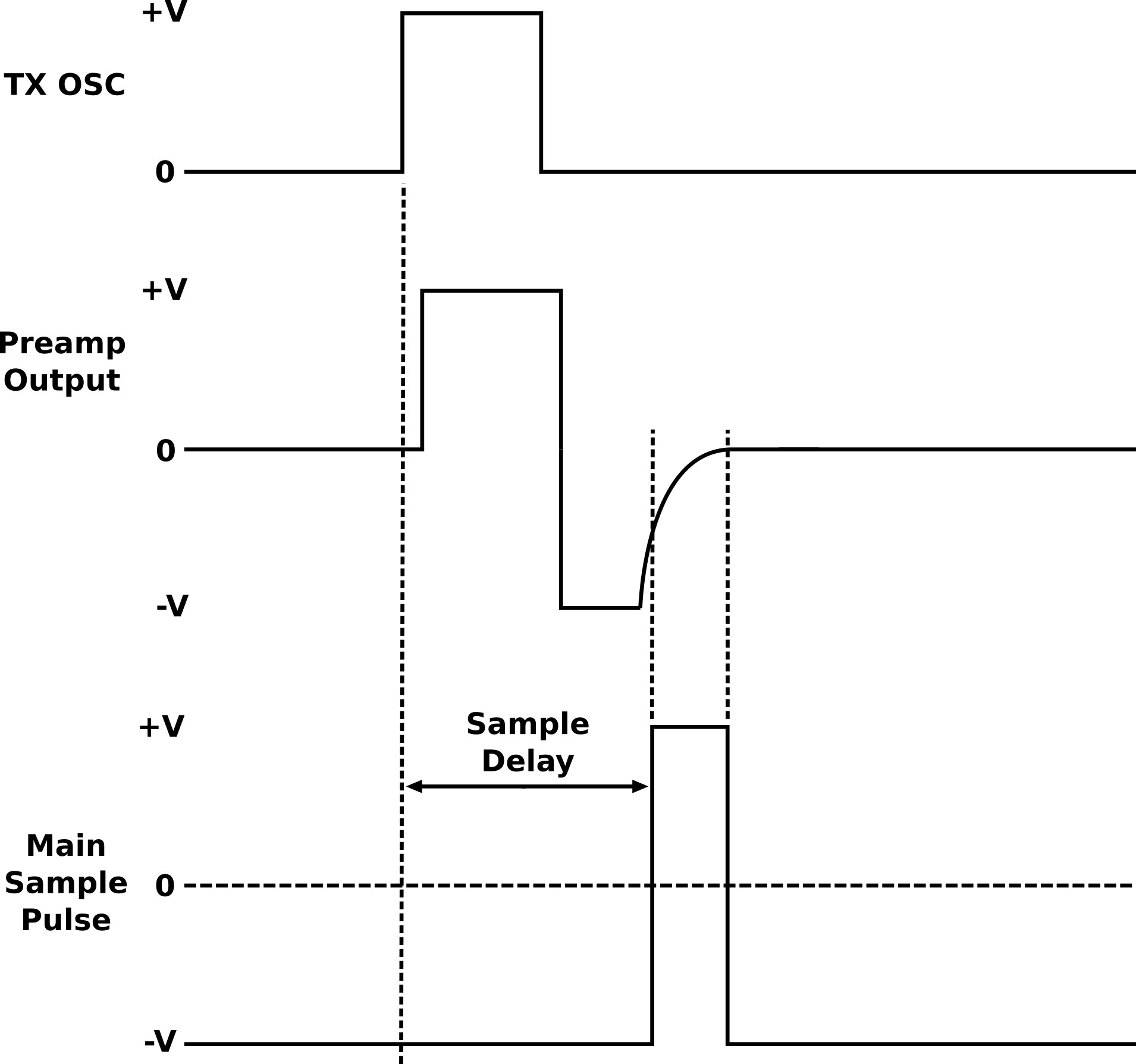

      I'd like to know the details of the signal present on pin 2 of U3 (NE5532) if possible...
      everybody says we are working with microvolts but what kind of signal is it actually?
      • Originally posted by nixie View Post
        Have a look at the attached image.
        The main sample pulse captures a section of the preamp output on each TX cycle and puts it through an integrator. This produces a dc level that increases in the presence of a metal target. You will only see a signal change at the input of the preamp if the metal target is close to the coil, as the changes may only be a few microvolts for small targets or those far from the coil.
        Try monitoring the preamp output on an oscilloscope using channel 2 (while triggering channel 1 on the falling edge of the TX pulse) and bring a relatively large metal target towards the coil. Note that the rising edge (where sampling takes place) moves towards the right. This will cause the sample pulse to see a signal that becomes more negative.
        Then try the same procedure with a small coin at a distance that causes a weak audio response. I guarantee that you will not be able to see any movement in the preamp output, but the detector is still able to extract this miniscule change. Since the signal change at the preamp output cannot be detected visually on the scope, you will definitely not see any change at the input.

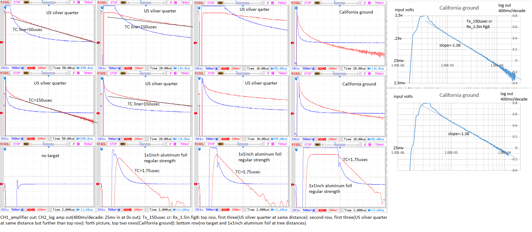

                Scope pictures of a couple targets at different distances from the coil. Amplifier out, linear and log amplitude. Amplifier gain=500. Scope time base varied depending on target, 2us to 50us/div.
