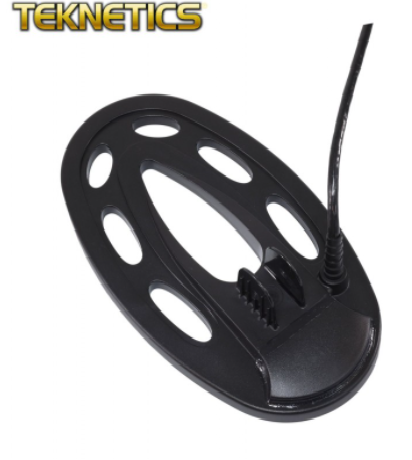

ID:	361621Hi I wanted to ask the Gurus of the Forum, I have a Teknetics concentric coil for Omega 8000, with the TX 0.874 mH coil and the rx 8.74mH coil, can I use it for tests on the MD Voodoo? Thank you for your answer.

          [ATTACH]55555[/ATTACH]Hi I wanted to ask the Gurus of the Forum, I have a Teknetics concentric coil for Omega 8000, with the TX 0.874 mH coil and the rx 8.74mH coil, can I use it for tests on the MD Voodoo? Thank you for your answer.
          The TX inductance is on the high side at 874uH, but still lower than the Troy (1.12mH) and Tesoro (982uH) coils that were tested, so it should be OK.
          Have a look at Table 6-1 on page 75 for a comparison.
