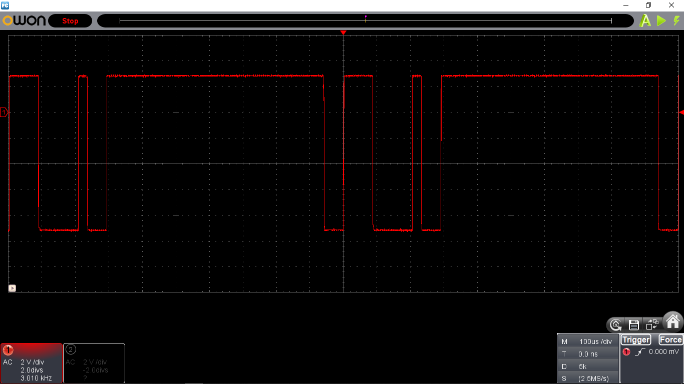

                • If you have a pulse on TP9 then probe the collector of Q5. It should be an inverted version of the same waveform. Then probe the collector of Q6 (with R48 installed), it should be the same waveform as TP9. Recheck Q5 & Q6, make absolutely sure they PNP & NPN, and make sure of the pinout. Some transistors are EBC, some CEB. It's likely you have a wrong transistor, wrong pinout, or blown transistor.

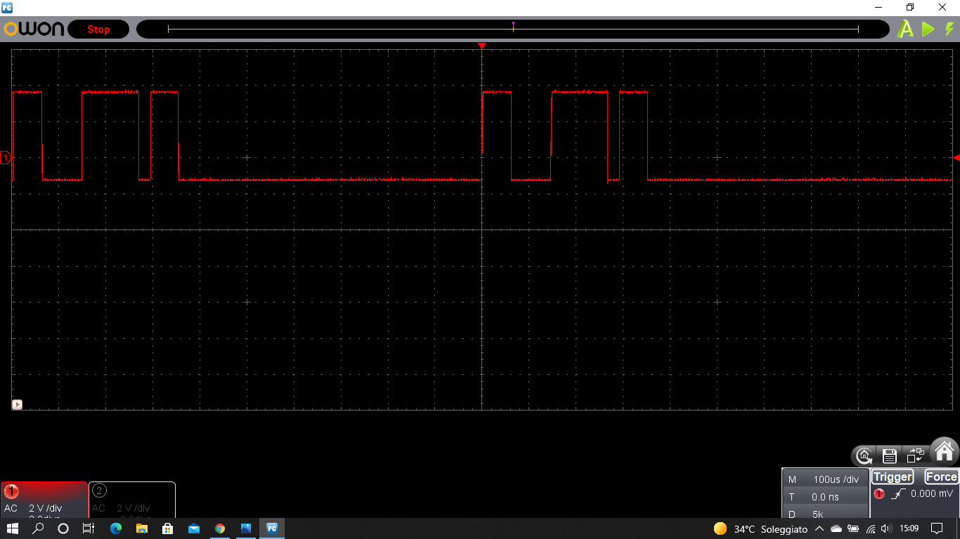

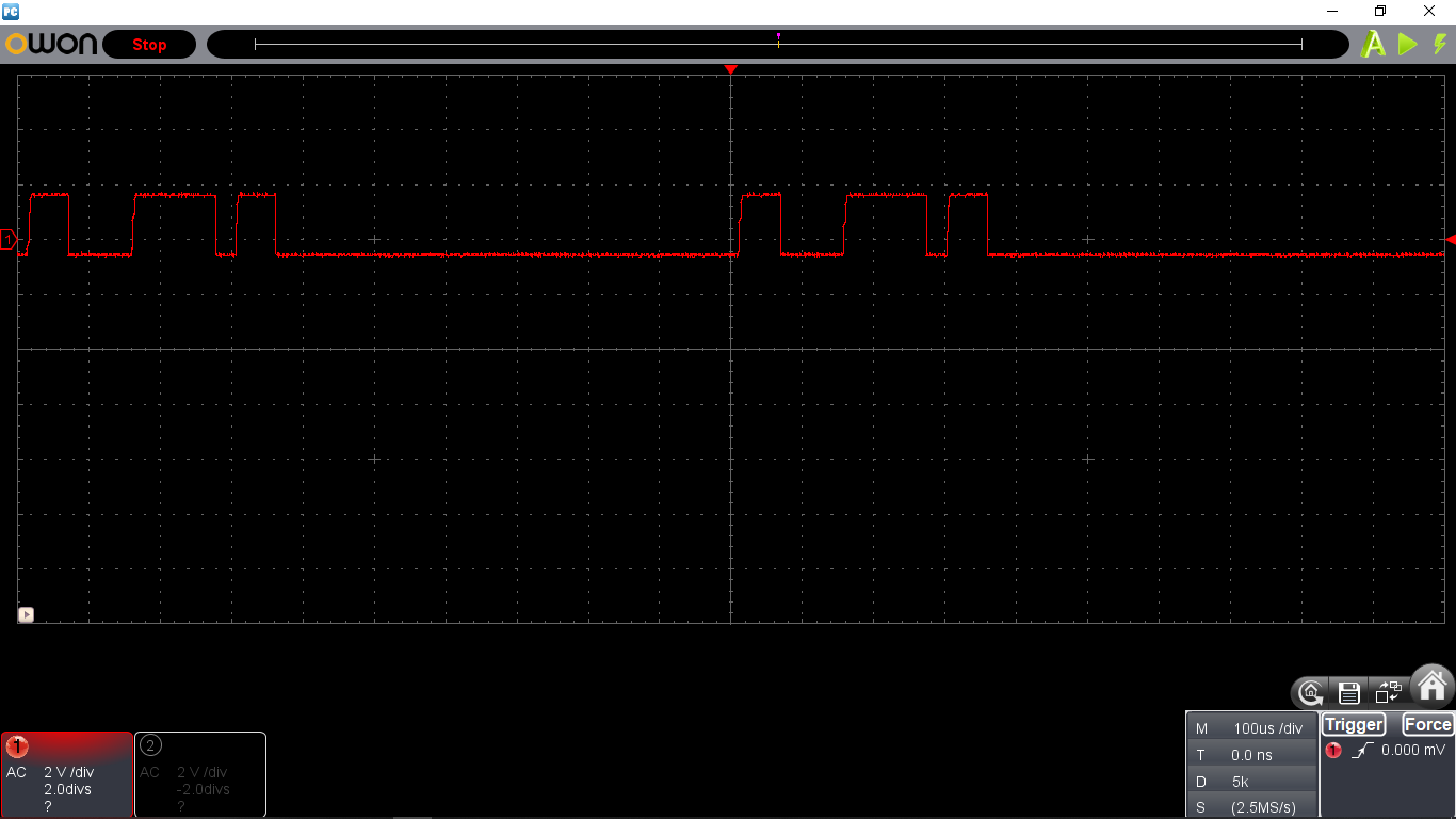

                        • Hi Mr. Carl and Mr. George good evening, as promised I carried out your suggestions, without the R48 I tested the TP9 as per file n.1, then I tested the collector of transistor Q5 as per file n.2, last I inserted the R48 and tested the manifold of the Q6 as per file n.3. I changed the 79l05 - 78l05 - Q5 and Q6, but the result does not change, on the TP 14 I read -5, and on the TP15 +0.85. The 79l05 heats up and the 78l05 no. I don't know where to look. Thank you for your patience.Click image for larger version

                          • Originally posted by dgm View Post
                            Hi Mr. Carl and Mr. George good evening, as promised I carried out your suggestions, without the R48 I tested the TP9 as per file n.1, then I tested the collector of transistor Q5 as per file n.2, last I inserted the R48 and tested the manifold of the Q6 as per file n.3. I changed the 79l05 - 78l05 - Q5 and Q6, but the result does not change, on the TP 14 I read -5, and on the TP15 +0.85. The 79l05 heats up and the 78l05 no. I don't know where to look. Thank you for your patience.[ATTACH]55862[/ATTACH][ATTACH]55863[/ATTACH][ATTACH]55864[/ATTACH]
                            If you remove the 78L05, what voltage is present on the cathode of D6?
                            • On the cathode D6 11,7 volt.
                              • In that case the LT105 appears to be working. There must be something loading the 78L05.
