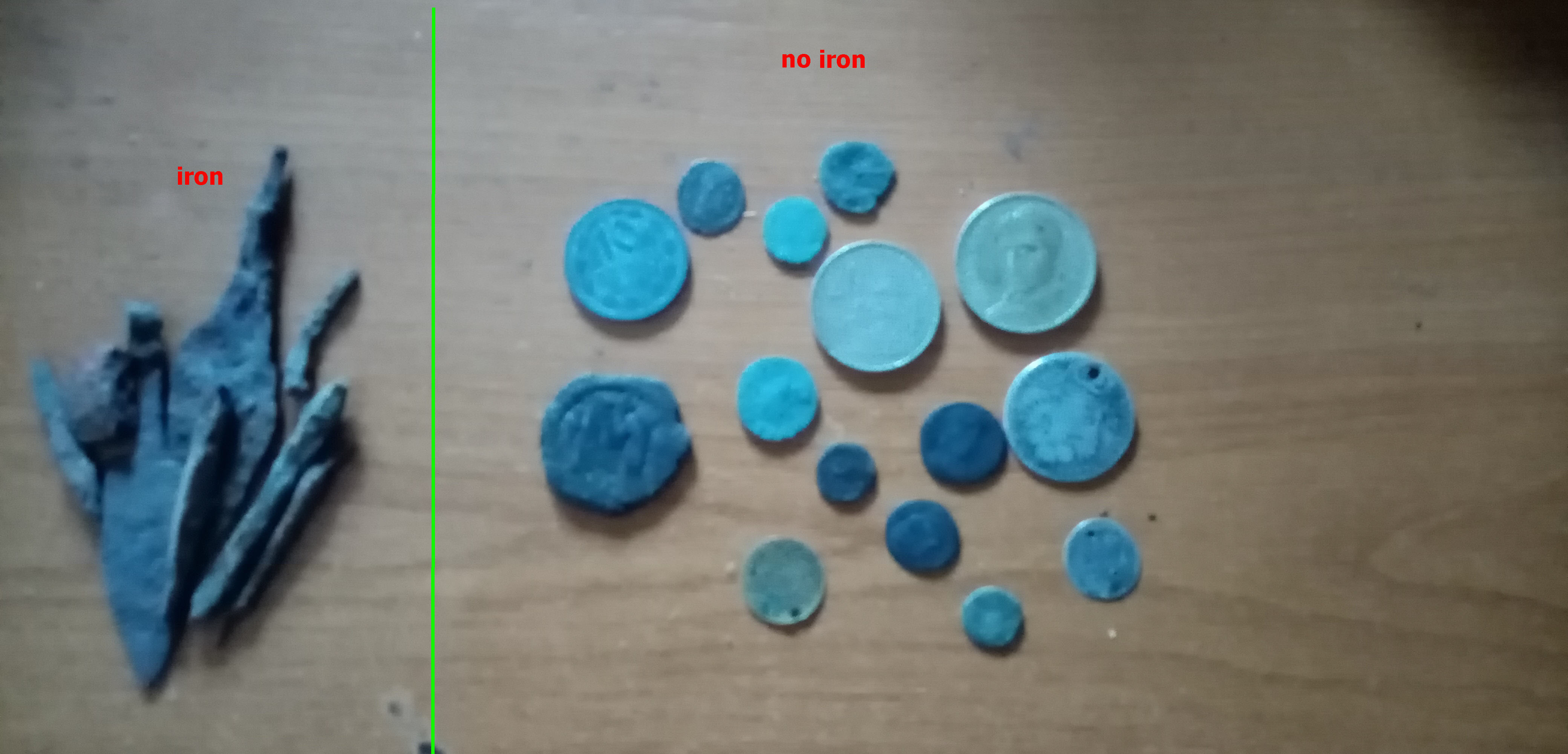

  • Yes of course , this one may also have a different audio response on the iron that there is no sound or to have two tons or to leave a trace like gpx I will post a video these days , and I listed the TDI because the sound is nice and quiet threshold he also has some advantages in some situations.. In the first test at 20 euro cents I am quite happy with the depth the money is buried at 35 cm and detects it very easily the field where I test is full of iron waste, all the iron is discarded without any problems..I won't have time at the moment, but maybe I'll put TDI audio on this detector over the winter.

          Hi Altra !That it is completely calm has also been tested on the beach and in heavily mineralized areas he works completely calmly everywhere works with all minelab coils dd and mono as well as with the explorer coil ...Balancing works without problems!It can also have audio sound like minelab but to be quick it has this sound...Click image for larger version

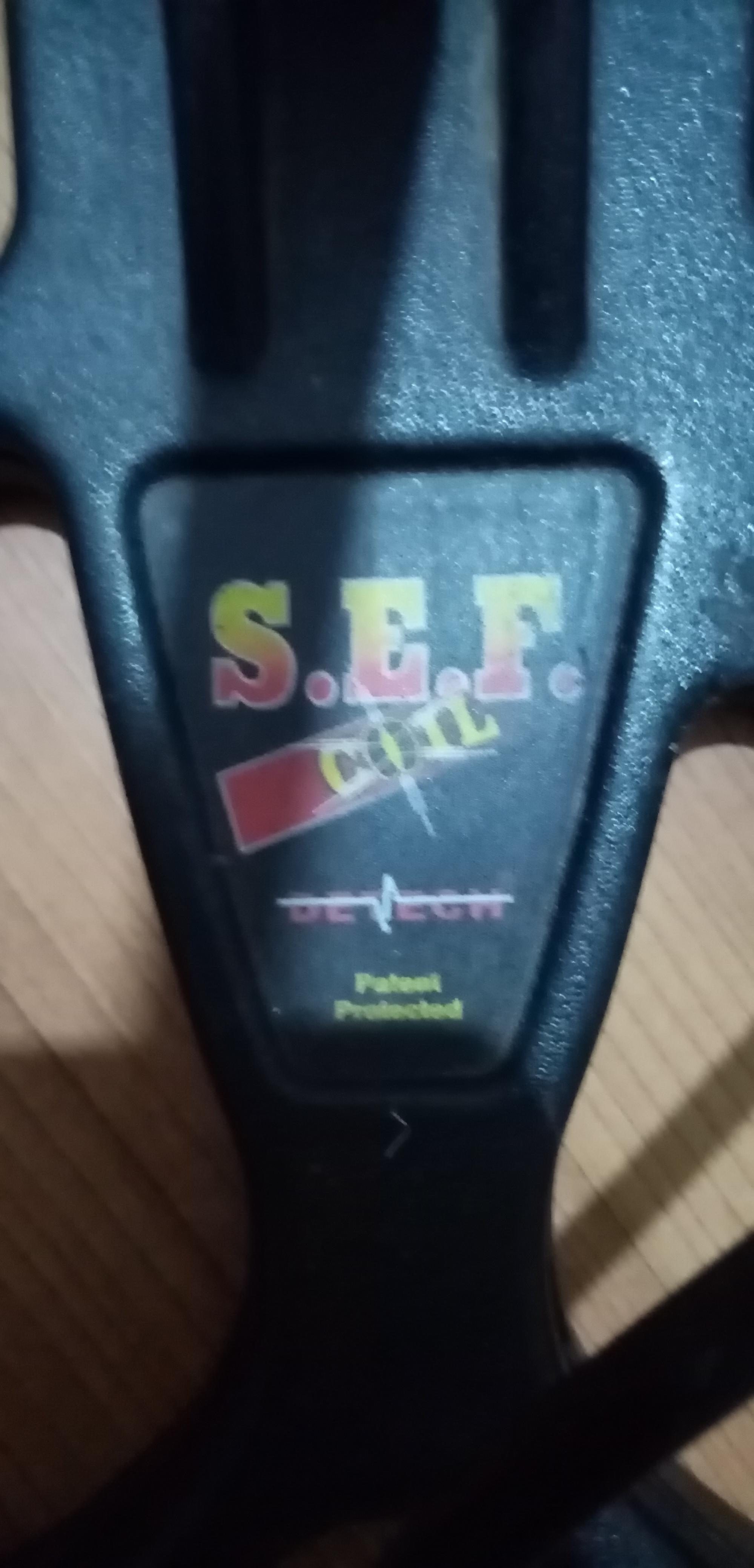

          • Hey Orbit, what coil are you using in your videos? Thanks!
            • Originally posted by yatahaze323 View Post
              . Sef coil... Click image for larger version
ID:	361883 coil minelab explorer
