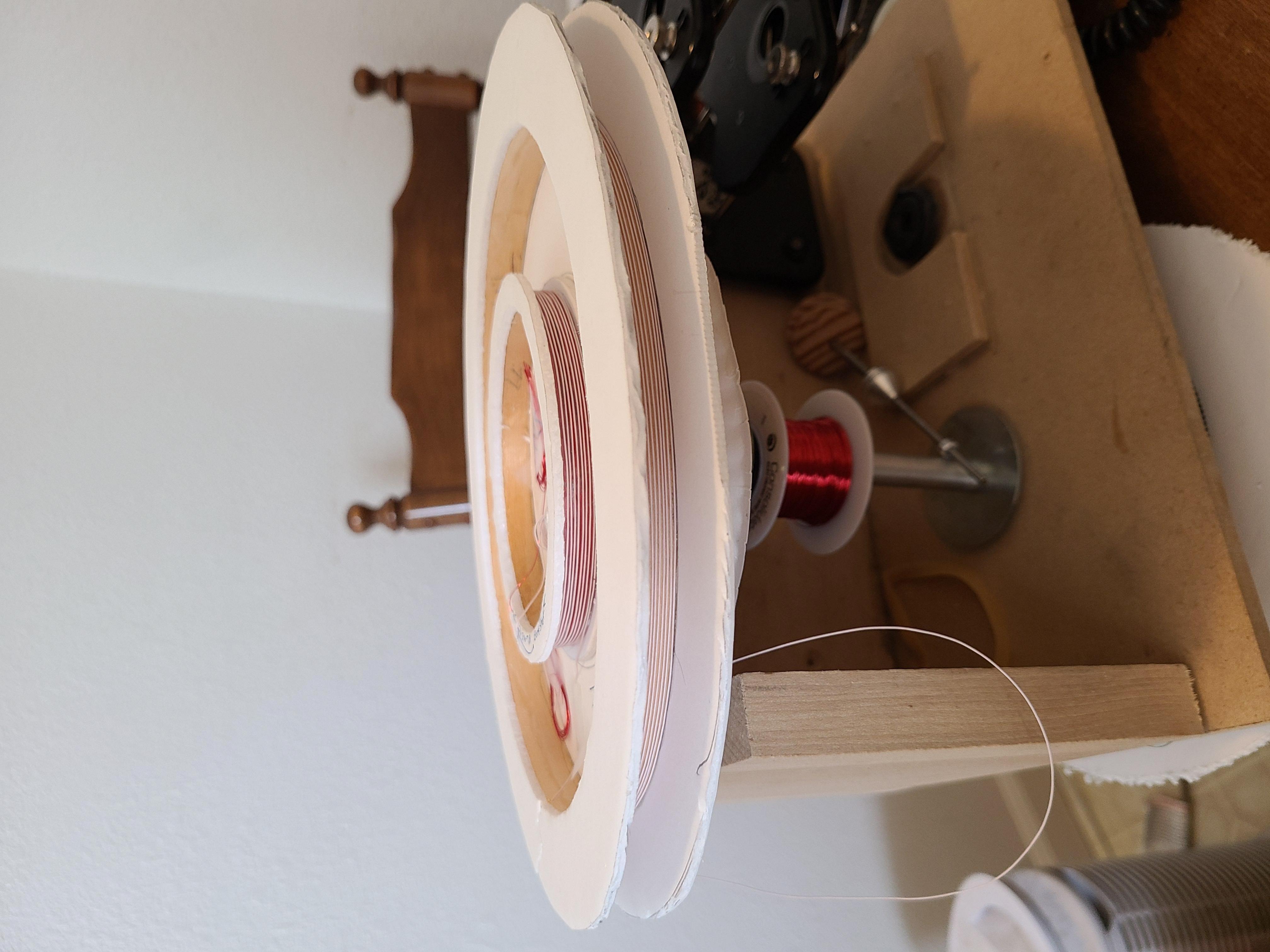

                  For the inner coil I was thinking a vertical stacked layered planer coil with the bucking coil made on a paper form that will slide on the outer surface for nulling. Thinking 350 uh outer not sure about the inner coil yet but thinking of staying below 2mH.

                        • Hi Marty,
Name:	verticle stack concentric.jpg
                          this is the first one Ive built, in the picture everything is over wrapped a few turns.
                          Final #s are 30 awg 40/46 wire 27 turns 4" I.D
                          Tx 385uh Rx 2.04nH. 30 awg magnet wire. 8" I.D
                          Bucking coil ended up 6and about 34 turns with a final null at 0 to 800uV.
                          One down .
                          • That's 8 inch Tx 4 "Rx
                            Sorry
