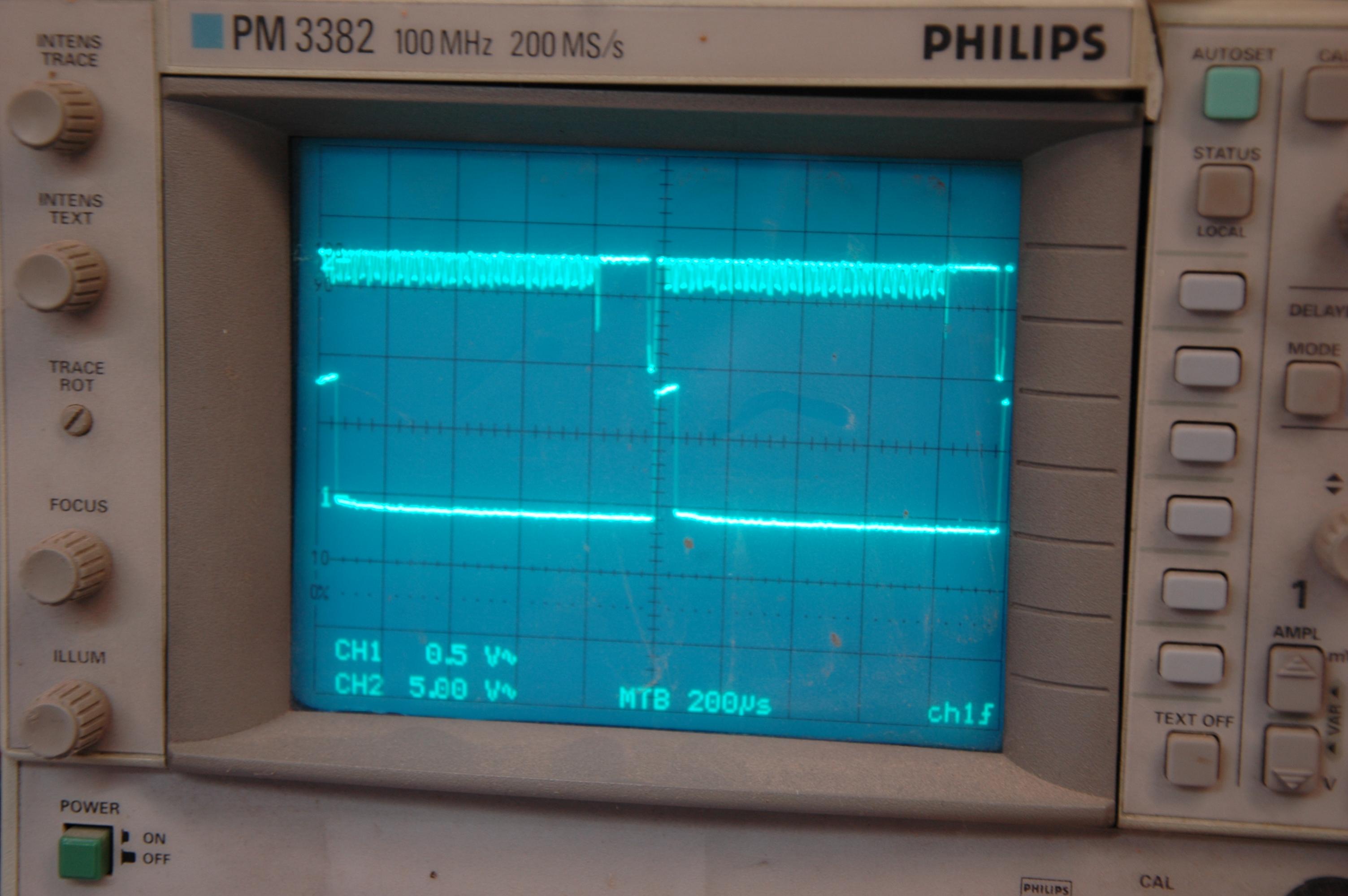

        Here are the measurements, I used my adjustment potentiometer. the measurement on tp3.

        but even now, the detector emits a lot of beep beep beep between each passage of target ...

          I would have expected around 680R for the damping resistor, so that looks good.
          The next thing to check is the main sample pulse alignment. See Fig. 3-19. If you try to sample too early, while the PI preamp output is still in saturation, the detector may become a bit jittery.

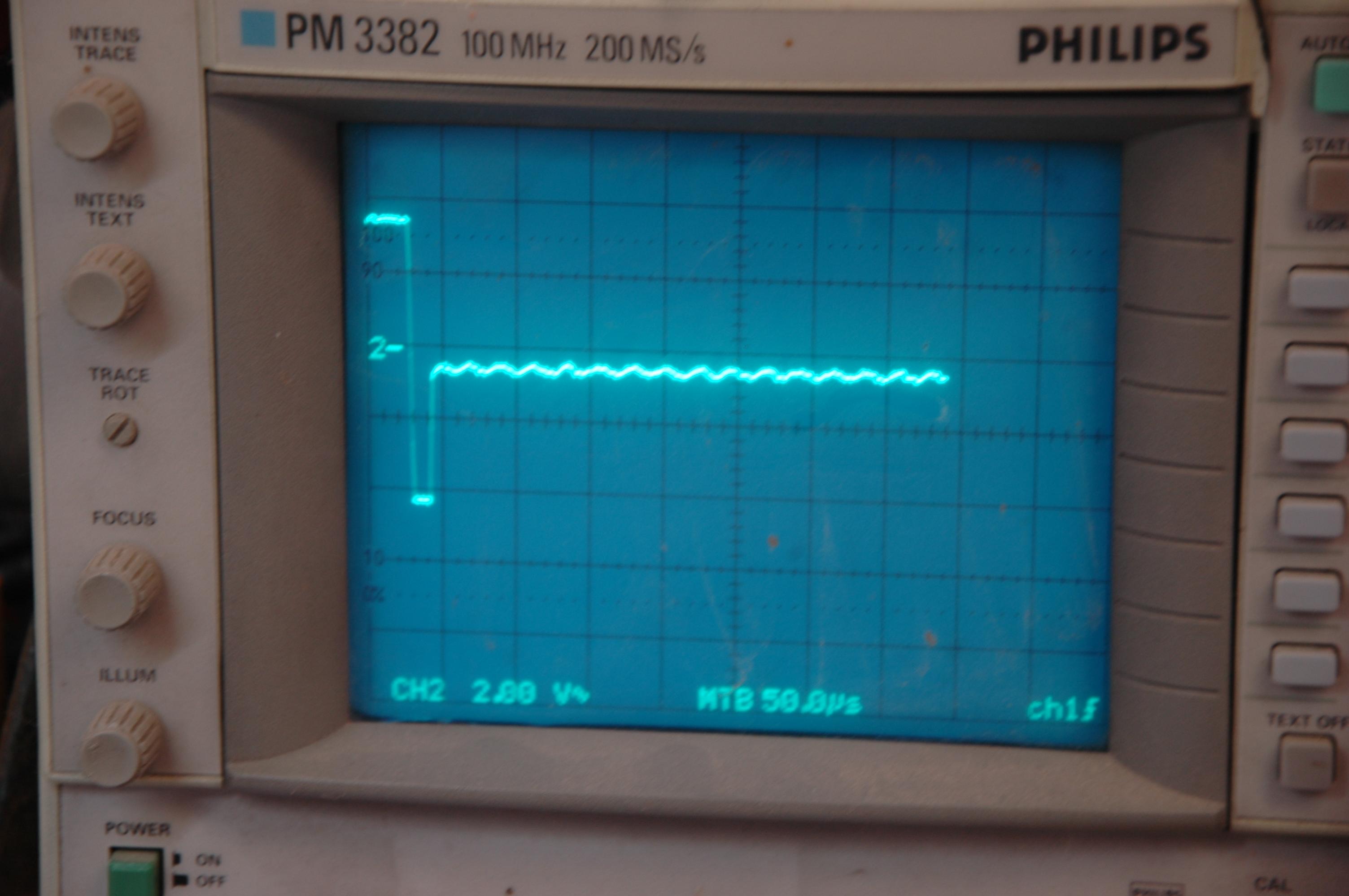

            fig 3-19 tp3 tp 11 what do you think?

                      • Originally posted by lamoiz View Post
                        [ATTACH]53813[/ATTACH]
                        Fig. 3-19 shows TP10 and TP3 (not TP11).
                        What you're showing is the DISC preamp output versus the main sample pulse (and that doesn't look correct anyway).
                        Can you show the PI preamp output versus the main sample pulse?
                            indeed I had to put the wrong photo ..oupss and obviously, Surf also made a file error !!! well I'll take a photo tomorrow ..tp3 tp10.

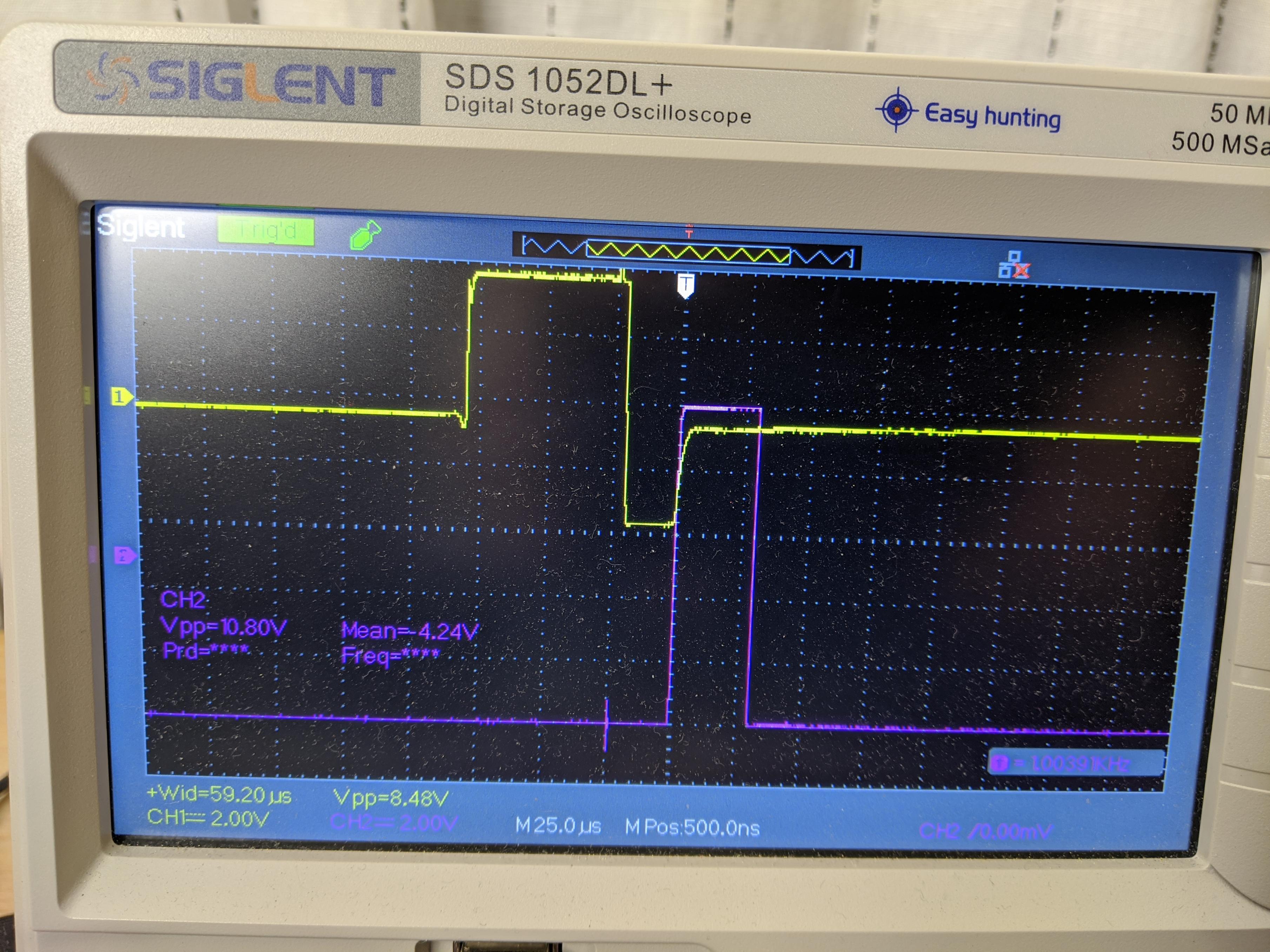

                            • TP10 versus TP3

                              This one might be better
                              • Originally posted by surfdetector View Post
                                [ATTACH]53824[/ATTACH]
                                That looks good.
