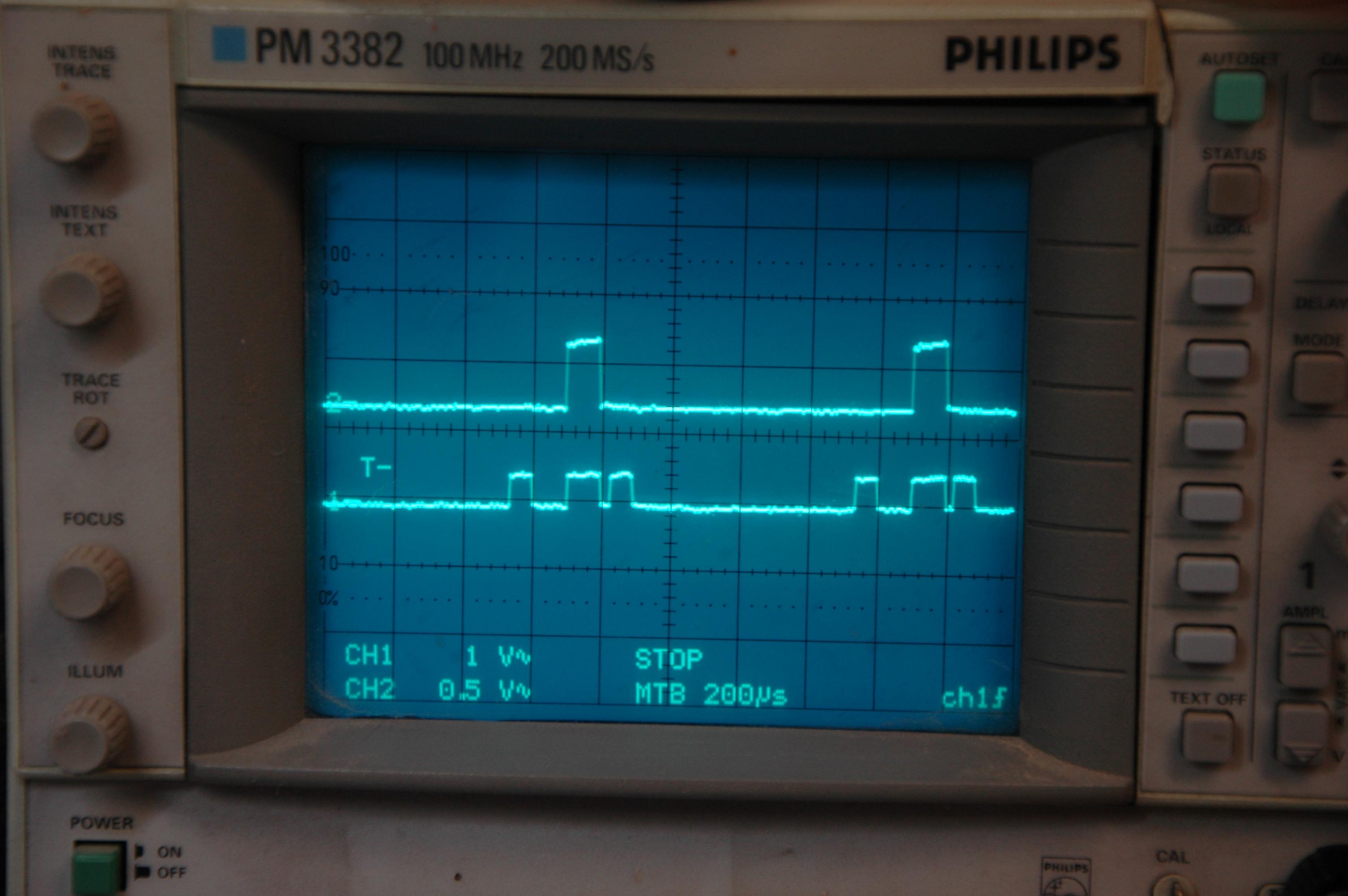

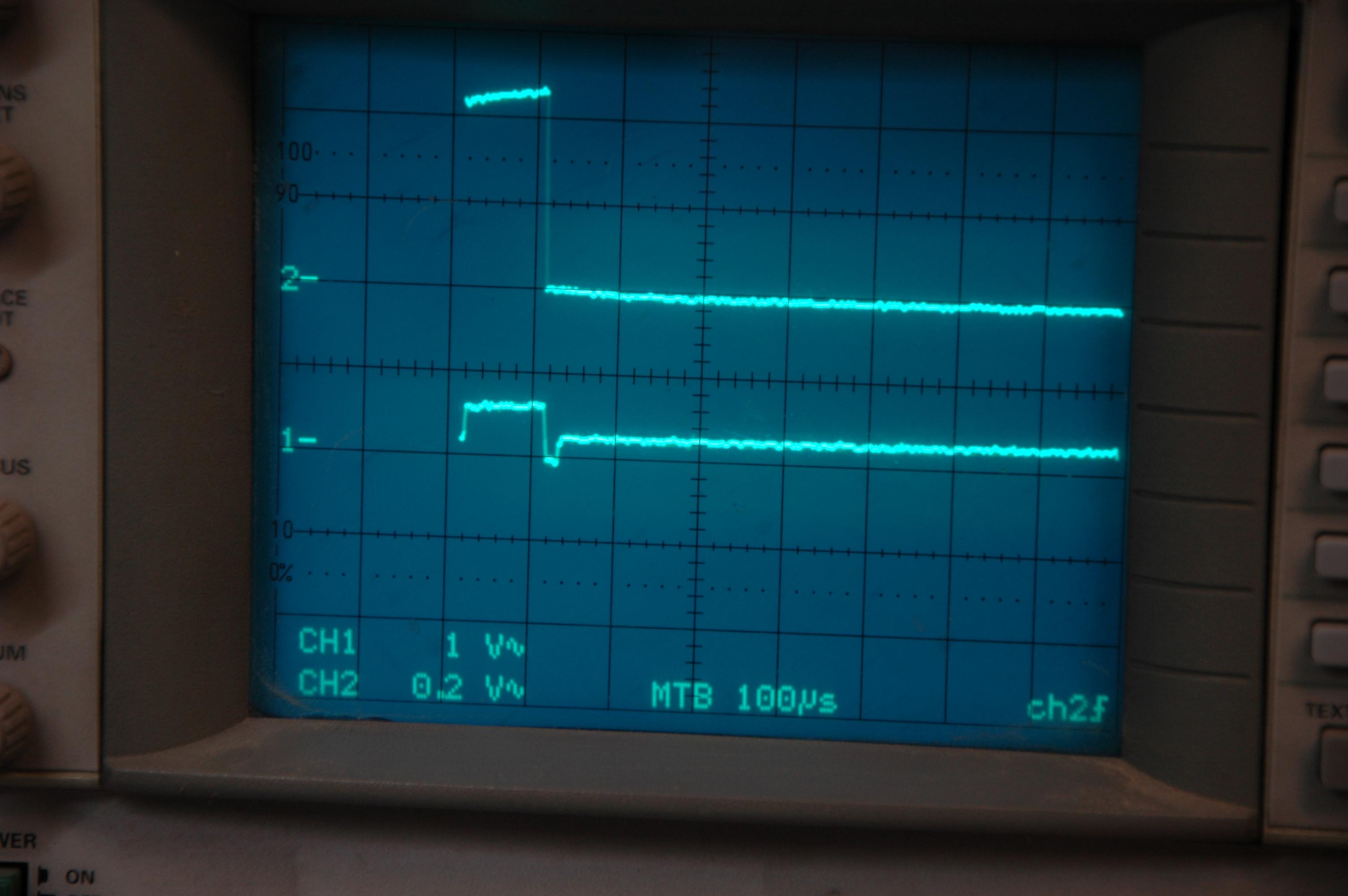

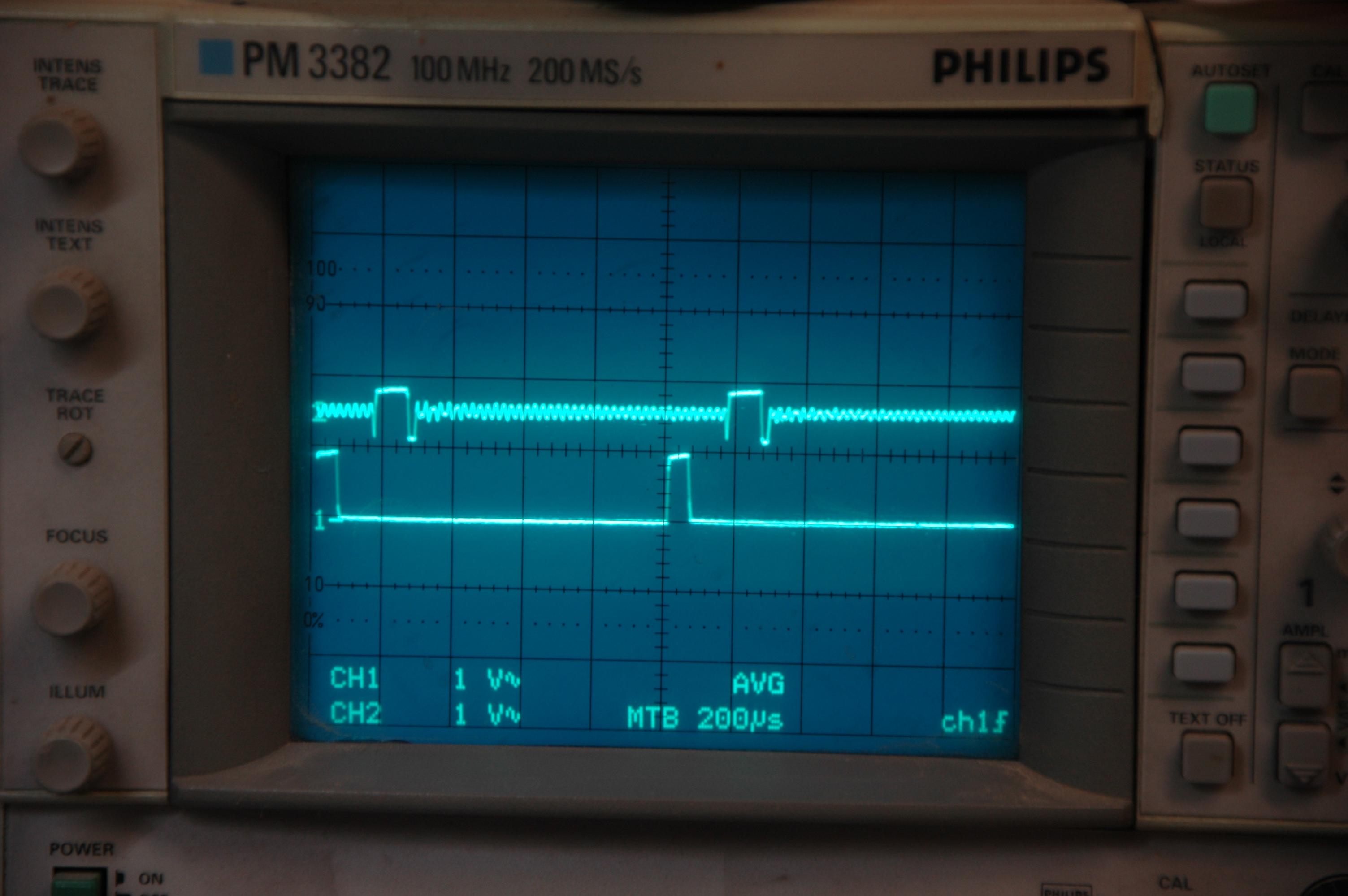

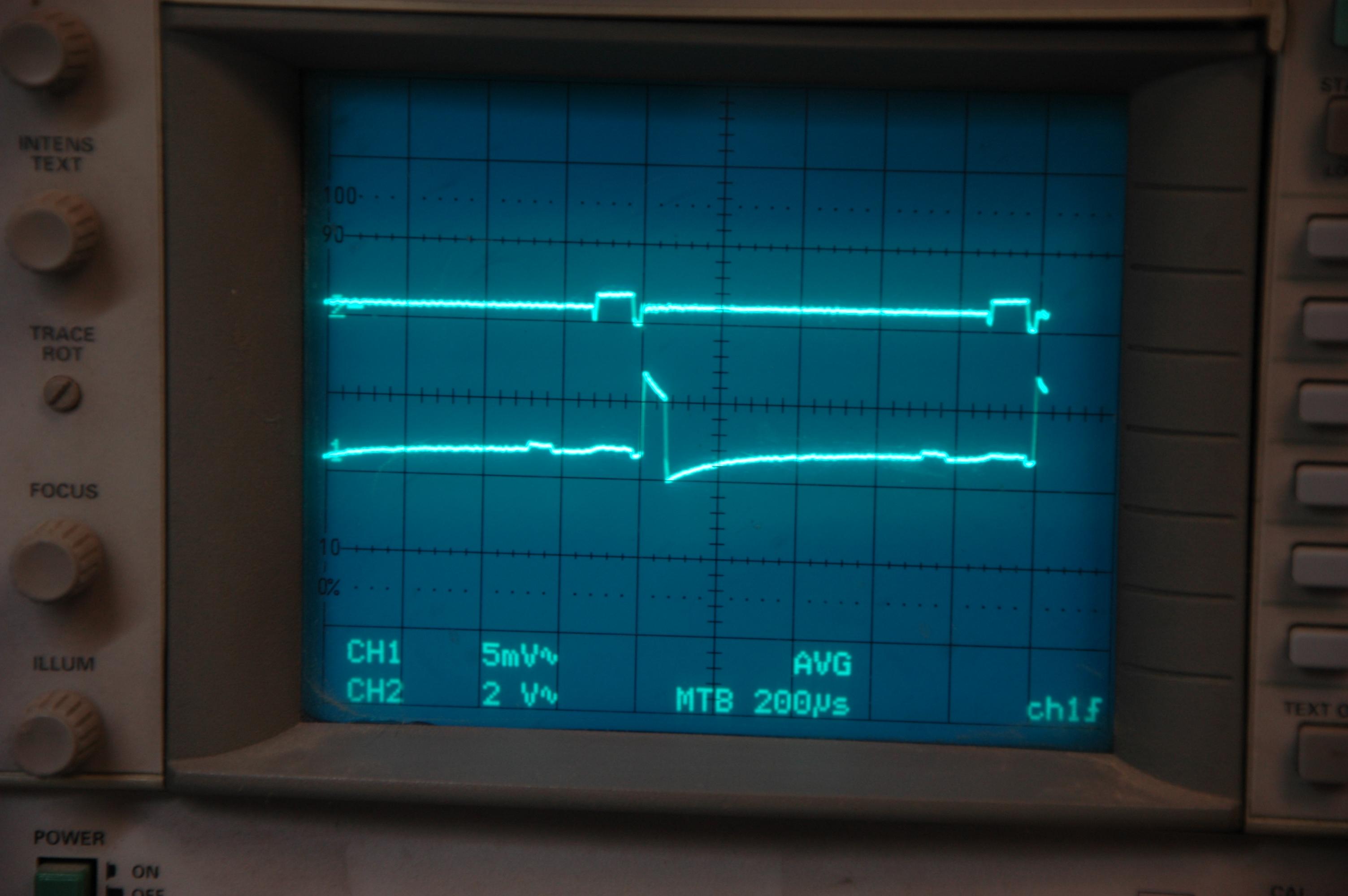

        Otherwise here are some pictures of the oscilo ..
ID:	358662tp5 tp2Click image for larger version
        a lot of noise on tp3 ..pff I don't know why ..

            George, I still have the beeps beeps beeps all the time .. do you have any idea where this could be?

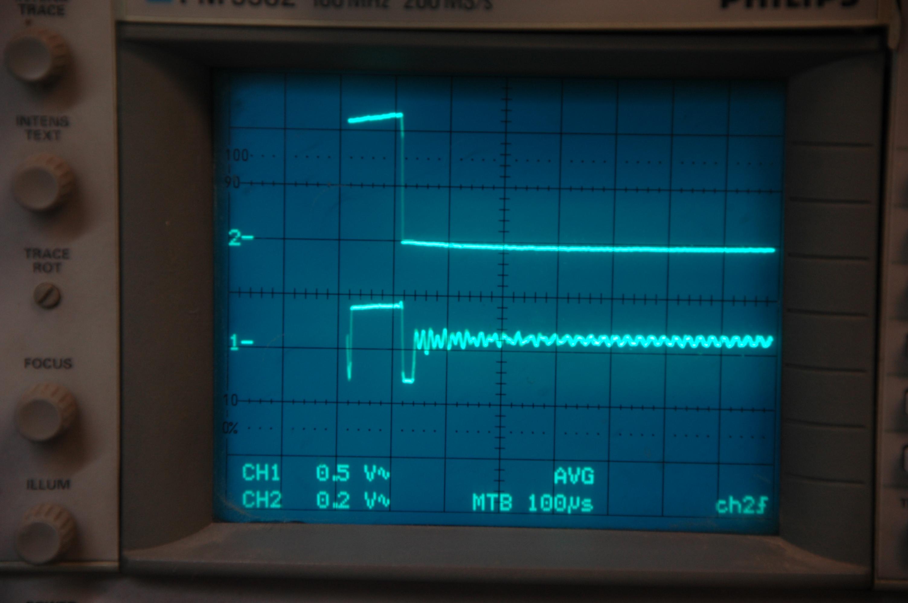

              I have completed my build on the bench. I need to wait for some parts and then I shall box up the project and take it out for a spin. I shall post a short video tomorrow on my YouTube channel of the project operating in Hybrid mode. I have attached a picture from the Disc pre-amp output which appears somewhat different than in the book. I am getting about 8" on a George VI penny and about 5" on a US nickle. More tweaking is needed, currently I have all settings in default and I am using a F75 coil.

                    what do you think of the tp3 measure? there is a lot of osciliation after the impultion .. no ??
                          Sorry to hear about the car accident. Hopefully no-one was injured.
                          Firstly - switch your scope channels from AC coupling to DC.
                          Secondly - do you have your scope probes set to x10? The amplitudes of the signals are both about 10 times smaller than expected.
                          Please change the settings and re-post the images.
                              [ATTACH]53849[/ATTACH]
                              Well done. That looks good.
                              The extra ringing is occurring during the TX-on time, and does not affect correct operation of the detector. Fig. 2-1 shows the result for a Troy coil, so the Fisher F75 coil may quite possibly be different.
