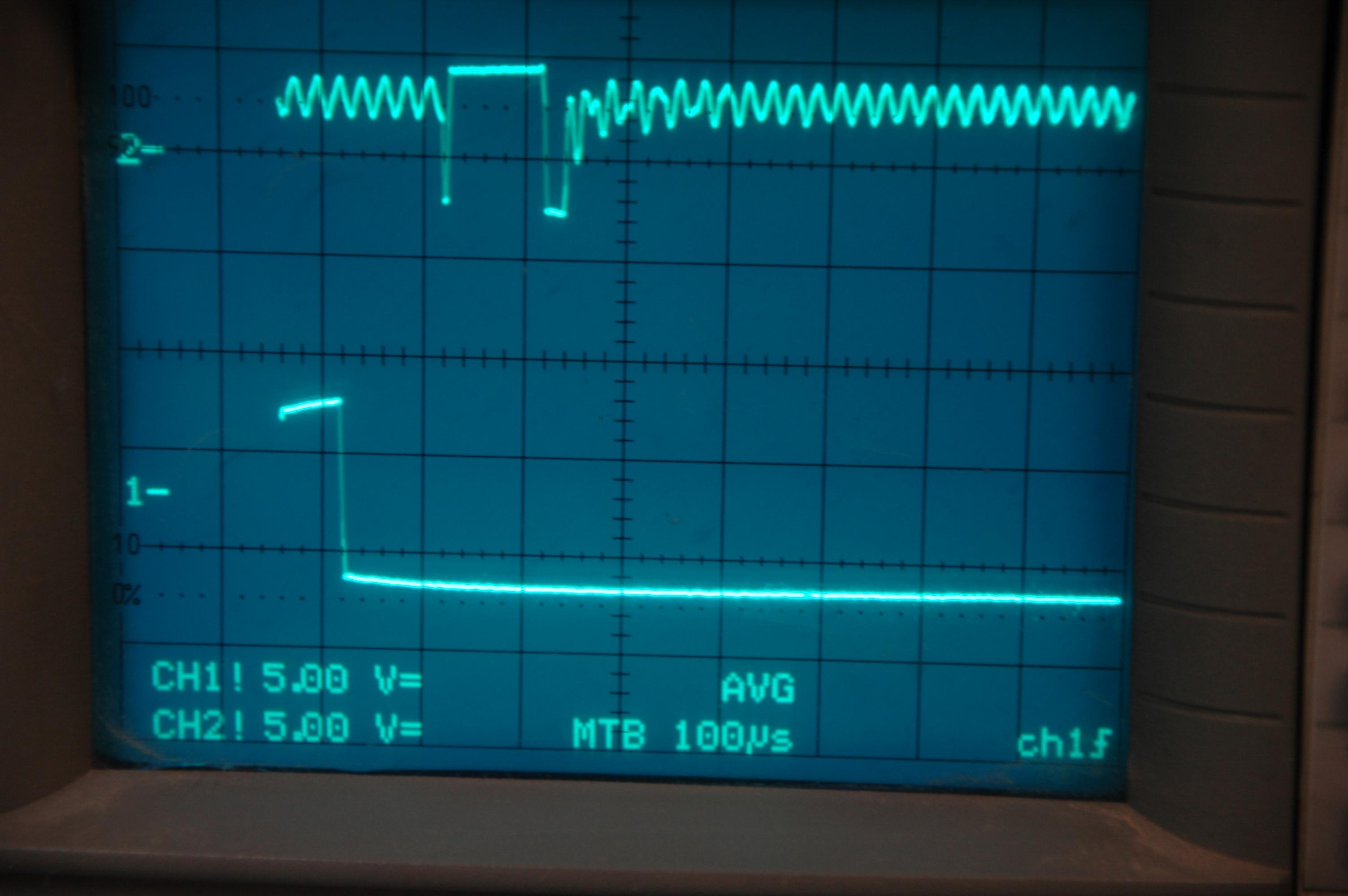

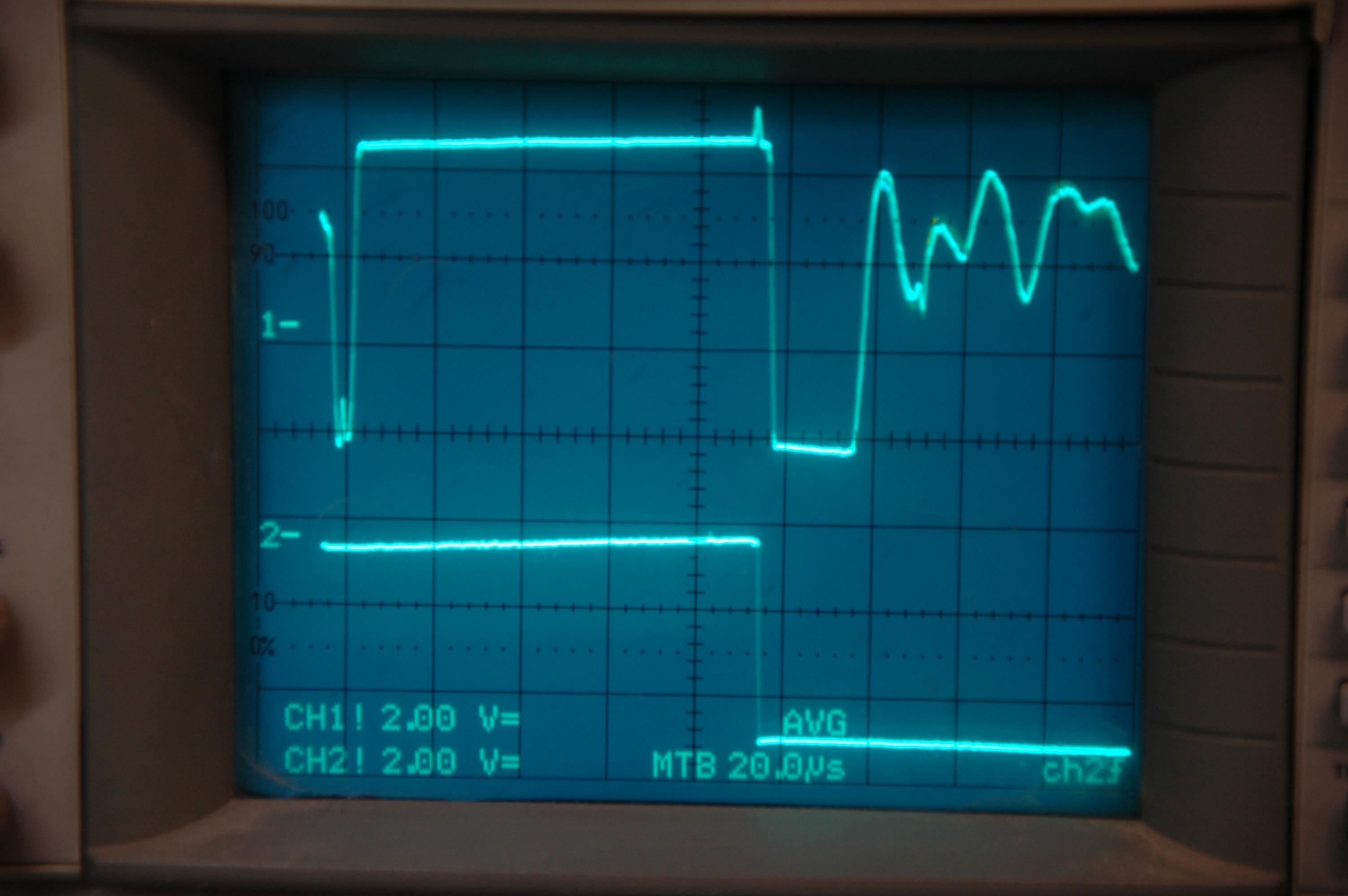

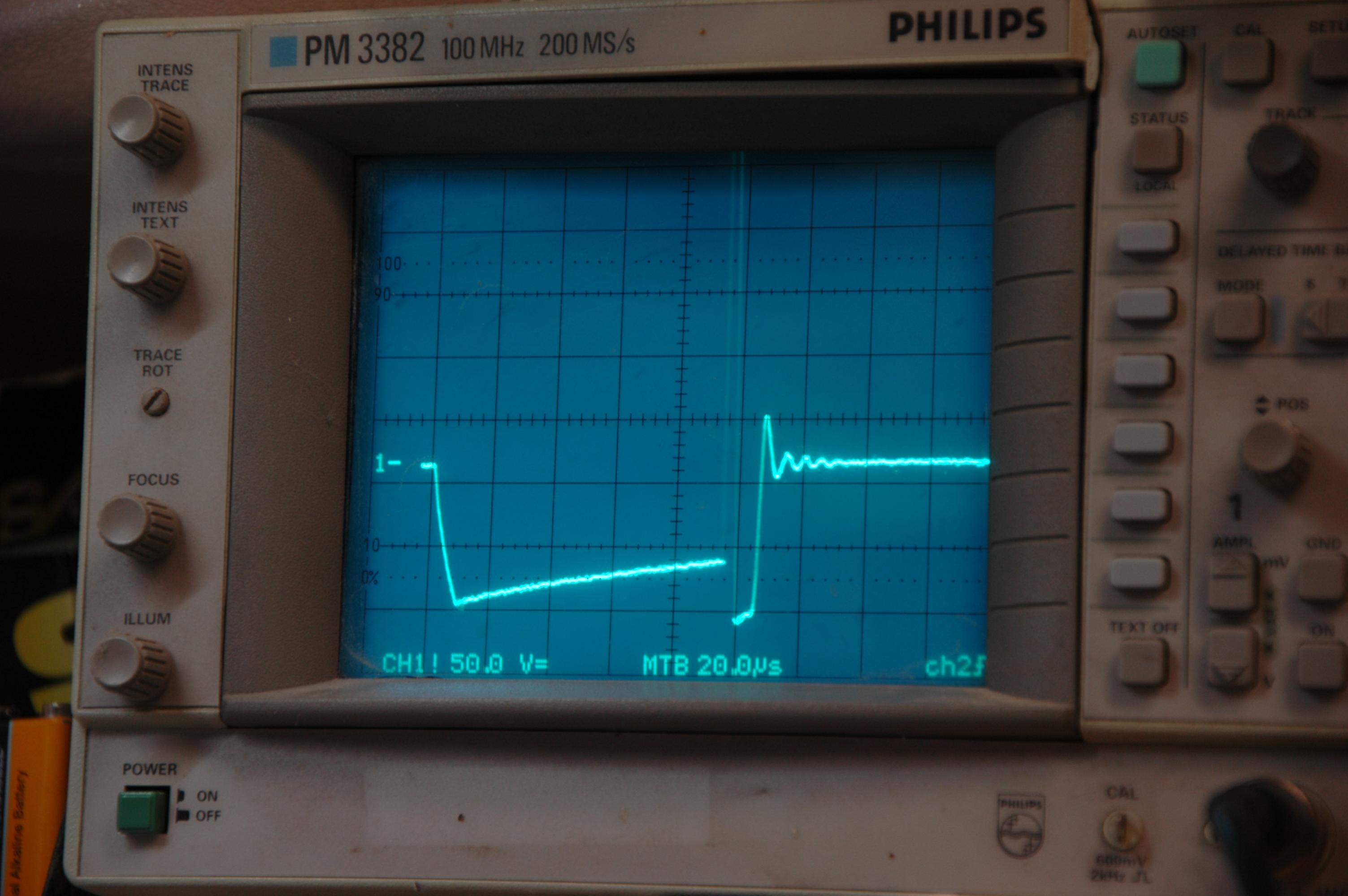

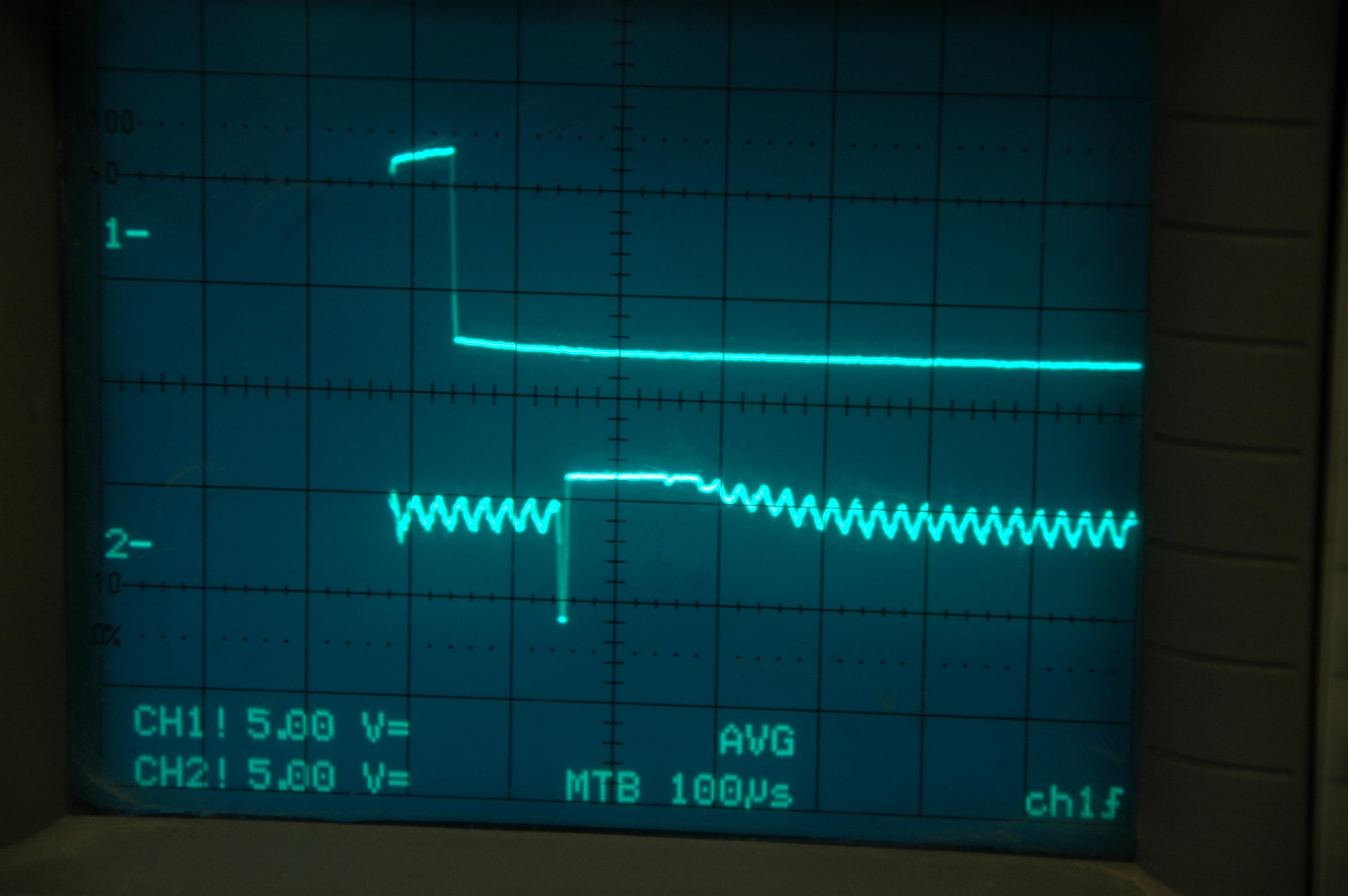

            • hi George, yes indeed my probe was 1: 1, tonight here is with 10: 1 probes. dc ..

              • Originally posted by lamoiz View Post
                [ATTACH]53855[/ATTACH][ATTACH]53856[/ATTACH][ATTACH]53857[/ATTACH][ATTACH]53858[/ATTACH]
                Looking at the images for Fig. 3-17 and Fig. 3-20, it looks like external noise to me. The scope images in the book were captured indoors, and (as you can see) the preamp output is relatively clean. The noise on your board is extremely bad.
                What do you see at the output of the preamp with the coil disconnected? Also try with only the damping resistor fitted (no coil).
                  ok George, yes I have a lot of noise I will immediately measure without a coil to see

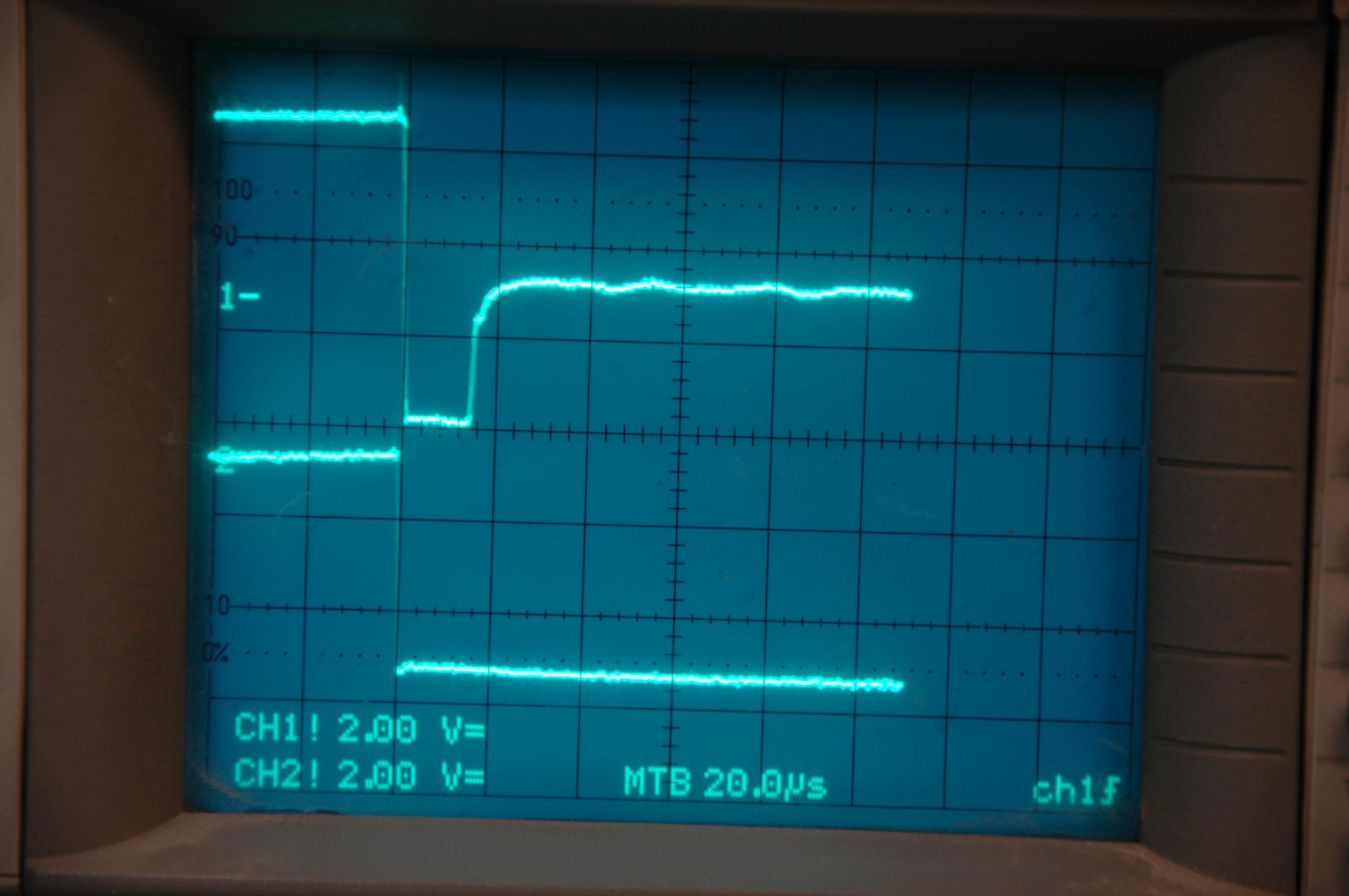

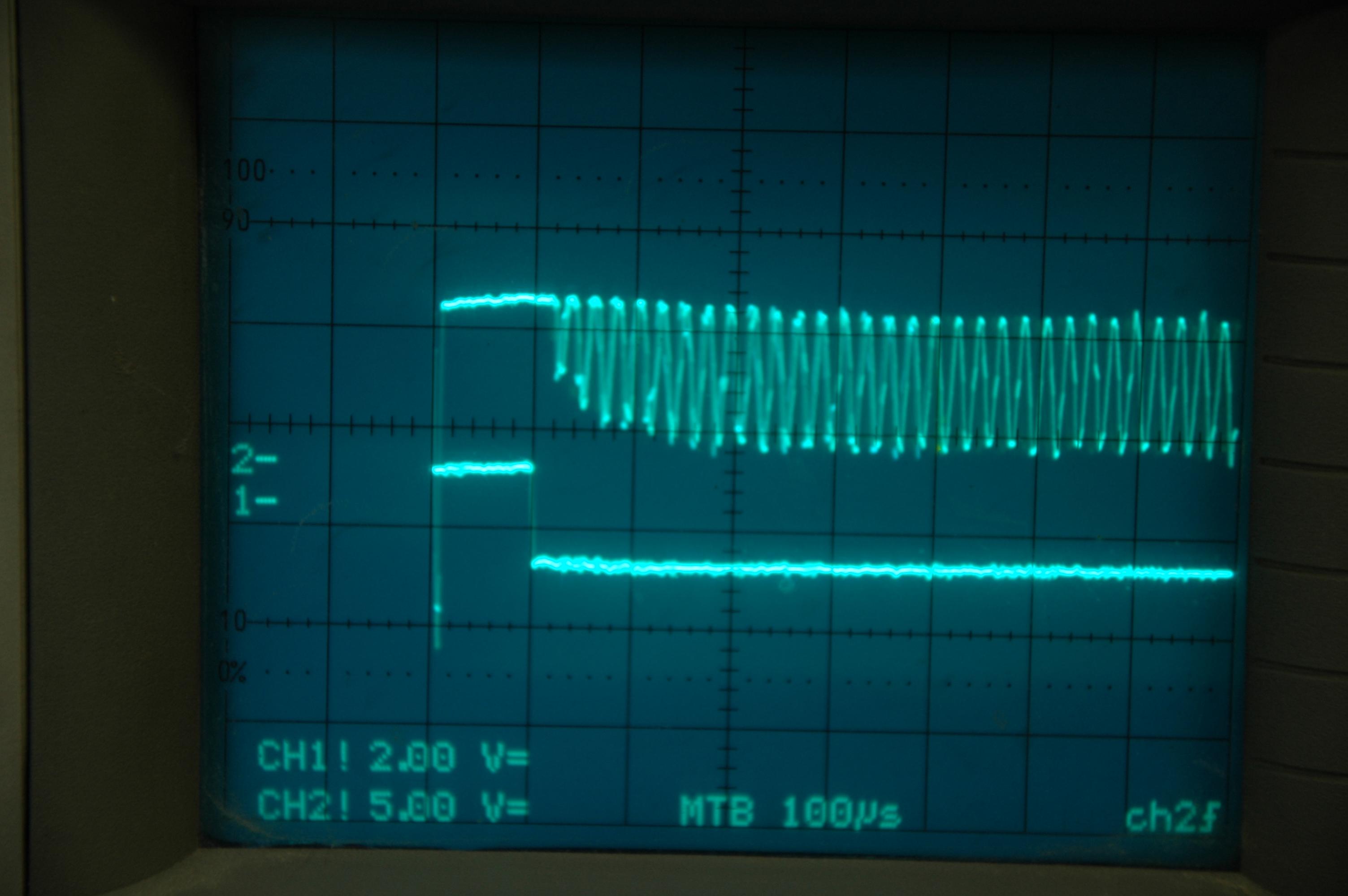

                    here are the horrors ...Click image for larger version

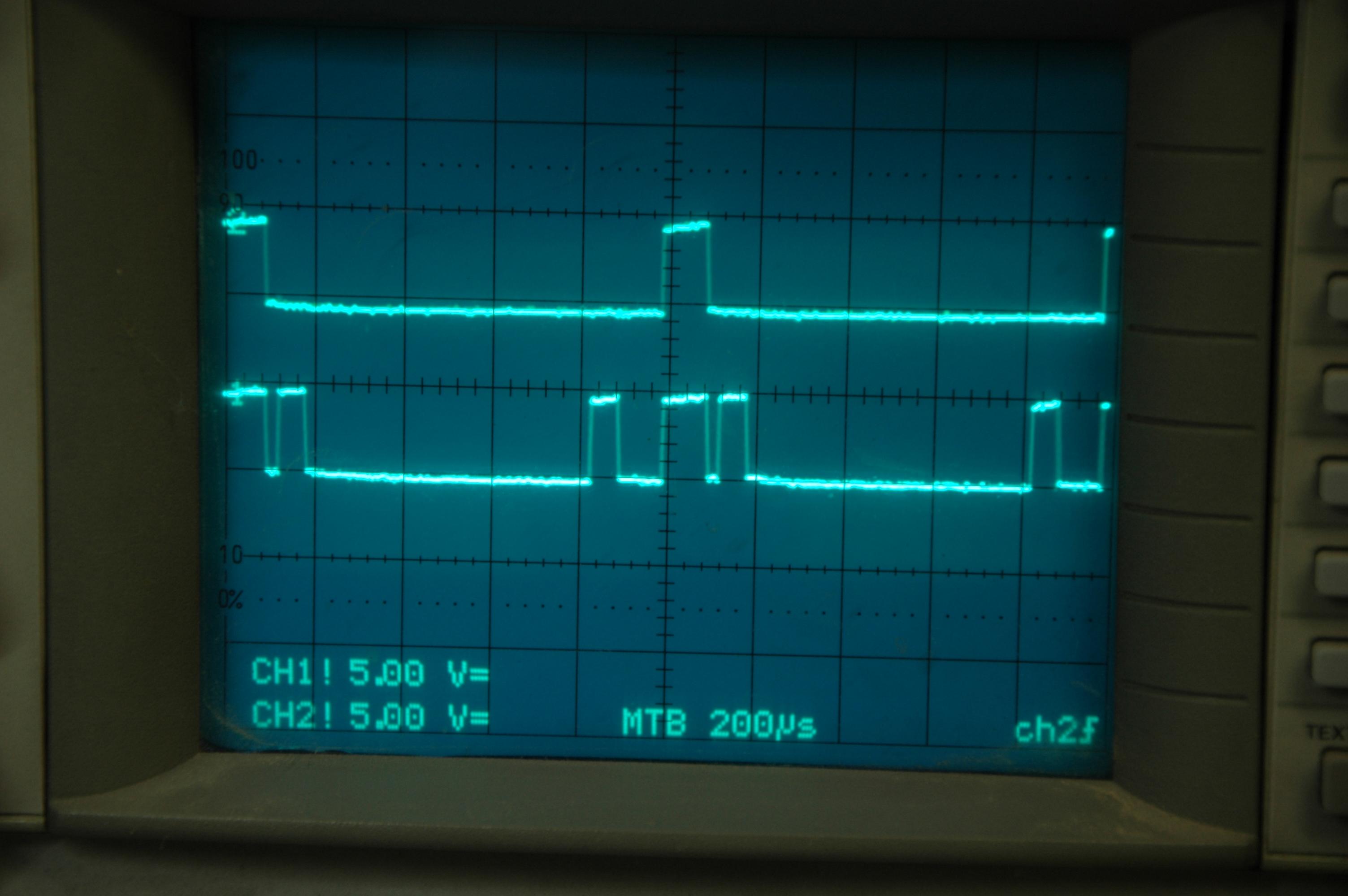

                      here are the horrors ...[ATTACH]53859[/ATTACH][ATTACH]53860[/ATTACH][ATTACH]53861[/ATTACH]
                      It looks like the oscillations are being generated on the PCB.
                      Can you post an image of the main and EFE sample pulses? They should switch between -5V and +5V.

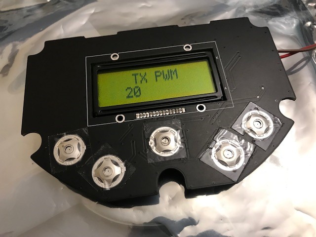

                              • For those interested;
                                Here is the HiTech C LCD library I modified slightly to use in a front panel I designed a little while ago.
                                Interfacing-LCD-with-PIC-Microcontroller-Hi-Tech-C (1).zip
                                You can modify it to use in XC8 as I have done to suit hardware in this project here;
                                PiPi_FP_Test.zip
                                Please note it is a test project, working but not optimised.
                                It is posted to help those who may wish to port George's code.
                                I also use the Mikro C Dongle Version Compiler from time to time so will build the hardware and use Mikro C first then do the port to XC8 later.
                                That way I know my way around the firmware and what it is doing rather than blindly porting it and having head scratching moments.
                                Well written book George, thank you for sharing.
                                Based on PIC16LF1829
                                Cheers
